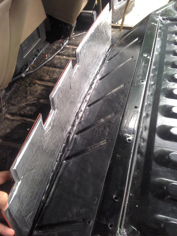

so those bits of silver are the protection and the orange is the bottom of your truck?
if so can't believe those help at all with all that uncovered space.
i tried to cover as much as possible even if i used a cheaper foil/glass solution. im very happy with my results (as Ive said). i can feel a very different temp where the steel/insulation is and where it is bare floor.
...and im gonna do it on the roof soon...mostly for heat.

They are not there for blocking, they are only there for damping. In other words killing resonances in the panels. Like I stated earlier, around 25% coverage is all you want/need for damping. I was just demonstrating how I tape it on for vertical surfaces so gravity won't tend to peel it off.
If I wanted blocking I'd use mass-loaded vinyl or thin sheets of lead. But that won't happen in this car as we're not wanting to add much weight. In your case, I'm sure the steel is heavy enough to provide very effective blocking, and the foil/glass is providing thermal benefits.
