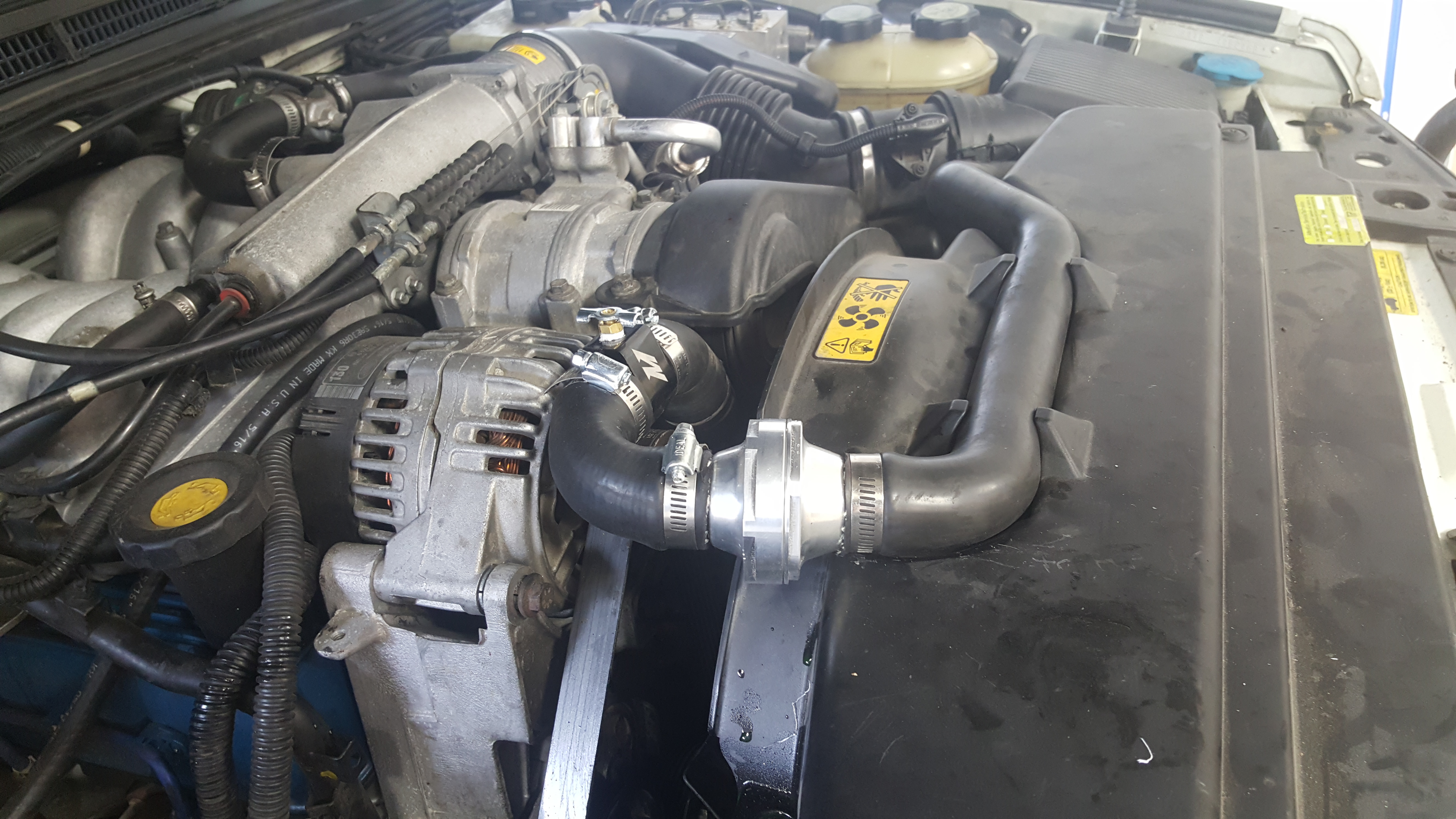

Finished the t Stat Modification today. Seems to be a very good mod so far. My temp gauge is showing much more stable Temps. Went out and did a little agro dirt road driving and the Temps stayed in the upper 180 to lower 190 range.
The only time it hit in the 200 range was idling in my shop while I was bleeding the system. It will get a better real world test when I drive the 45 minutes to Bend in the morning.
Also finished the installation of the rock sliders. That was more difficult as the fit wasn't all it could've been.
Despite the mild headaches and extra time, they turned out really cool.
I can post pic's of those later.

Very clean install, looks great. The only thing that I may do is switch the locations of where you have the Tstat housing and water temp sender adapter.
Old Apr 25, 2016 | 09:52 PM
blwngsket's Avatar
Joined: Apr 2016
Posts: 21
Was thinking the same thing. Get the t Stat as close to the motor as possible. The problem is the clearance between the alternator and the t stat housing. There's not much as it is with the smaller diameter bleed valve. That's due to the upper hose I used.
As is. My Temps on my Ultra Guage before mod bounced between 196.6 and 204 ish. With higher spikes
Driving today. Temps were between 185.6 and 190.6 with spikes to 196/197.
Outside temp mid day was 56 Fahrenheit. With zero warm up issues...... And the morning start up temperature was 37 Fahrenheit.
I'll take that all day.
