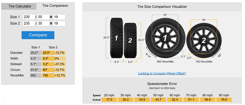

Can I put 235/35/19 tires on my 2008 land rover lr2 which usually takes 235/55/19?
Old Jan 19, 2017 | 05:09 PM
OverRover's Avatar
Posts: 2,514
Likes: 656
They would fit & look funny as hell (see the math ). I hope you aren't planning to go anywhere near off road with 3.2" of sidewall. Your speedometer will also need to be recalibrated. So "can you fit?" yes, but maybe the more important question is "should you?"... IMHO> No. Good Luck!
