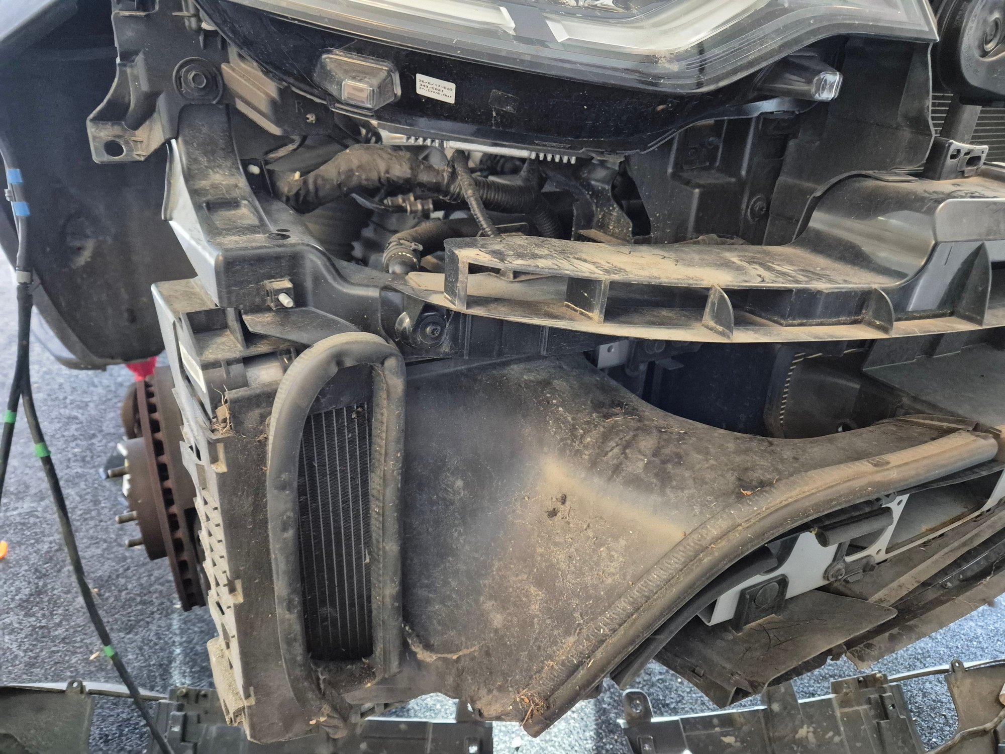

I took the bumper off my 2017 HSE Lux Disco 5 hoping to find a plug for the ACC radar. No such luck

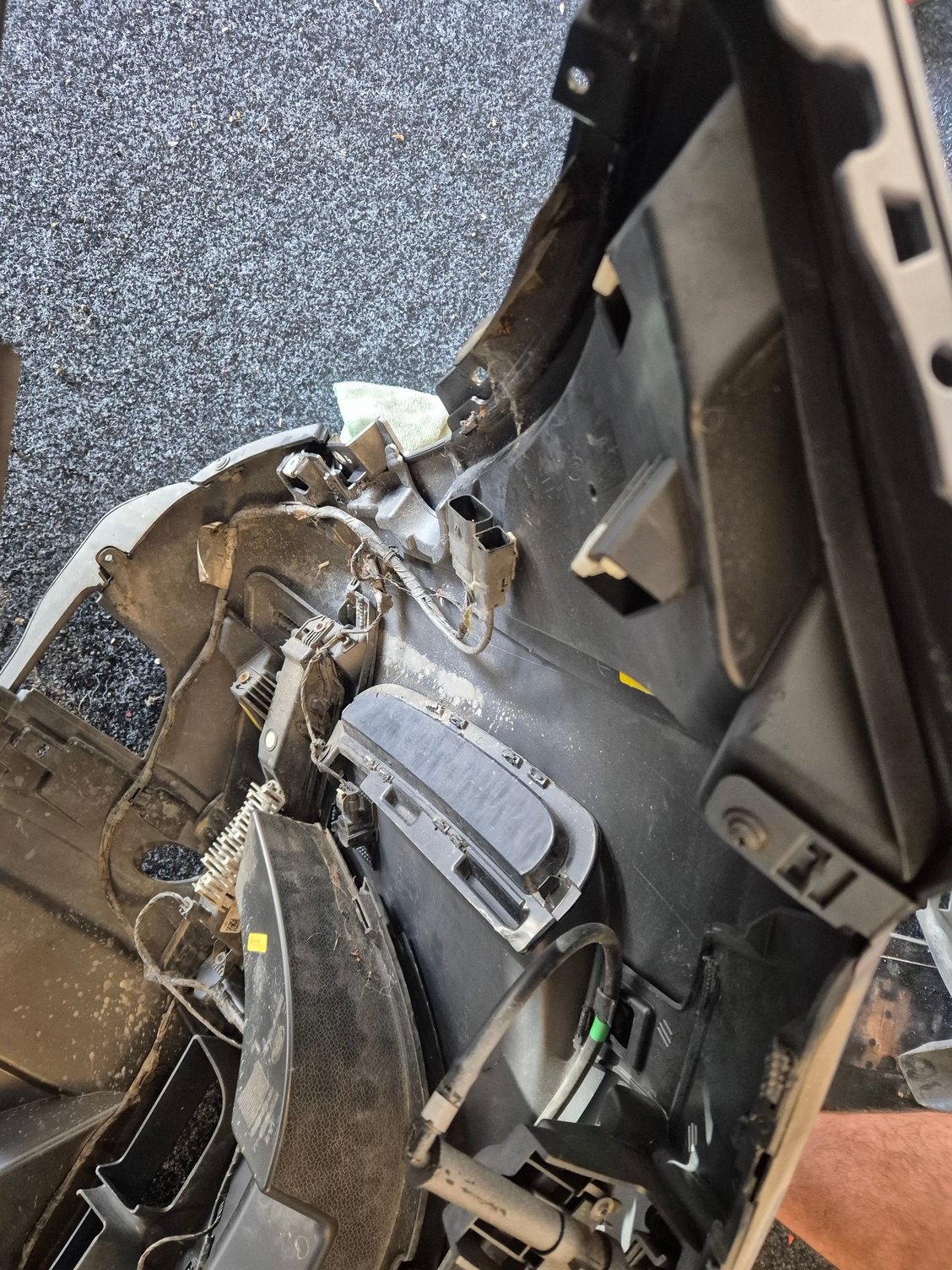

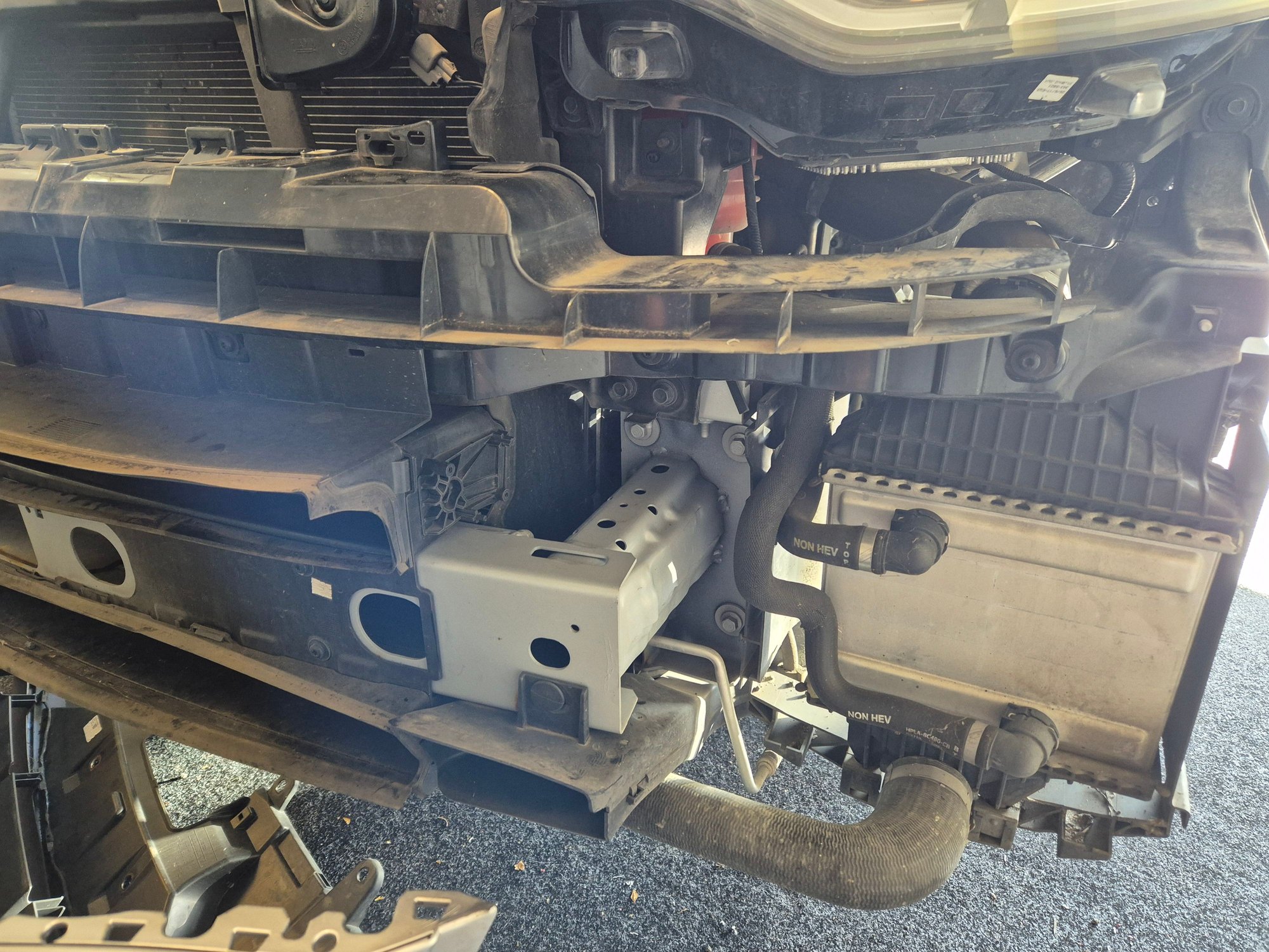

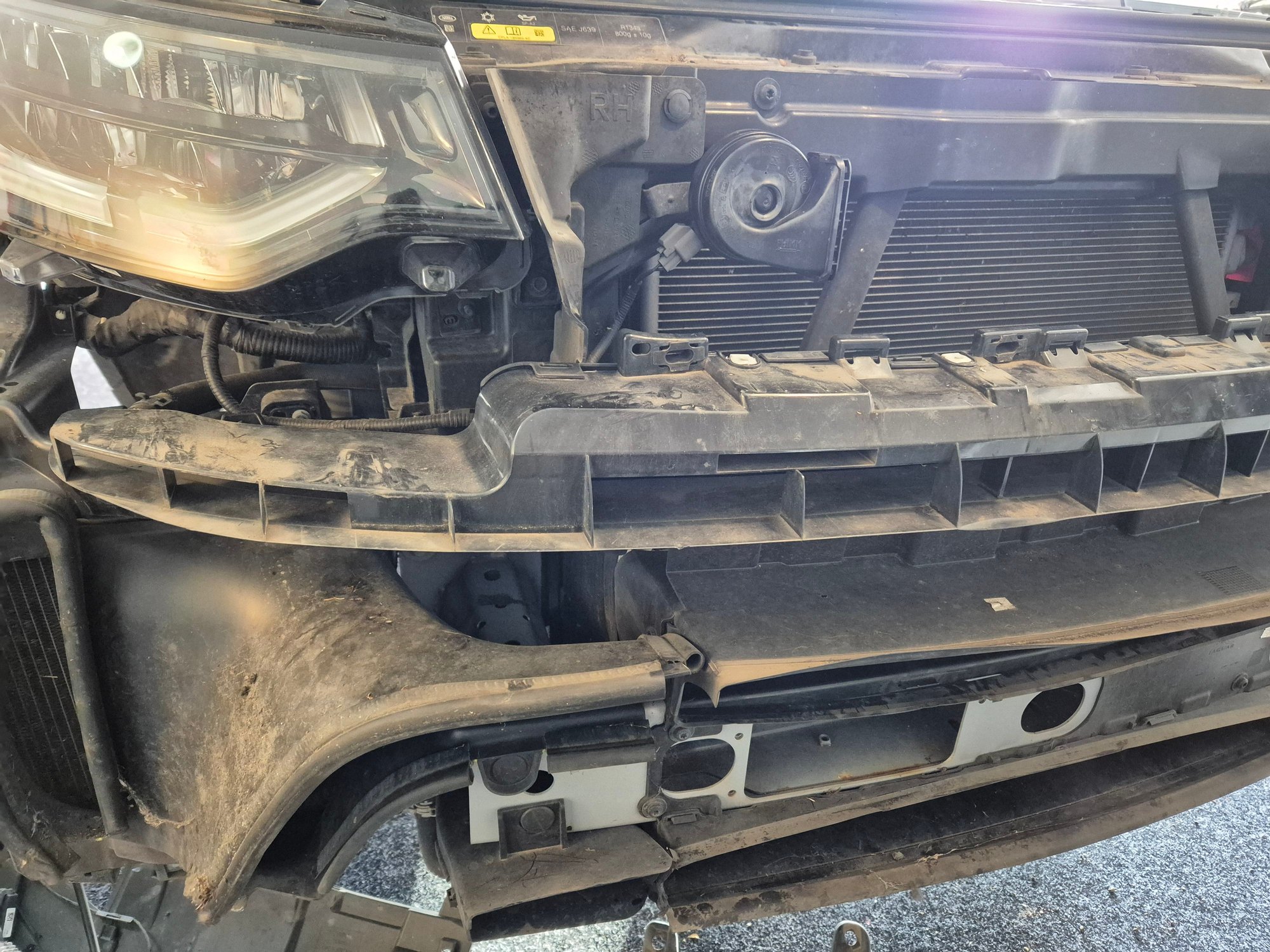

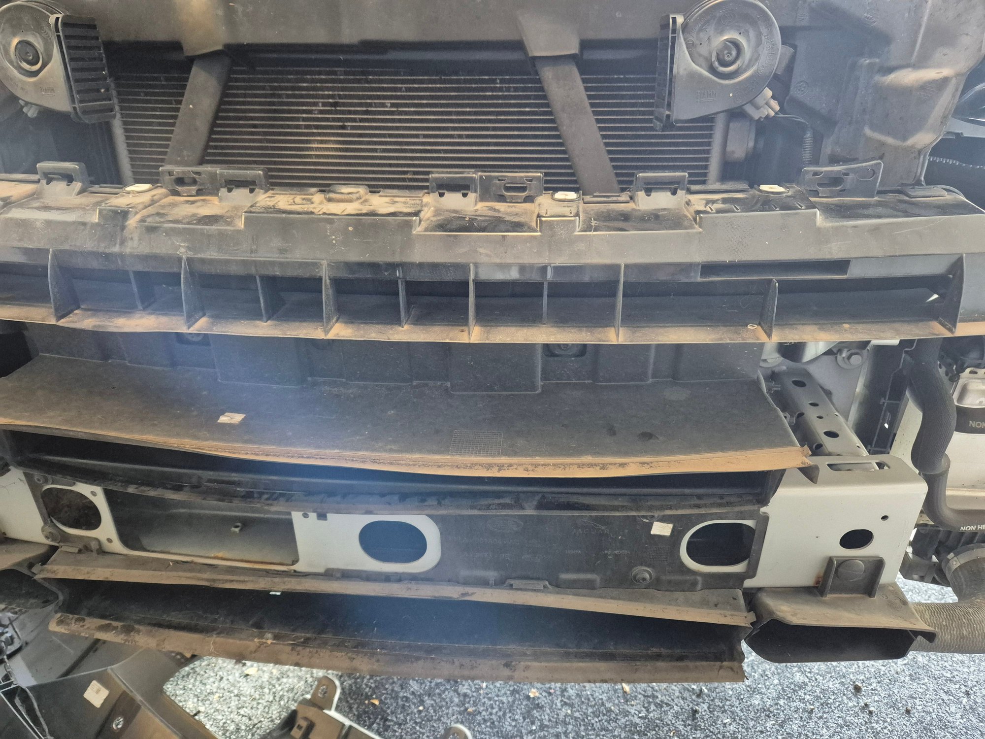

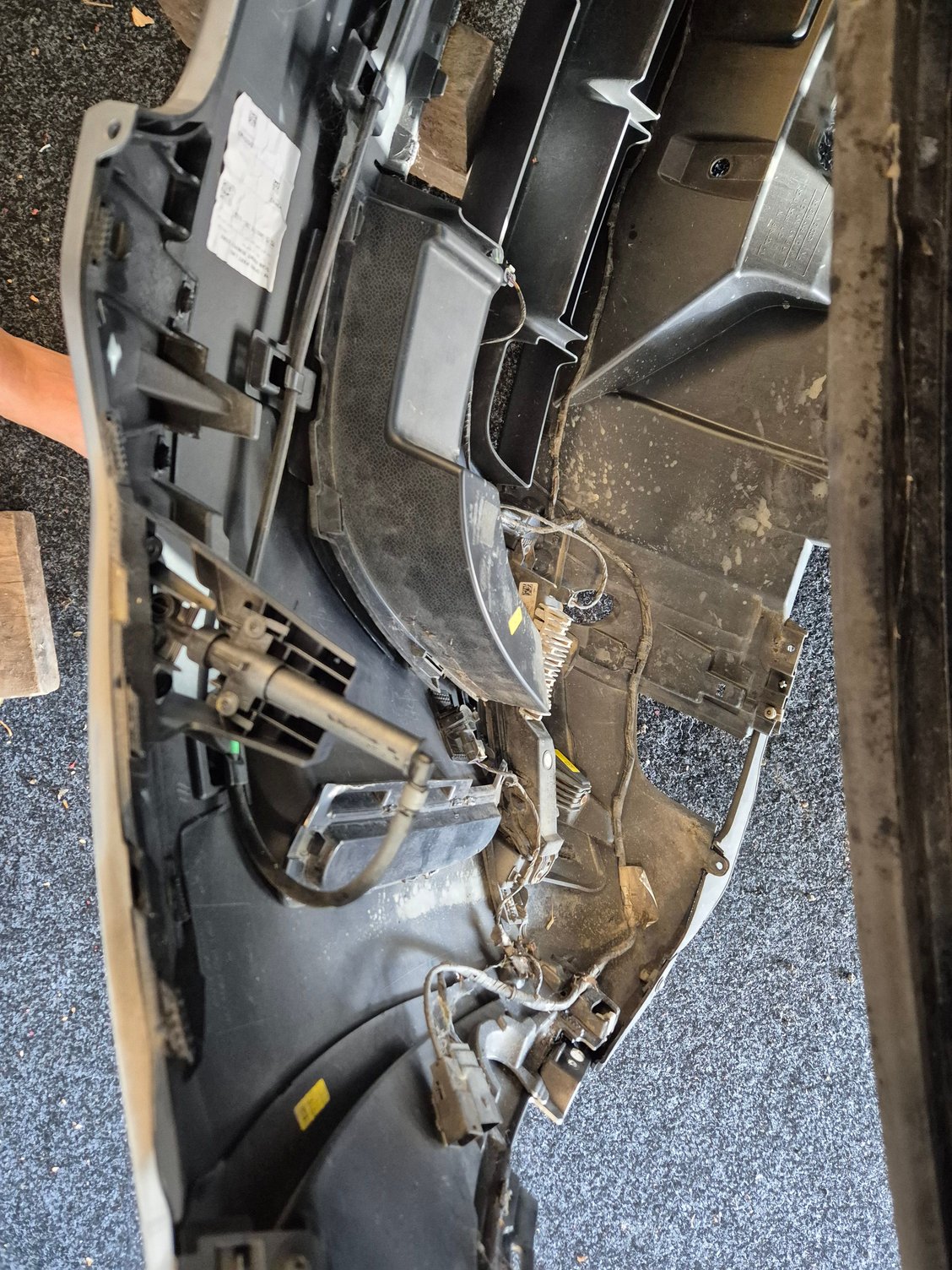

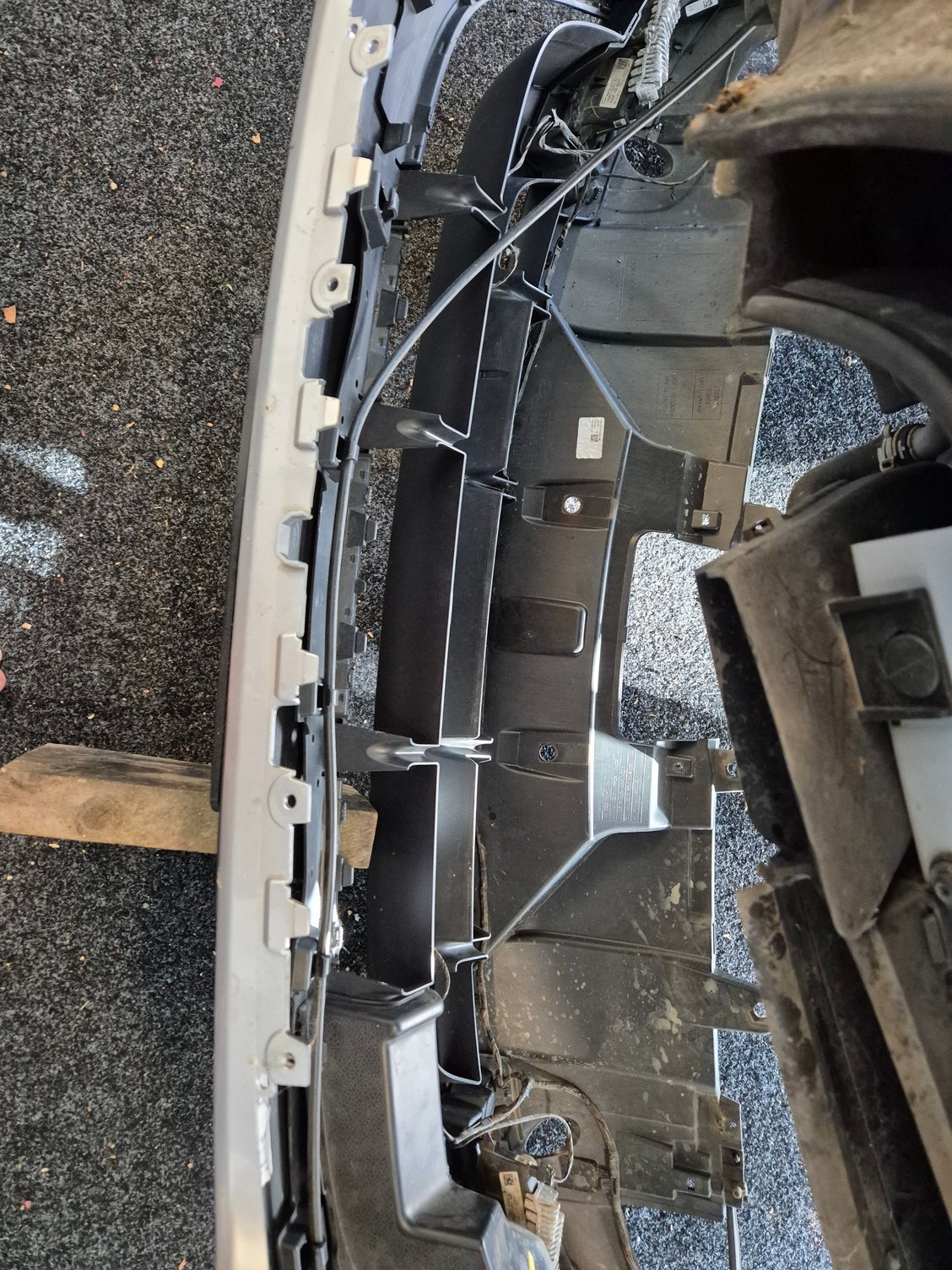

Old Apr 13, 2025 | 07:47 AM
jaccob.lik's Avatar
5th Gear
Joined: Nov 2021
Posts: 5

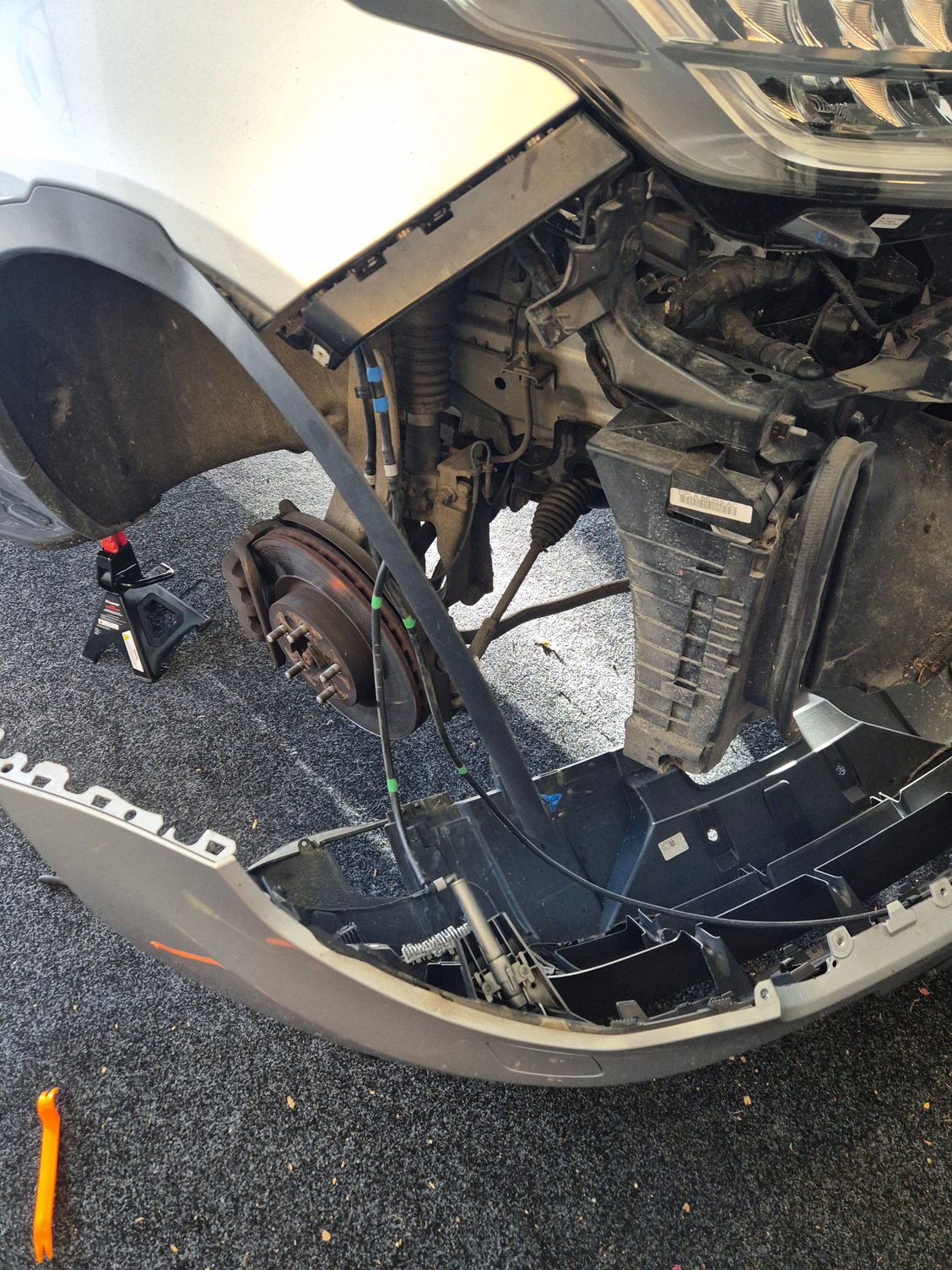

Hi, I'm taking the front bumper off next week. I need to replace the parking sensor. I'll see if the bundle's there. I looked up that the cable for the ACC is part of the cable for the parking sensors. You have to buy the whole harness depending on the number of pdc's equipped.
Old Apr 13, 2025 | 09:03 AM
Chucktastic's Avatar
Joined: Jan 2023
Posts: 220
Likes: 162
From: Alpharetta, GA
The harness for the parking sensors and front camera are one harness. The ACC harness is separate and stays attached to the front reinforcement beam when the bumper cover is removed. I suspect the ACC harness is part of the engine bay harness. I had looked a while back for a "repair" harness for the ACC, but never found anything. I'm not sure where the other end of it would even go.
