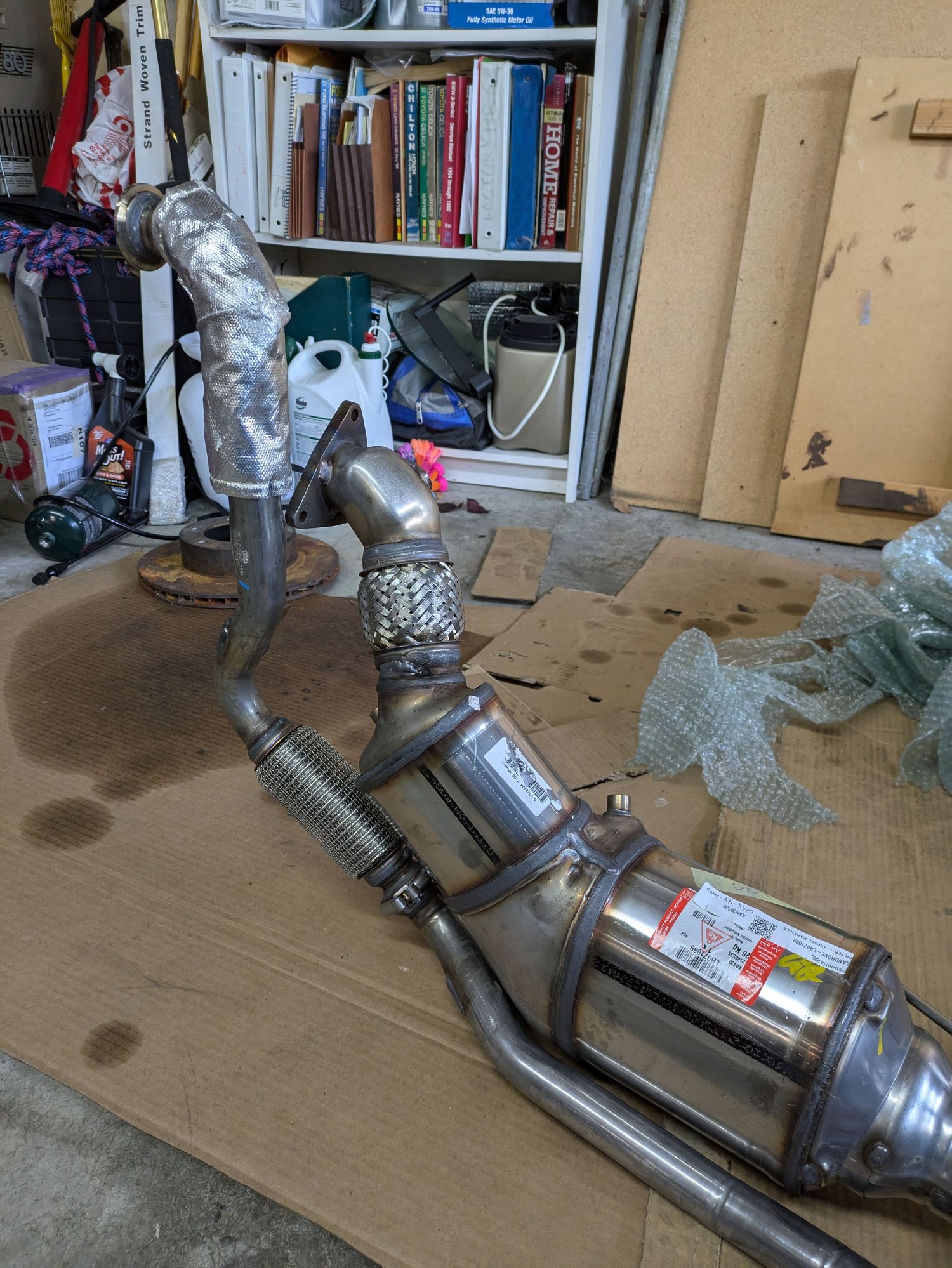

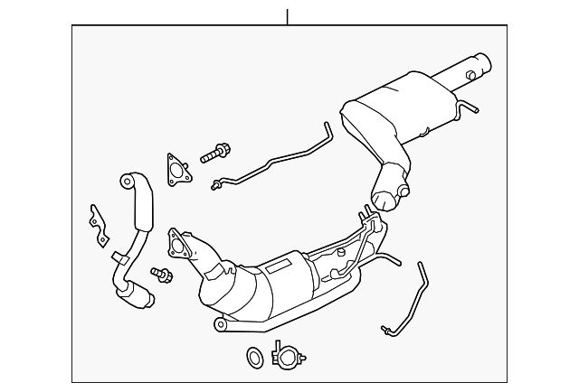

The diesel oxidation catalyst (DOC) is ahead of the DPF and they are integral. Dealer is probably referring to the catalytic converter aft of the DEF doser. Both can be bought independently or as an entire assembly, I bought the entire assembly as to not have to cut and clamp and I didn't want to mess with the catalytic converter again down the road

That's what I thought I remembered from reading the service manual. The pre-catalyst is integral to the DPF and *cannot* be replaced separately from the DPF. As such, It is integrated. The dealer should honor the warranty on the federally mandated emissions device. Escalate it to the EPA and to JLR corporate.
