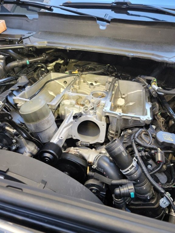

reduction pulley for the super charger on the Si6. Hands down that made a major improvement in the vehicle for me. Also the add on security camera was a great addition. Nice to have it recording even when the vehicle is parked and IF anything were to happen to it.

Quality superchargers carries the pully kit as well as rebuild kits and oil for our superchargers. I used their ebay storefront to find the kit but decided to just go for a full replacement after finding some play in the one on my vehicle.
https://www.ebay.com/itm/12443538131...mis&media=COPY
Edit: I did the install myself. It was not overly difficult but if you are not comfortable with tearing into the engine i would ask you favorite local indy shop.

Found the pulley here. 12% increase. Does it not require a computer update to leverage higher boost? Otherwise we are really just spinning the blower up sooner in the rpm range. Come from Audi too, and have under over over pulley with tune and that made a pretty significant improvement.
