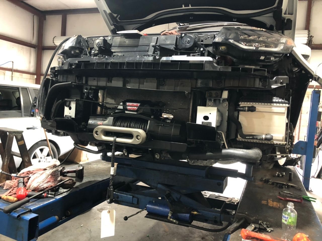

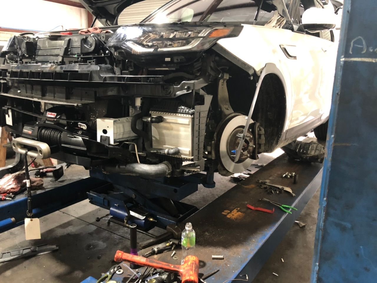

Here it is. You can also see the front light mounts in the pic. It was quite a procedure apparently. Too much of an undertaking for myself so I had a local shop do it. This was on the TD6 and required a bit of modifications.

That looks crazy invasive! I was hoping to do this myself. I’m not certain I’m that good. Mine is a Td6, too. What mods were needed?

How is having the winch directly in front of the radiator a good thing? It looks like it could almost be touching it. Only observing from the photos above.

It is very close but not touching, about an inch.
There was shimming of the tray, a different hole in the tray needed to be drill pressed, and the bumper needs to be cut into. The TD6 has piping where the gas version does not causing issues with the front passenger brake cooling vent. It is a difficult process and not one I was comfortable undertaking myself.
