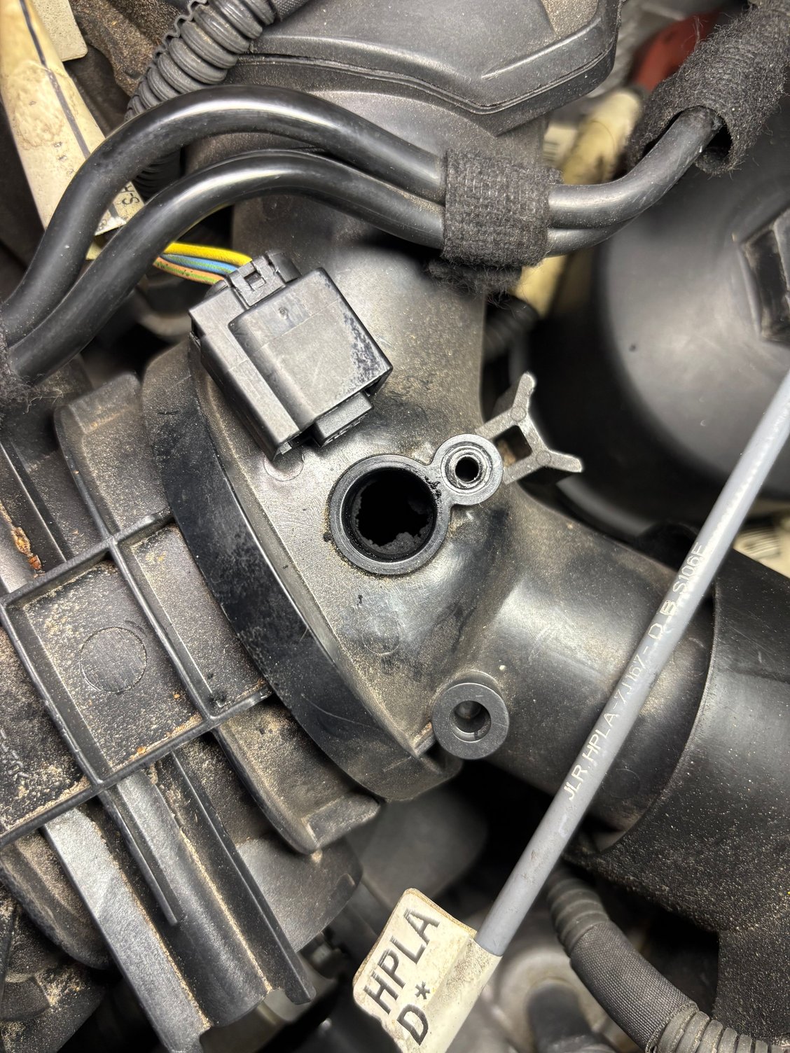

Any idea on what the MAP Sensor readout should be if it’s functioning properly? Mine was at 1.03V at idle. There has been a slight sweet smell, not coolant as I’ve been checking that like a crazy person. Is that potentially indicative of clogged DEF injector or filter? There was what looked like a lot of soot on the MAP Sensor when I cleaned it tonight. Attaching a photo of the inside as well.
Engine off and at idle the MAP psi should be roughly +/-14.7 psi, which is atmospheric pressure at sea level (no boost). At higher elevation it'll be lower. If your reading is in that ballpark I'd move on from the MAP. Mine has been "clogged" to the point of noticable driveability changes until after cleaning. I wouldn't suspect the DPF being clogged there would be other codes associated with inefficiency etc. Cold idle you'll smell an odd smell especially long idle which is normal.

Thanks! Mine was reading at 14.1. Great information!
