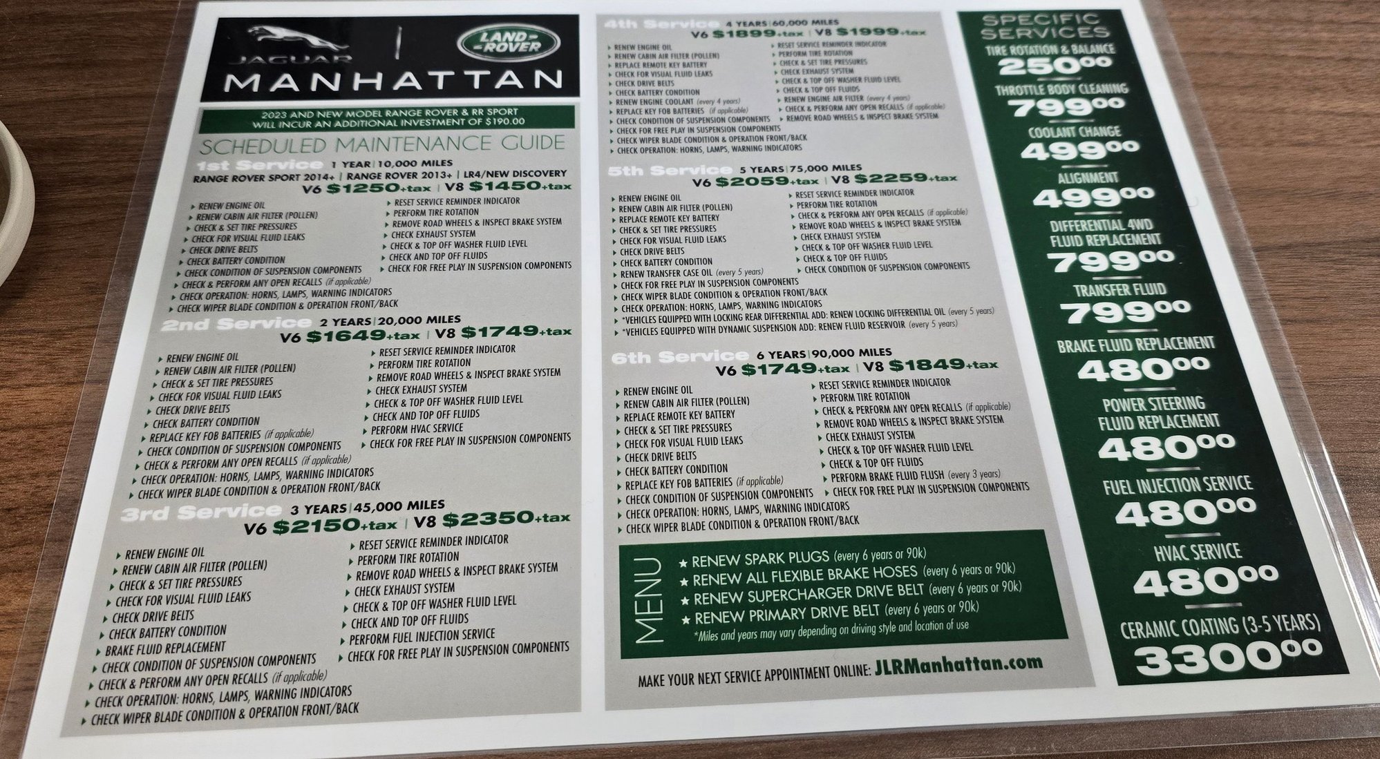

Thanks. I can do some of the minor stuff myself but very limited living in Manhattan. Time and space are a premium. Anyone recommend a NYC metro independent shop?
And I know it's Manhattan but jeeezz.
For $1250 they change your oil and cabin filter. And check everything else. You can check all those things yourself. And replace a cabin filter in minutes with no tools. Plus really, do you need a cabin filter change?
And for an additional $400 in year 2 they change your key fob batteries and service your HVAC system. I wonder what that service means. Do they spray air freshener on it? Or maybe they turn it on and see if it blows hot and cold. Just saying you could do without those expensive maintenance packages and do what matters.
