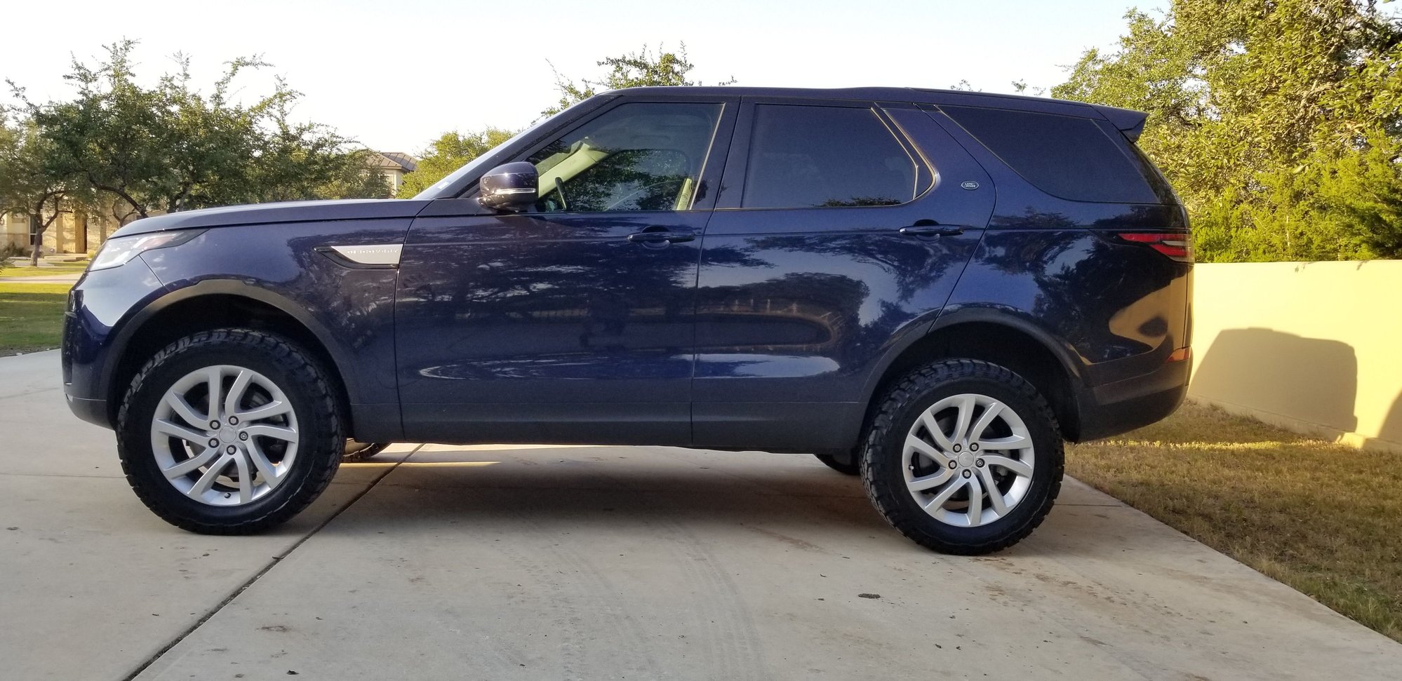

275-55-20 Duratracs with our 1.5 inch Johnson Rod lift
