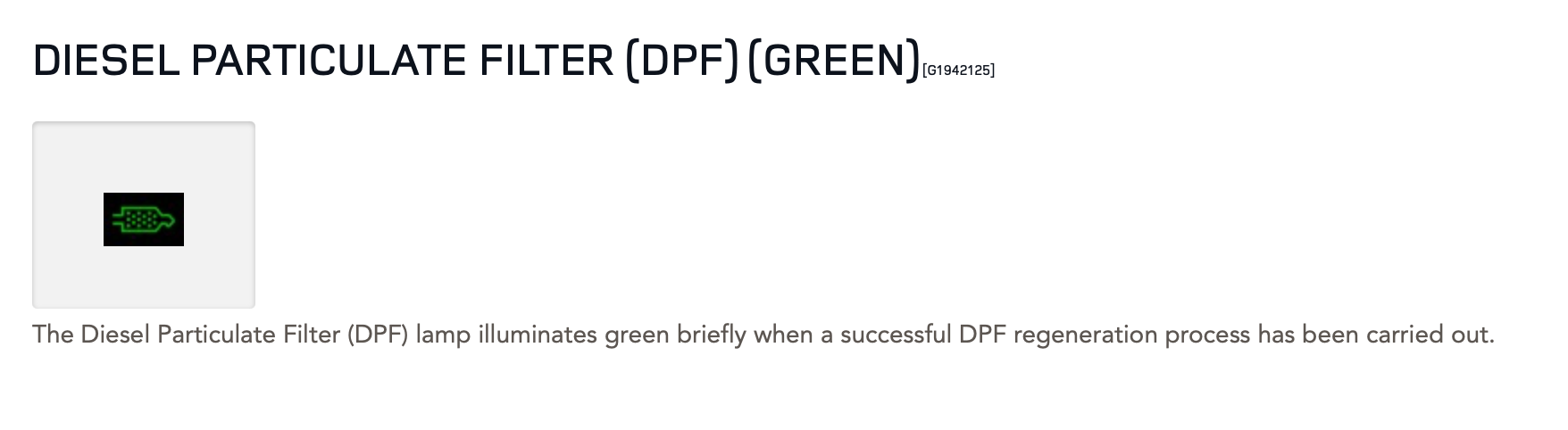

Im dealing with an engine issue on my 2018 Land Rover discovery TDV6 and without going into all the details on this thread, I'm curious what lights come on the dash related to the DPF regen. From the manual, a green icon would say a cycle was completed and red would say it didn't complete or there is an issue with the system.
I have never once seeing any lights related to the DPF illuminate and not sure if this is normal behavior or not.

Thanks for all the replies. Here is what the manual shows so I think that is why I'm confused. It essentially has a light for any possible state yet I've never seen one.

The "green briefly light" must be new to 2018 model. my 2017 have never shown the green light.

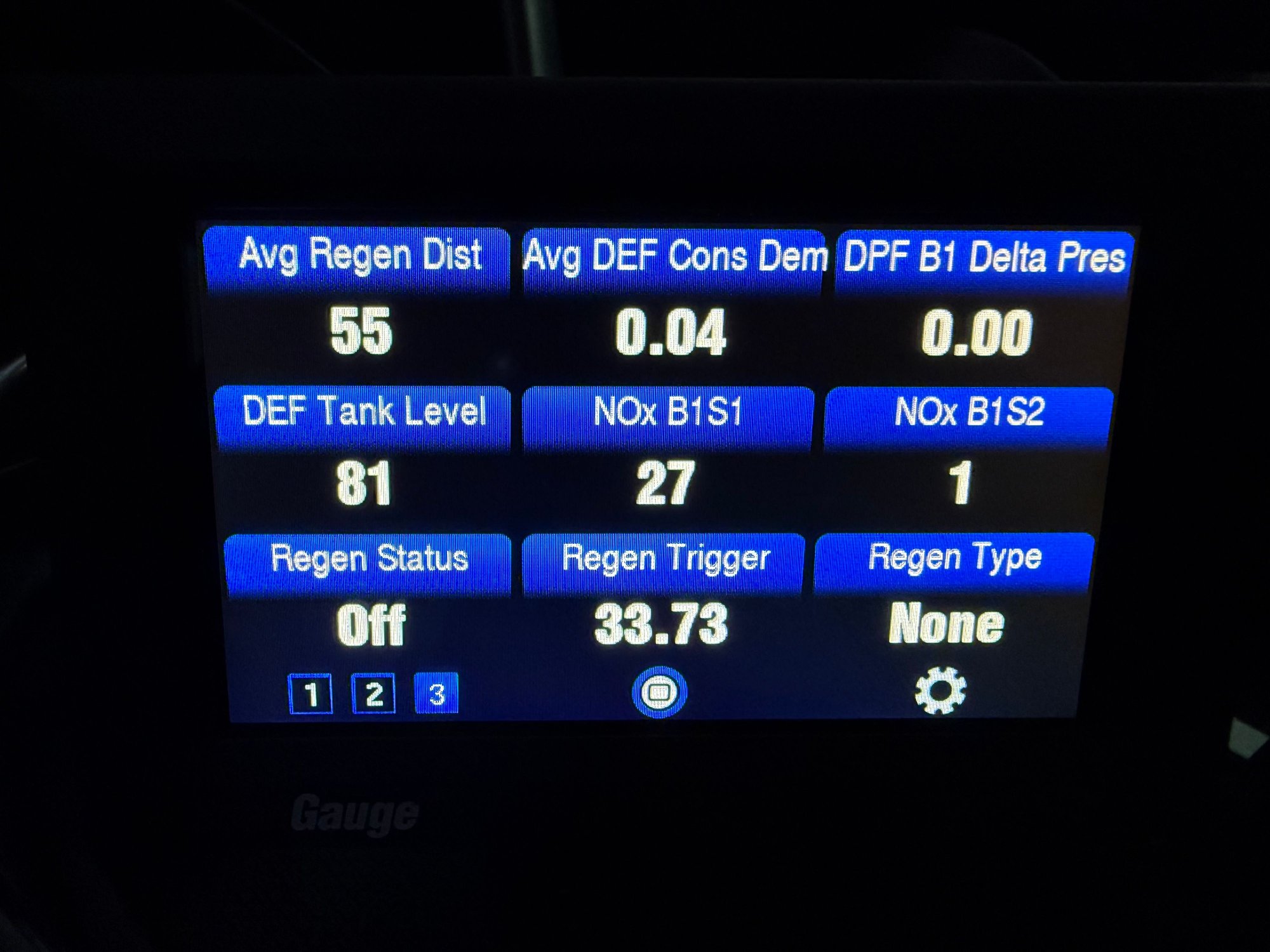

Scangauge3
Scangauge3
Best $200 expend.
I can see all!
