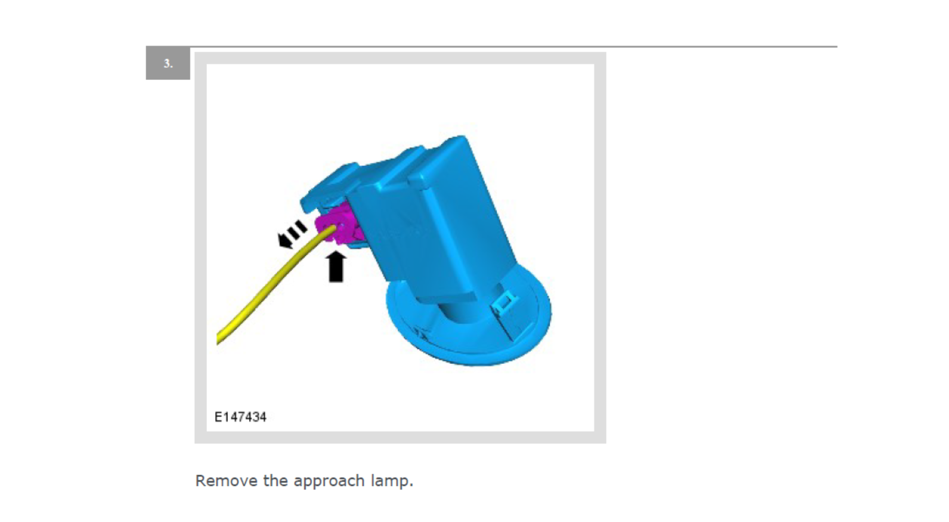

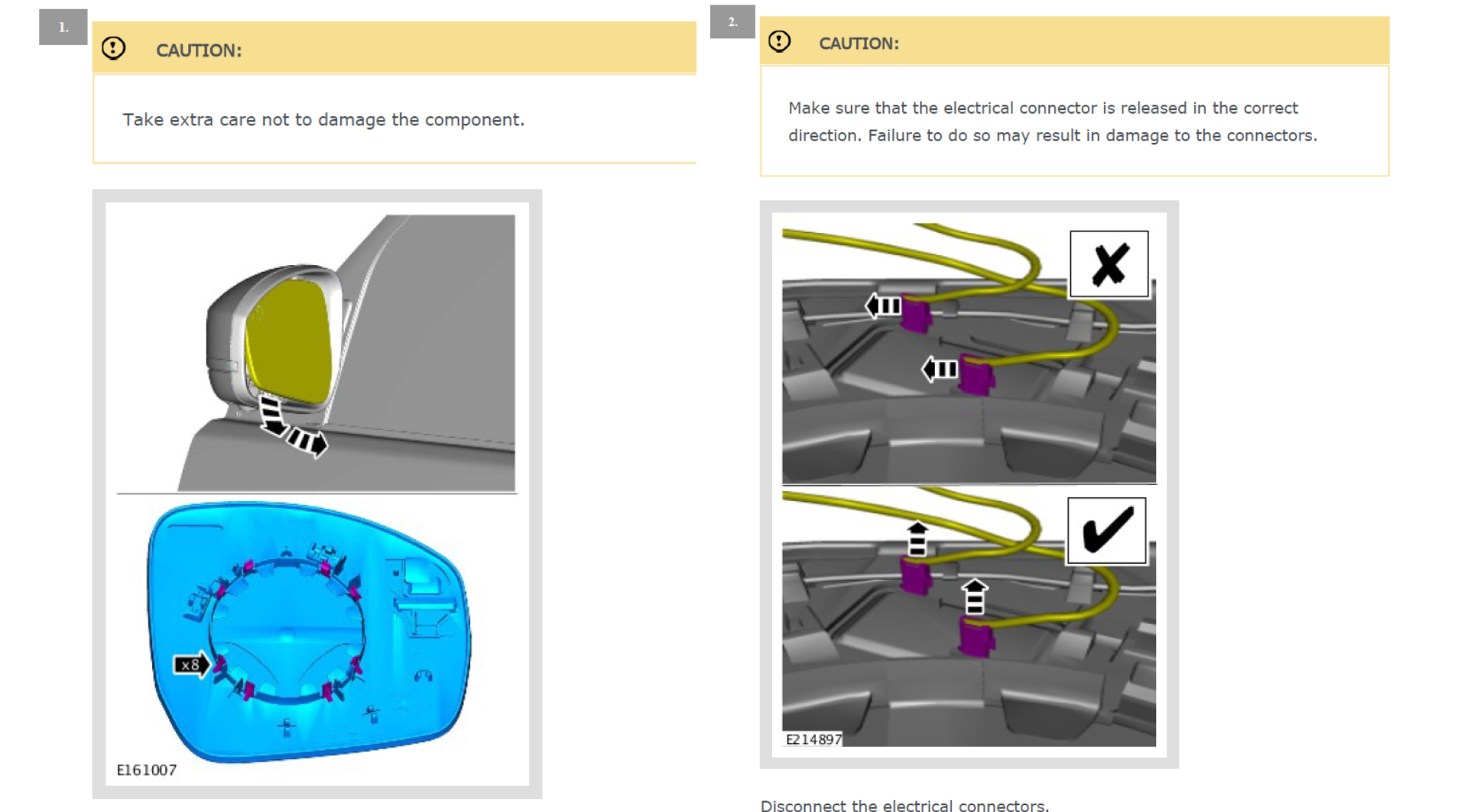

Hi All,
Apologies if there is already a post on here for this (i couldn't find it if there is) im new to the forum (this is my first post, but hopefully not my last). I recently purchased a 2022 LR Discovery 5 commercial. The driver side Puddle Lamp in the wingmirror is faulty. I found (and purchased) an original replacement part easily enough but i am struggling to find any documentation, videos or how to guides on how to replace the Puddle Lamp. Can anyone help or point me in the right direction.

This is from the 2017 workshop manual but should not be different.

Thanks Juancl this is exactly what i needed. Took me 5 mins to replace.
