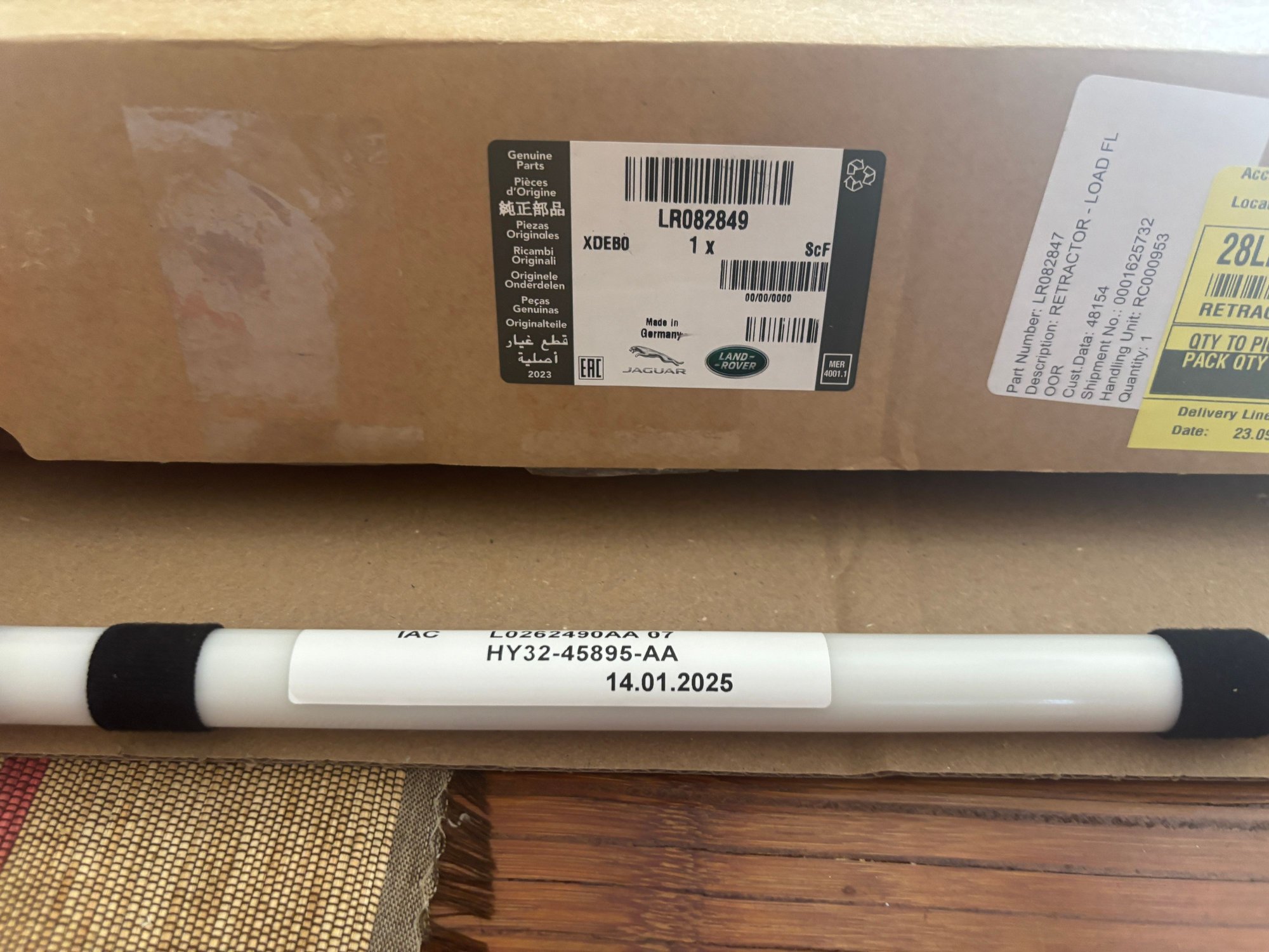

Repair was effected using a replacement new unit which cost $172.

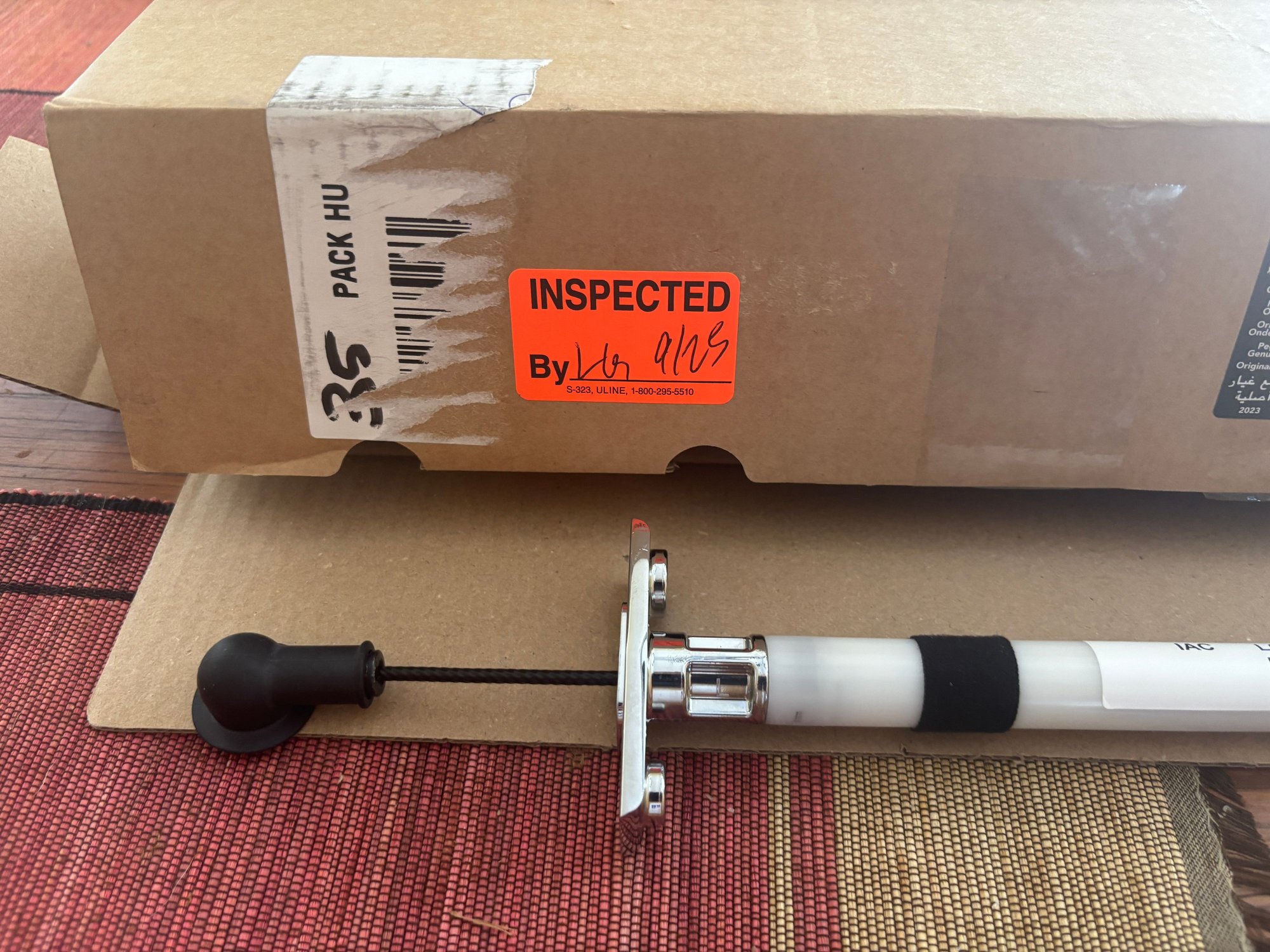

It’s very easy to fit. Just slide the rubber boot back and disconnect the cable from the wall, after first removing the clip. Then take out the 2x fasteners and slide the whole unit out of the tailgate.
The plastic seath on mine had pieces jammed in the unit and cable wouldn’t retract anymore. If I were you I’d trim the torn section off the cable and keep using it if the cosmetics don’t bother you.

Please provide a photo of the replacement part or the old one you removed. Does it just come with cables or the motor too or that entire piece that screws to the edge of the tailgate? Thanks.
Here's the only other picture I have. The unit is a white tube with the chrome fitting for mounting to the inner tailgate. There's a self-retracting cable inside it, which comes out when the tailgate is lowered. THERE IS NO MOTOR.

Thank you, So now I wonder what pulls the cable in or lets it out when I push the electrical switch.
IIRC there's a spring inside the tube
