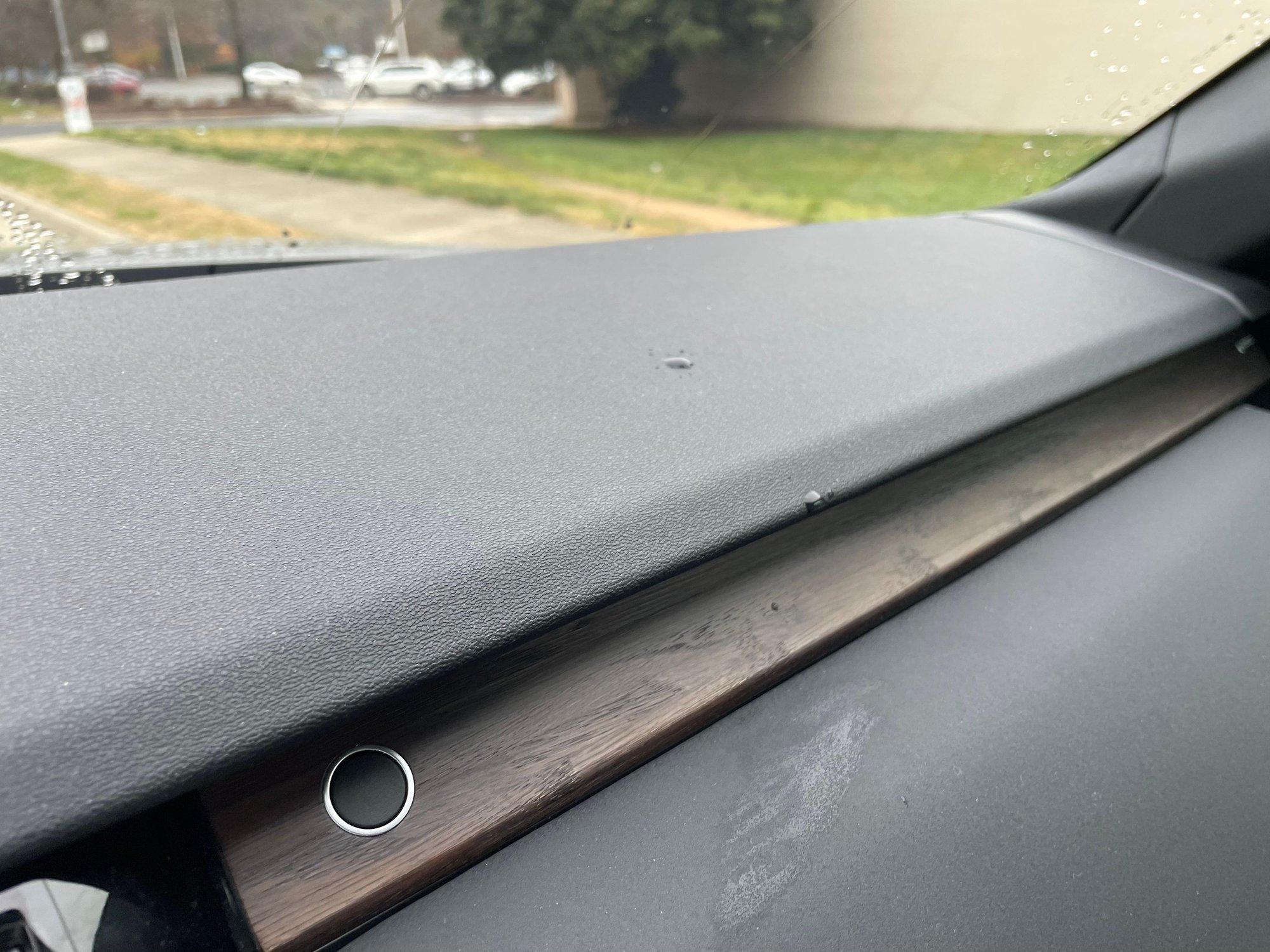

I thought that I'm going to be fine, but had water drops on my dash this morning after the car was outside all night.
Dealer is checking into availability right now, but stated that the windshield will be replaced. My D5 is from 2018 and has 40K on it. So better now as still under warranty.

That's what I was told too. They ordered the windshield after I sent them the picture explaining that this can only be fixed by replacing the windshield, since it mostly likely will break when removed.
