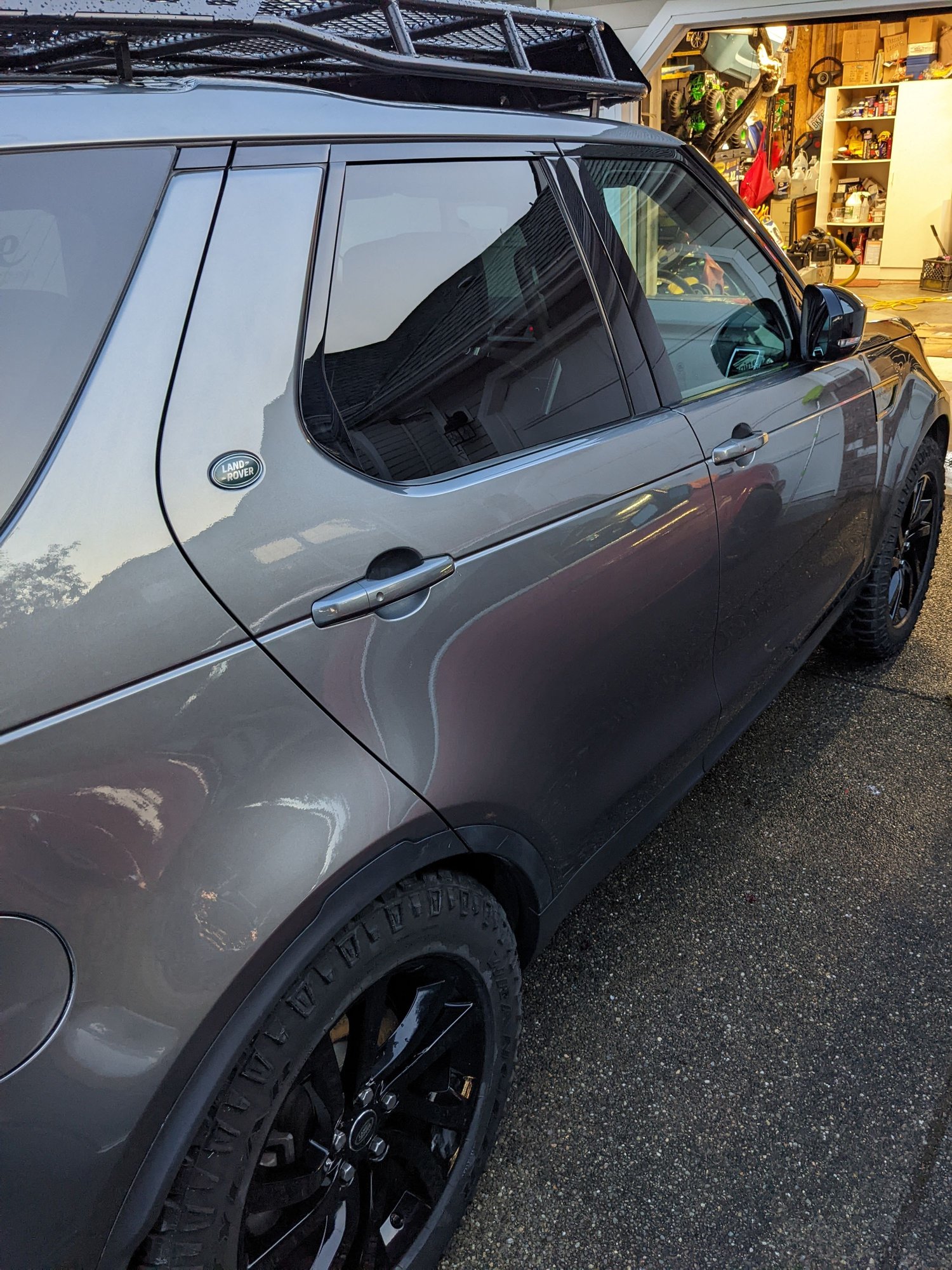

All surface stuff. Good as new after a Polish. Not trying to pretend these things are going to be collectors items ever. I assume use them.

please note, if your car is black and not silver, white or gray, your car will absolutely NOT polish out the way this one did.

Desert pinstripes. They buff out!

did you buff it yourself or take it to a pro I got the same pinstripes on mine but significantly less and mines is blue

I did it myself with a high speed polisher.

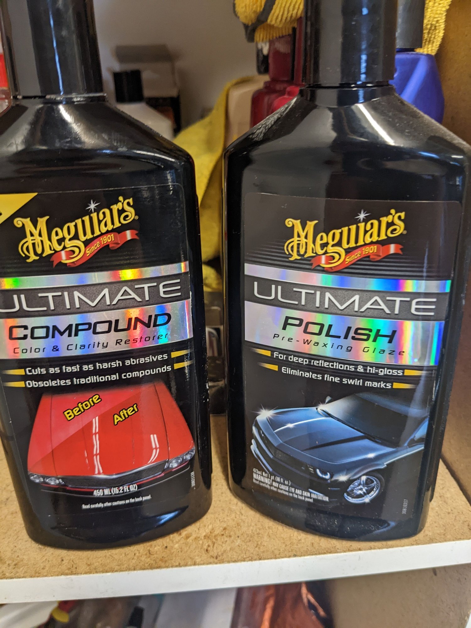

may I ask what stuff you used compound and polisher looking to do it myself.

I used my old harbor freight polisher with an 8" foam pad. Meguirars compound then polish. Took a couple pads to do the whole thing. Then waxed it. Used meguirars plastic polish for the trim and mirrors with a different foam pad, worked very well.

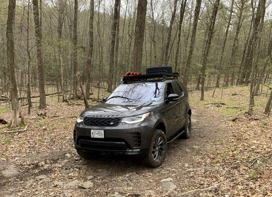

nice 22 discovery havent seen much of those even on the road glad to see your using it right6
