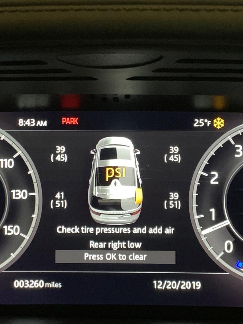

Hi All. It's cold up here in the Northeast section of the United Since, and it figures that on the first day of winter I am getting low tire pressure warnings--see image below. I know tire pressures will drop when the ambient temperature is cold, but does anyone have any recommendations on what tire pressures to keep them at when it's cold outside? Should I keep the the PSI 2 or 3 levels below the recommended pressures--knowing that when the temperatures / tires warm up, the pressure can increase by up to 4-6 PSI? And it is best to add air before the vehicle is driven (before tires have a chance to heat up)? I appreciate any recommendations, and not sure if this topic has been covered before. Thanks for the advice.

Lookup light load pressure setting. If you carry 4 passengers or so you can use that setting.
I have never changed the pressure setting based on ambient temps, as the tires will still be colder when you drive compared to a hot 100F day.

Agree with andries...I always use the light load settings found in your menu on the gauges panel. I leave 34 in all of them. Rides nice and still handles great.

I prefer 36-38 front and 38-40 rear with the light load setting. I only bump it up to normal load pressures when we carry 6/7 or load it up with 4 and lots of luggage/dog, etc. I found the ride much nicer with the lighter load pressures on a daily basis, as it normally has 1-4 people in it.

Tyres are supposed to be filled when cold. That’s what the ratings refer to. They have already taken into account that their pressure will increase slightly when driven.
I agree with the previous commenters, use the light load warning setting and put a few PSU over that. Typically I add 4psi.
Too much and the ride gets harsher (as the rude absorbs a lot of bumps) and you may het higher wear in the center of the tyre although you would get slightly improved fuel economy. On a cost and comfort basis I prefer the lower pressure.

Since it is Boyle's Law working: what is the tire pressure once you have driven ten miles or so. If it warms up to normal, might want to leave it alone for ride quality issues noted above.
On my current car, I try to run 35 front, 36 rear once warmed up giving -- to my feel -- best ride and handling balance for the Michelins. Book calls for 33 all around. In the cold, 30* or so, it drops to 31, in the summer, maybe 36* when 'cold.' So I add some air at first frost, and dump some first day over 80*
