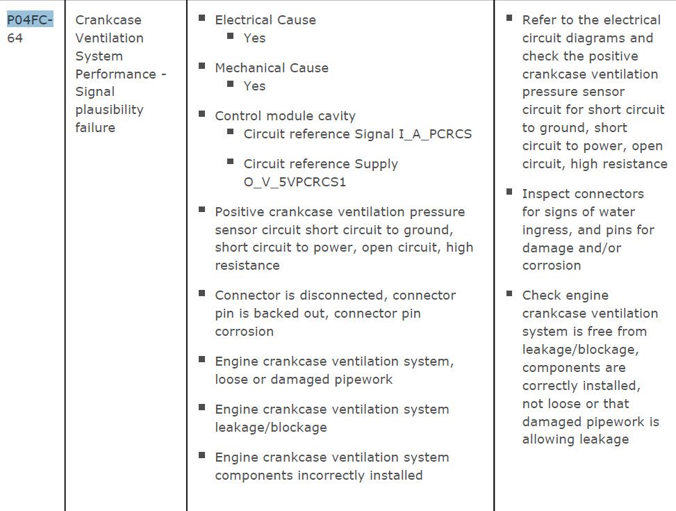

does anyone have images or diagrams of the pcv system can’t find any for the life of me. I just want to know if I’m looking at the right stuff.
Old Dec 11, 2025 | 05:15 AM
gmfain's Avatar
Joined: Feb 2015
Posts: 937
Likes: 545
From: Calhoun, GA. USA
maybe this will help
Old Dec 11, 2025 | 07:55 AM
LR disco 5's Avatar
Joined: Apr 2021
Posts: 341
Likes: 82
Exactly what i was looking for thank you so much. i will update after i check it today afternoon
