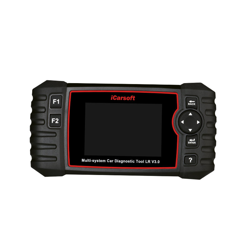

Ok great news... I reset the oil/service required message! I did it with my iCarsoft V3 for Land Rover tool. For anyone searching this topic my Range Rover is a 2020 NAS TD6 that refused to reset its service interval.
Now the comedy is two Land Rover Dealers failed to pull this off and my iCarsoft wouldn't do it either UNTIL I updated it today in a hail Mary attempt to resolve this. The new update enables quite a few service functions that were previously unsupported so if you buy this tool update it immediately prior to the first use. Another tip update it via a Windows PC or in my case Parallels on a Mac. The Mac updating tool doesn't work well and kept telling me that my devices information was a mis match.
I hope this helps someone else experiencing this issue.
