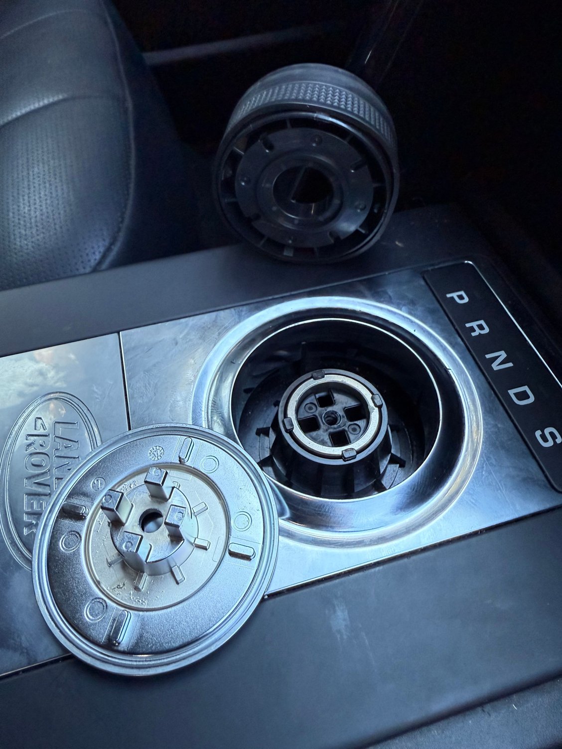

I pulled the **** off today to take a look at turns out it’s just the ****. Mine has a rubber grip around the side with a metal top. The rubber has expanded and isn’t tight fitting around the plastic housing to which it’s attached. Works great without that rubber in the way. Ordered a new metal one to replace and it will be working good again.

Here’s a better picture of it. You can also see the rubber that’s all warped and pulling away from the inner plastic structure.
