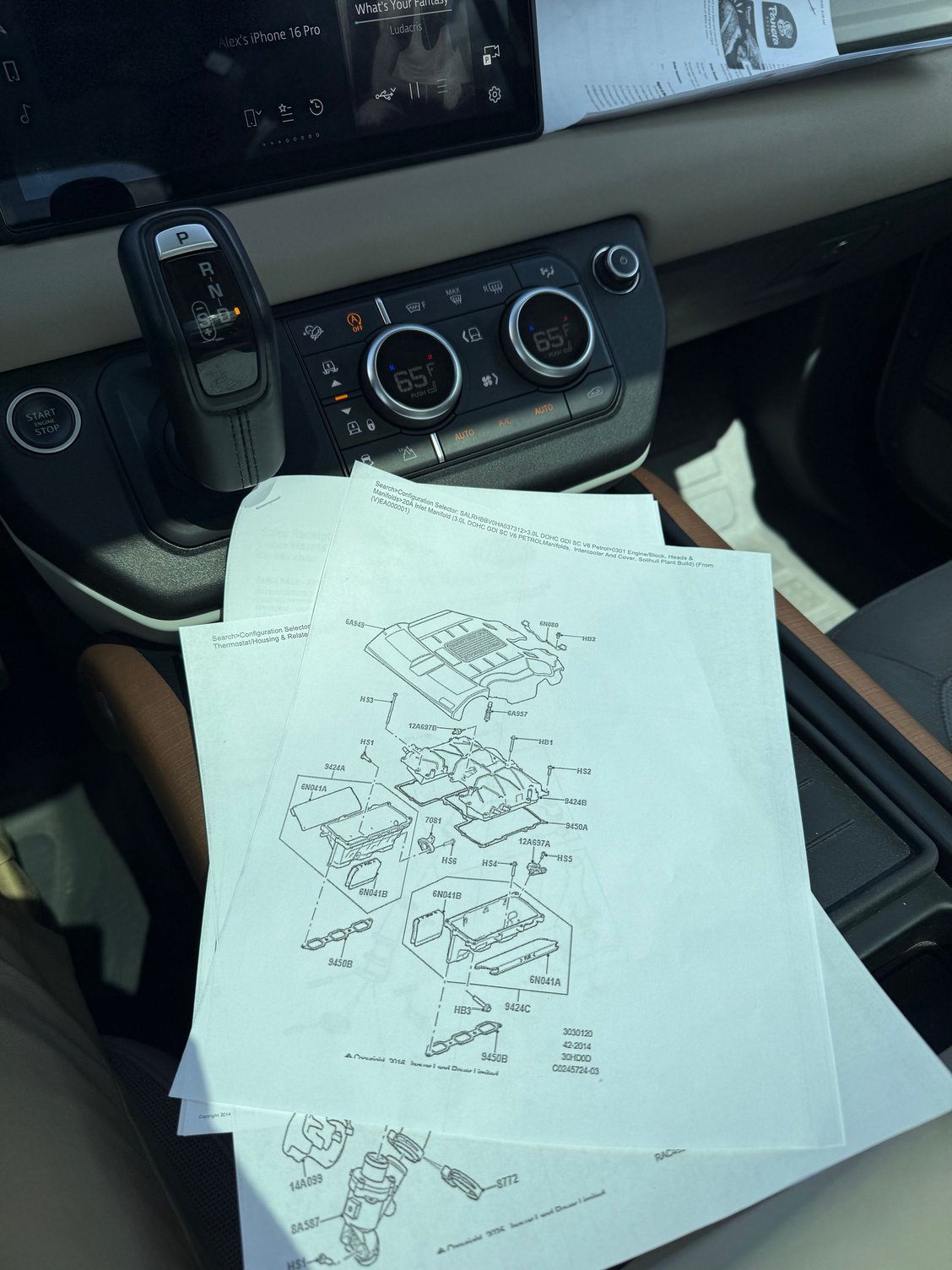

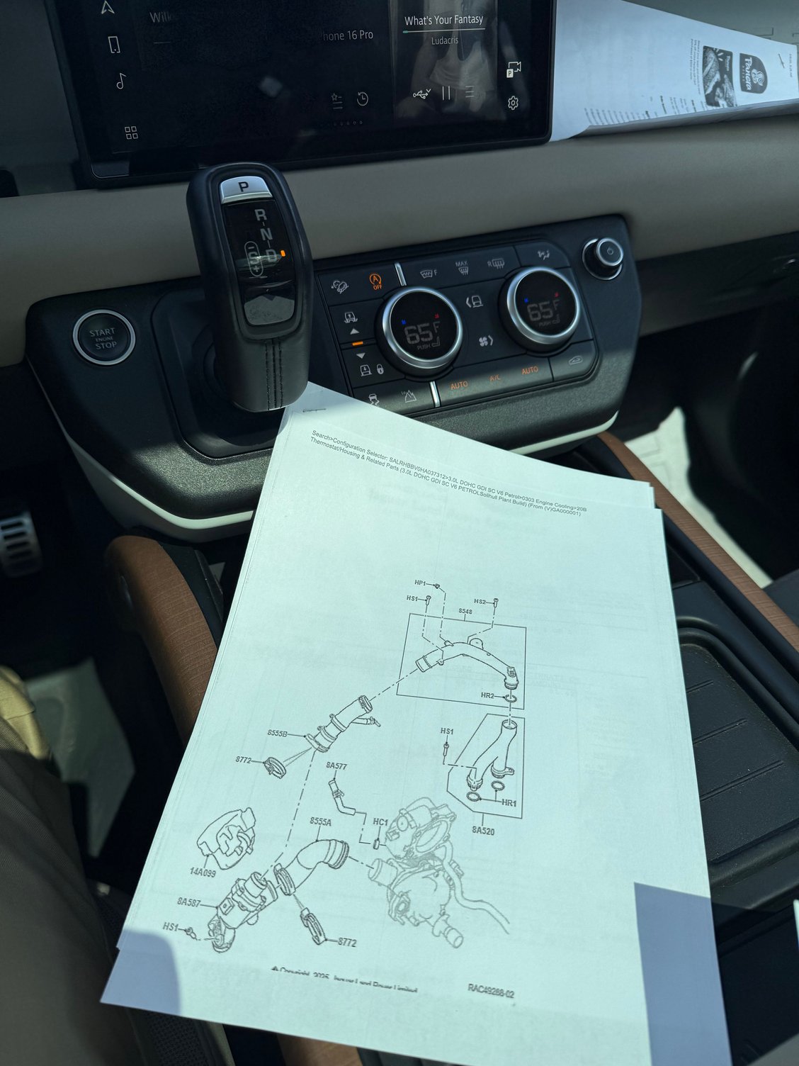

I'm hosting a cars & coffee event at my dealer tomorrow. I can ask my parts guy for a diagram if you want.
Sure that would be great. Thank you

Thanks for those 2 pictures.

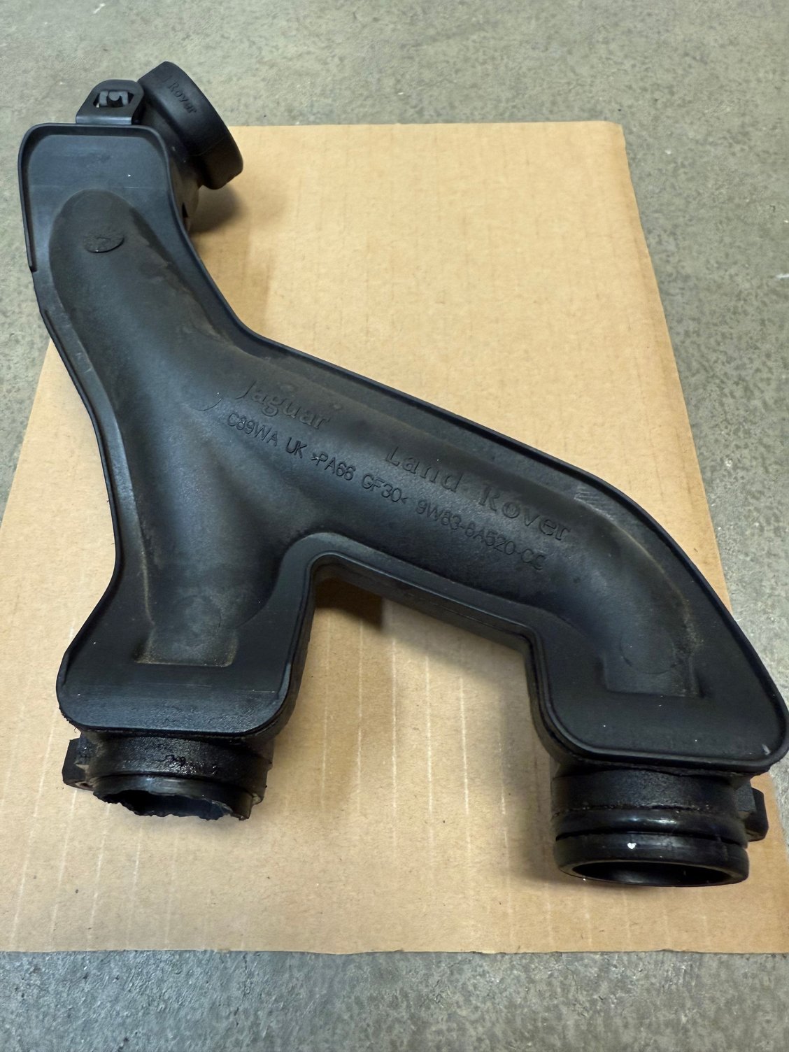

I decided to have the preventative work done by my independent shop in Denver. It’s quite a bit of work and I’m certain I could handle it but I was comfortable with this shop. All of the plastic pieces were replaced with the aftermarket aluminum ones. And LR o-rings were used in place of the aftermarket ones. Here’s a photo of one of the plastic parts that was removed. Mileage is 74k on a 2017 HSE. You can see that the plastic welds did not come apart but the left hand tube in the photo crumbled upon removal and was ready to self destruct. It was time for this preventative service.
