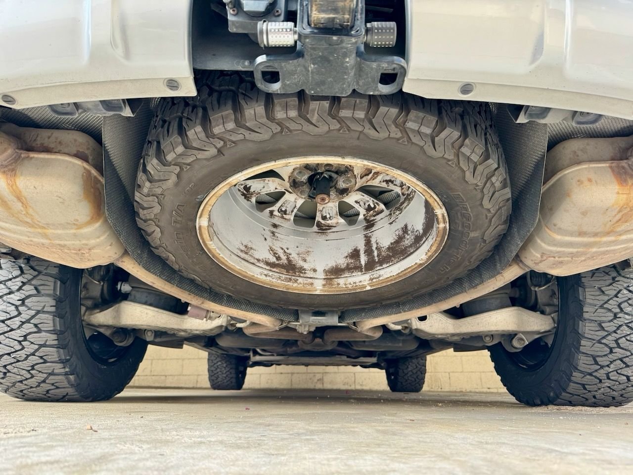

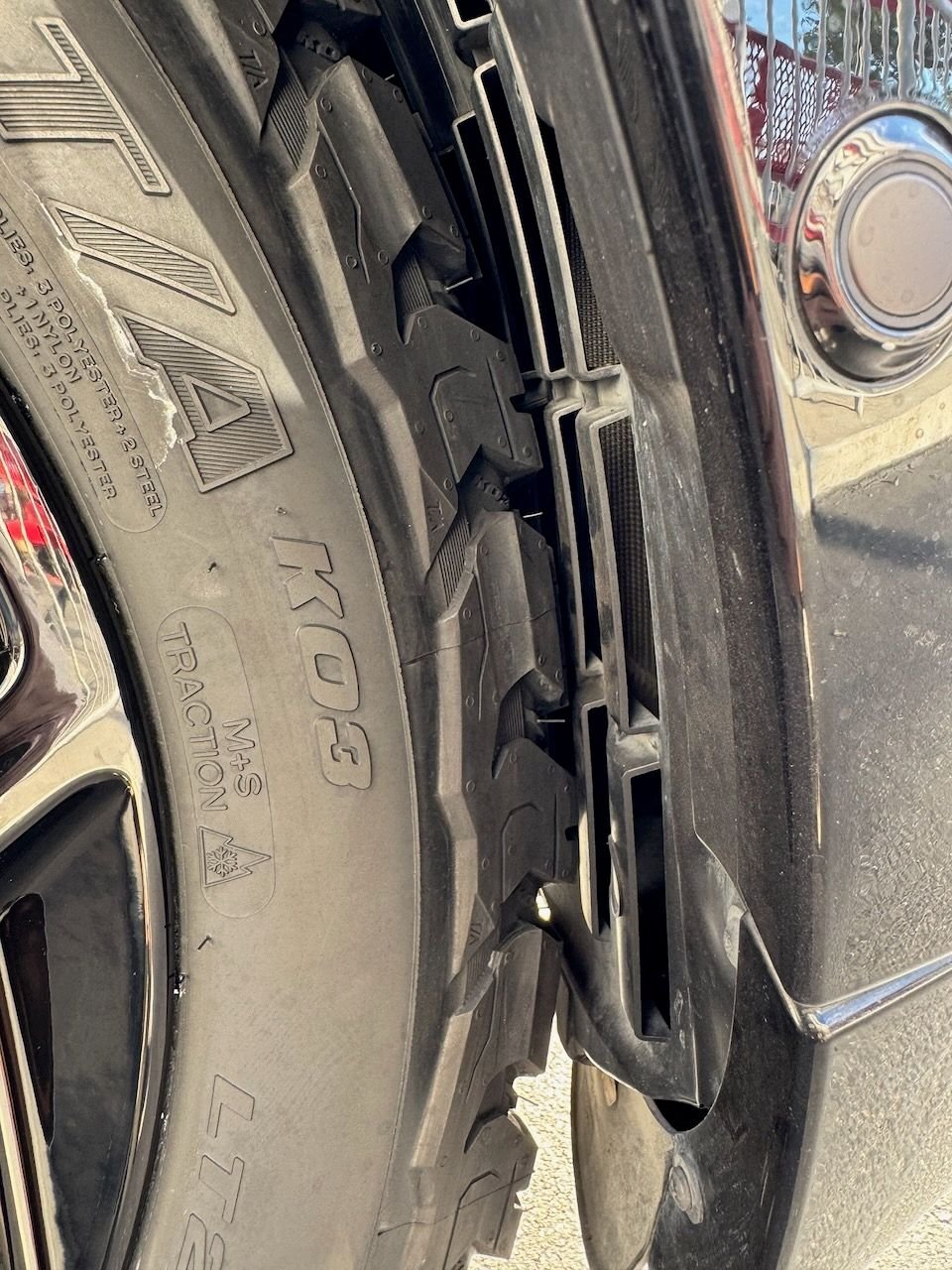

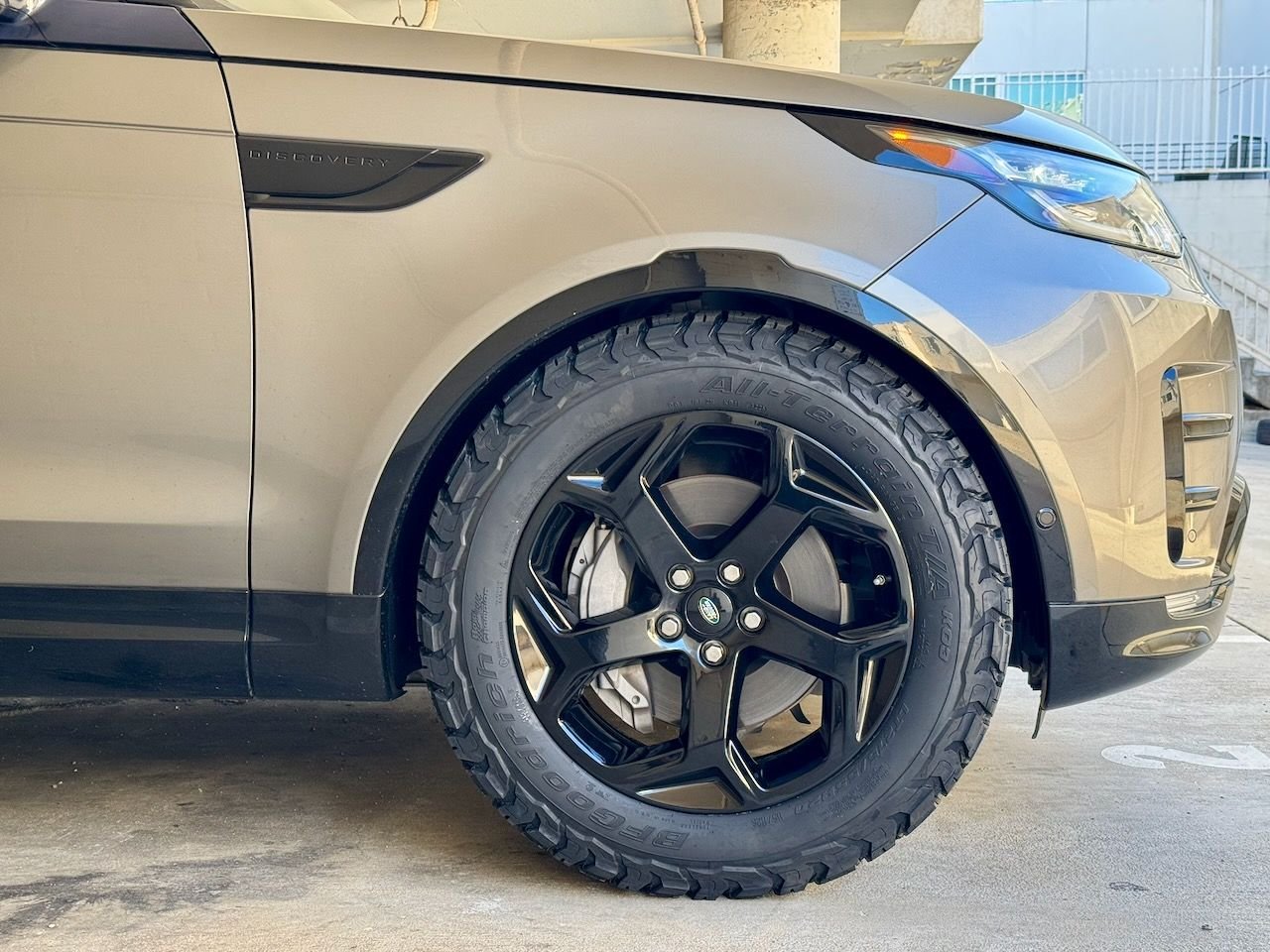

Brief update on this topic. Last week I finally installed KO3's, but I decided to go with 275/55R20, for two main reason:
1. The overall OD is about 0.1" smaller than if I had gone with 255/60R20. Based on some (not all) people saying they had chunkier 275/55R20 (such as AT4W) rub (with no lift), I wanted to avoide the potential rub as much as possible (I want to stay with stock height and would rather not cut/trim plastic).
2. In the event of a tire failure while on a big trip, I like how there are far more AT tire options in 275/55R20. There are really only 2-3 options in 255/60R20 and they are less likely to be in stock.
Here is the install. I did four new KO3's installed on RRS (style 5084) +47mm offset rims. I also installed the same size KO2 (used, 8/32" tread) onto a 20" RRS wheel. This new spare tire and wheel fit easily and great into the spare tire well.
At lock, in access mode (and even in normal height), the tightest gap is about 2mm between the tire and the front plastic.
Ride impressions: on the road, it is slightly louder at 30-35mph, then less noticeable at highway speed. Every speed is louder then my stock 21" all seasons, but overall it is slight and very acceptable. They ride rougher for sure. I'm trying out air pressures right inbetween the light load and full GVW rating. I've only put about 100.pavement miles, and I do need to go back for a re-balance. Will collect more miles and report out in the future after some offroad use.
