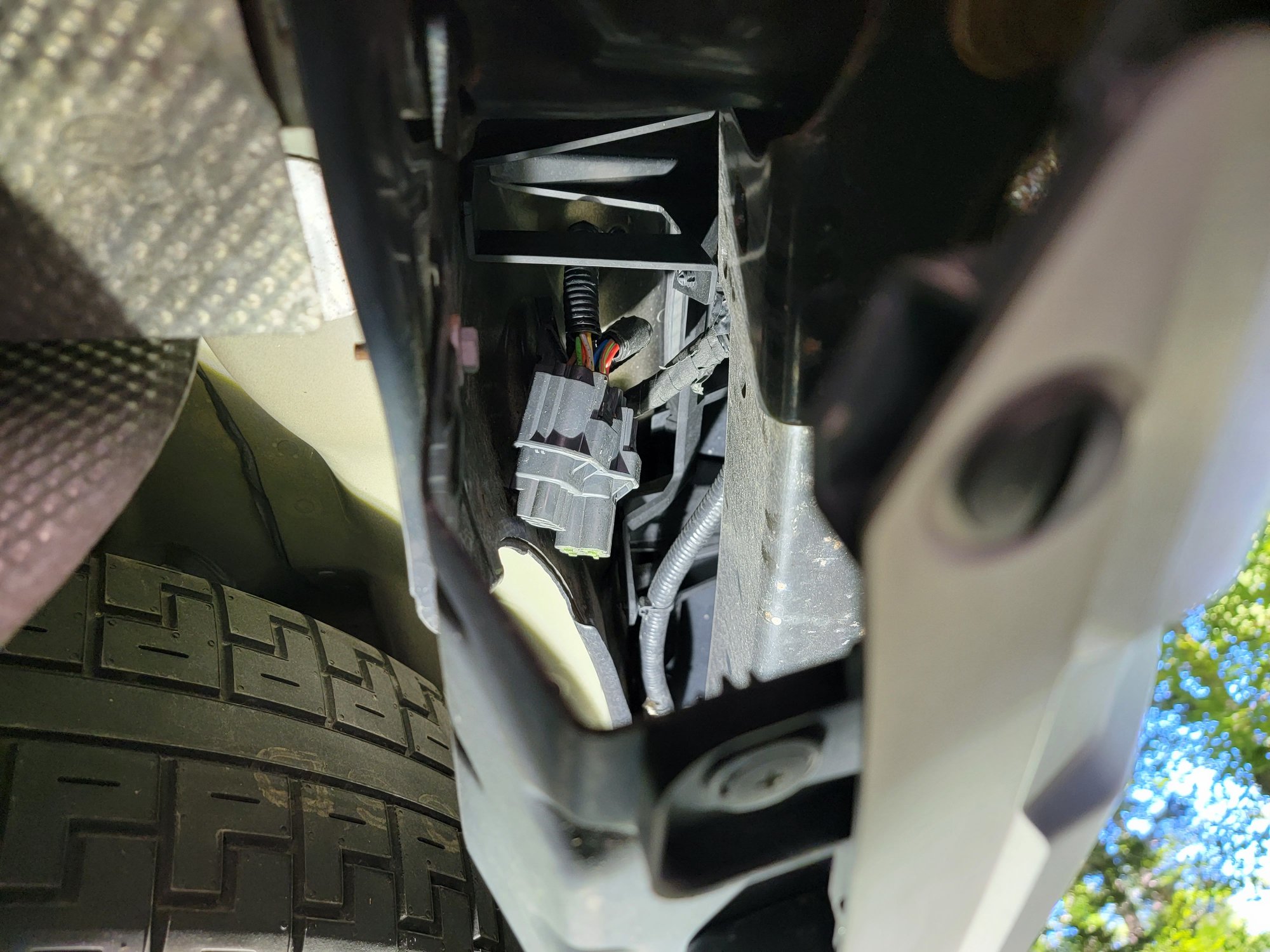

But most importantly -- wiring for the harness is my biggest concern, as splicing wires, etc, as the directions show feels like an opportunity for mistakes. BUT, when I crawled under the car to look around I found what look like pre-wired connections for a hitch? I've attached two photos. Is this what I think it is? If not, what is it for?

Yes, those are the correct connectors for the factory trailer wiring. If you want to use the Stealth Hitch, but want to use the LR wiring and programmed trailer control, then you can't use the universal type wiring kit that comes with the StealHitch kit.
The LR trailer wiring that uses to these two connectors in you photo is not available to purchase. You have to build one if you want to use it, but its not so bad.

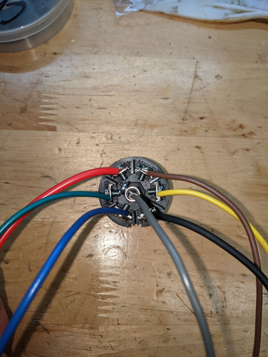

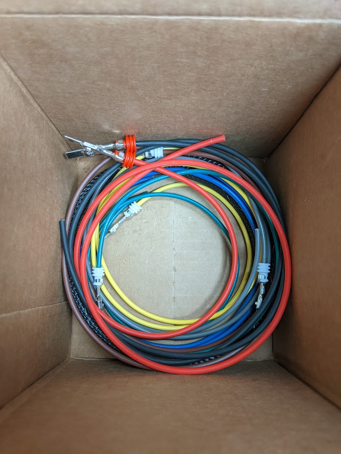

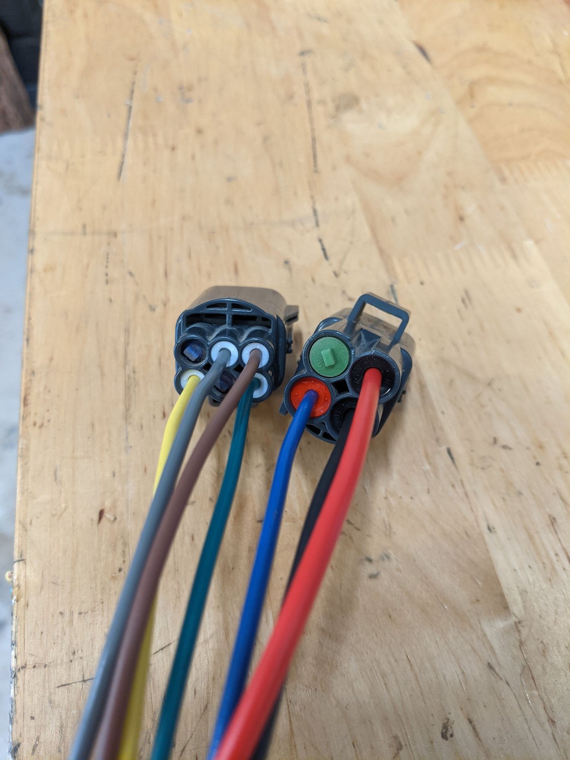

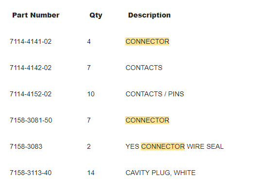

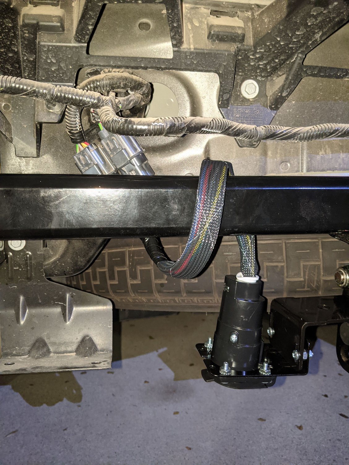

You don't need the plastic connector bodies, just the wire terminals (pins or sockets) and you reuse the p connector bodies that are used for the dummy plugs now.
This is the list of items I ordered from Quest Components and it was enough to make 2 of the trailer wiring harnesses.
Here are some other photos from the construction. The wiring pinout and wire size is from the original Land Rover wiring diagram, but the pinout is clear from the photos too for the US trailer connector.
