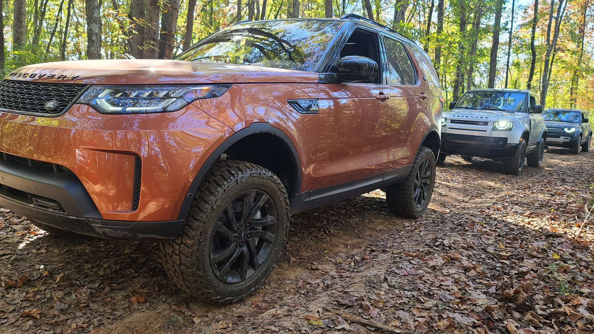

We off-road (desert & rock crawling) quite a bit. I have 2" rods, 275/55 20 Nitto Recon Grappler tires. At full lock, there is a small amount of rubbing, but almost never have to go full lock. On the highway, I really don't think they are much nosier than stock. When off-roading, we air down to 18-20psi, and to date, have not had anything we couldn't crawl over.

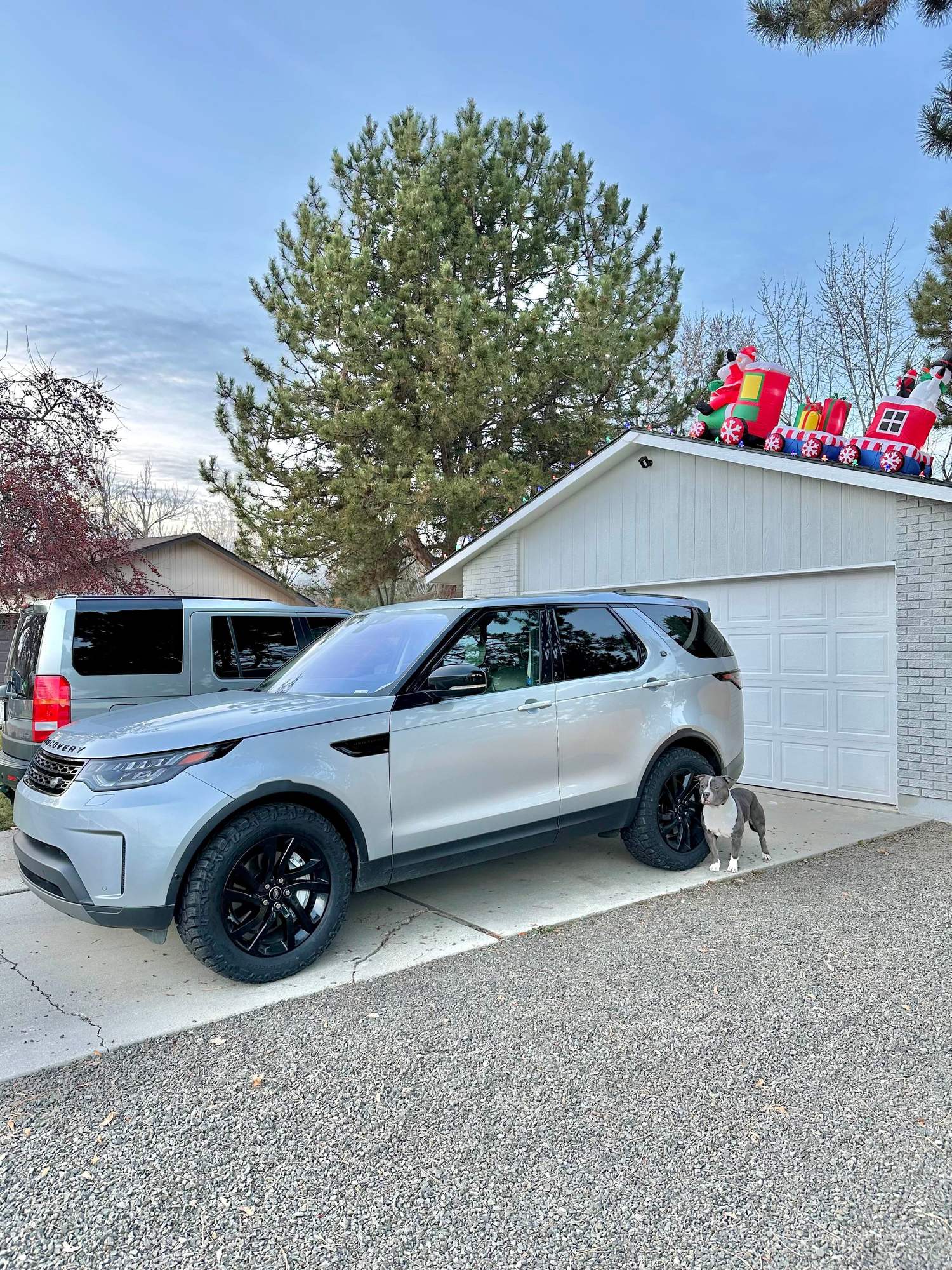

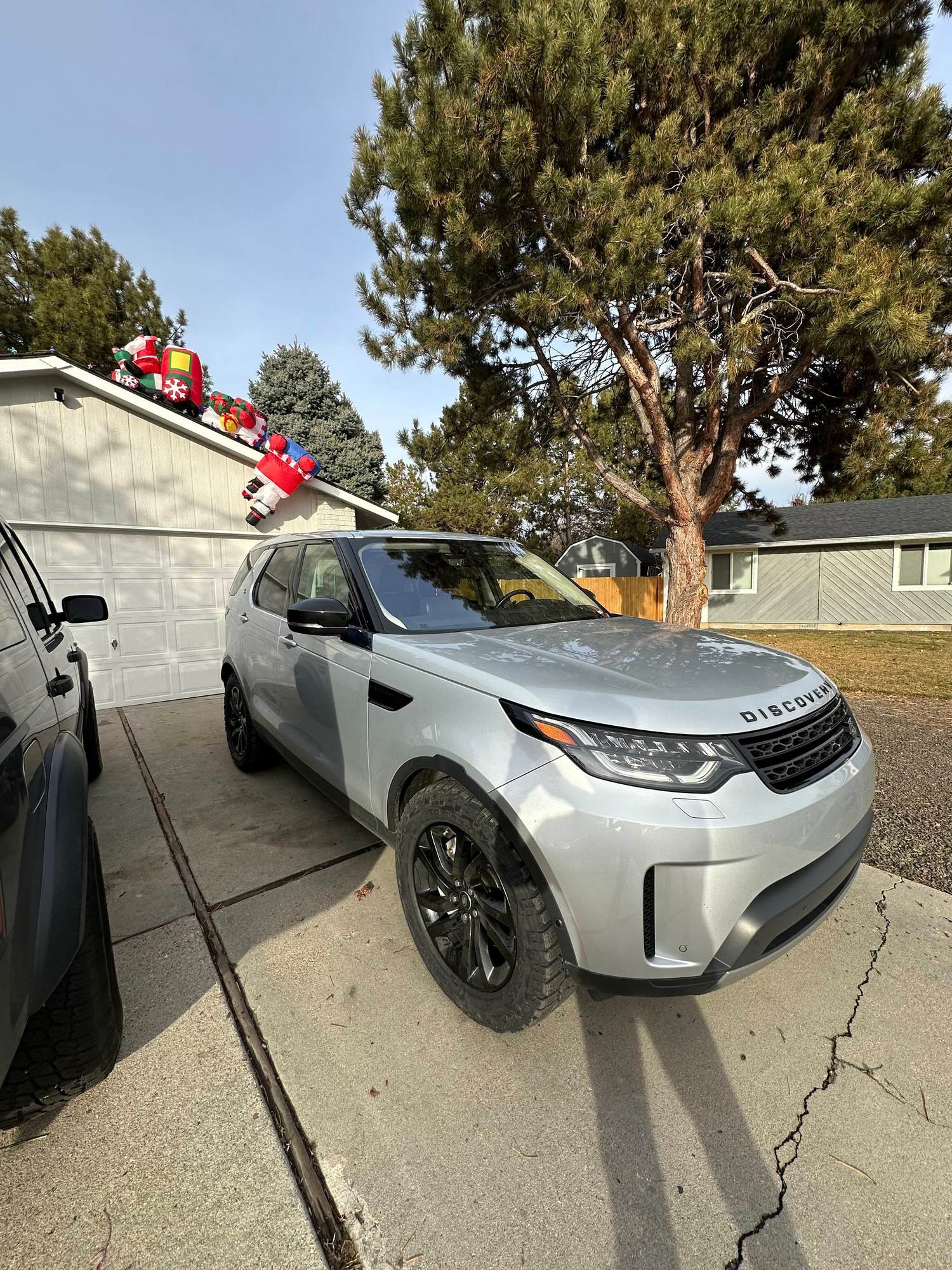

Ended up going with the Rugged Treks! Looking mighty fine in my opinion!

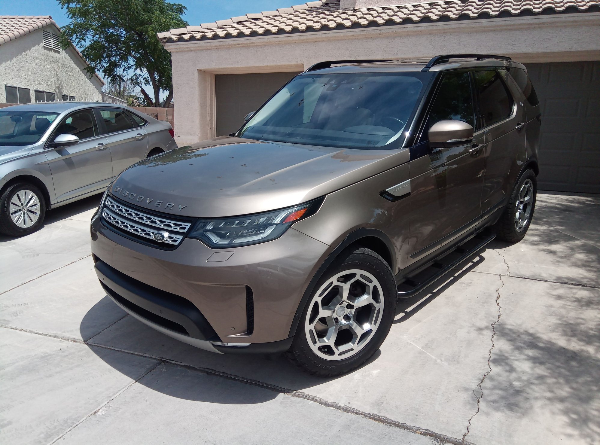

When my D5 had 16,000 miles on it I replaced the 20" x 8.5" OEM wheels and 255/55R20 Goodyear Eagles (including the spare) with 20" x 9.5" Redbourne wheels and 285/50R20 Nitto Terra Grapplers. No lift was needed, and I was very happy with them and had no clearance problems, even when the vehicle was lowered to the ease-of-entry height. They were noisier than the dead-silent Goodyear Eagles but that was a small price to pay for the improvement in handling (due to the wider wheels and tires) and off-road capability. Last year (at 60,000 miles) I replaced the Terra Grapplers with 285/50R20 Nitto Recon Grapplers. The Recon Grapplers are noticeably quieter than the Terra Grapplers were, and I couldn't be happier with them.

How are you liking them?

So far so good, I think they look damn good and the role nice haha.
Thanks for the recommendation!
