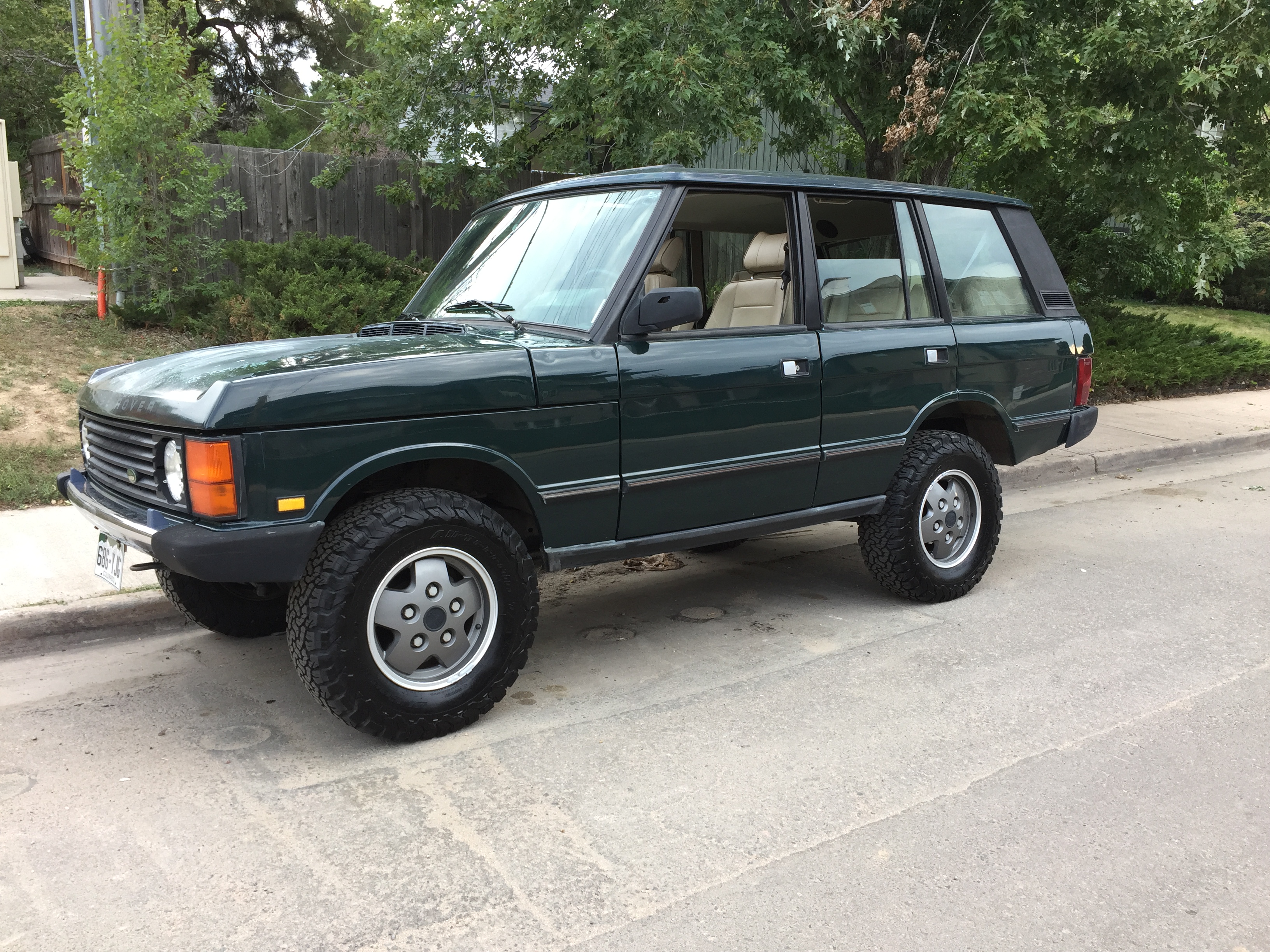

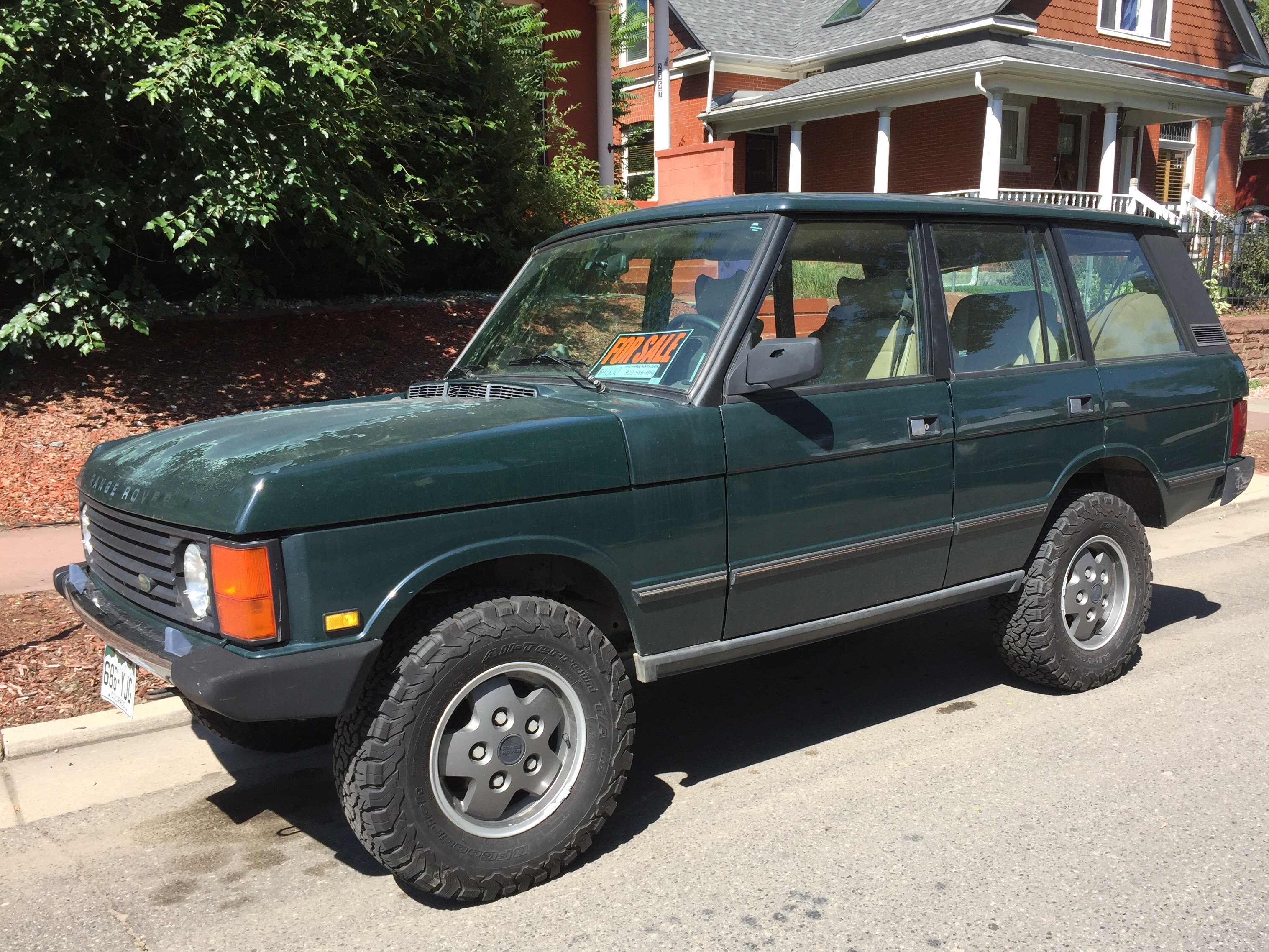

pics...
The first one is the day I bought it. The second is after spending an entire Sunday washing, rubbing, and polishing.
