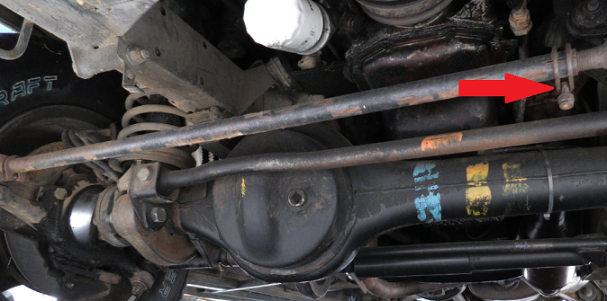

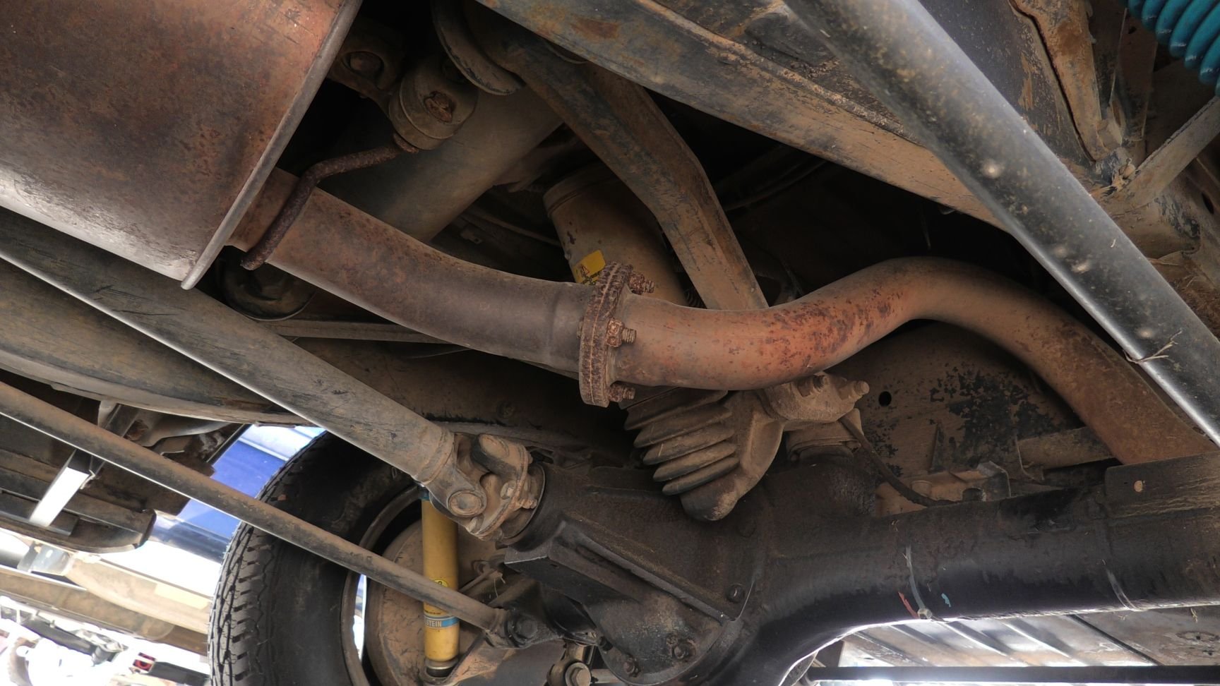

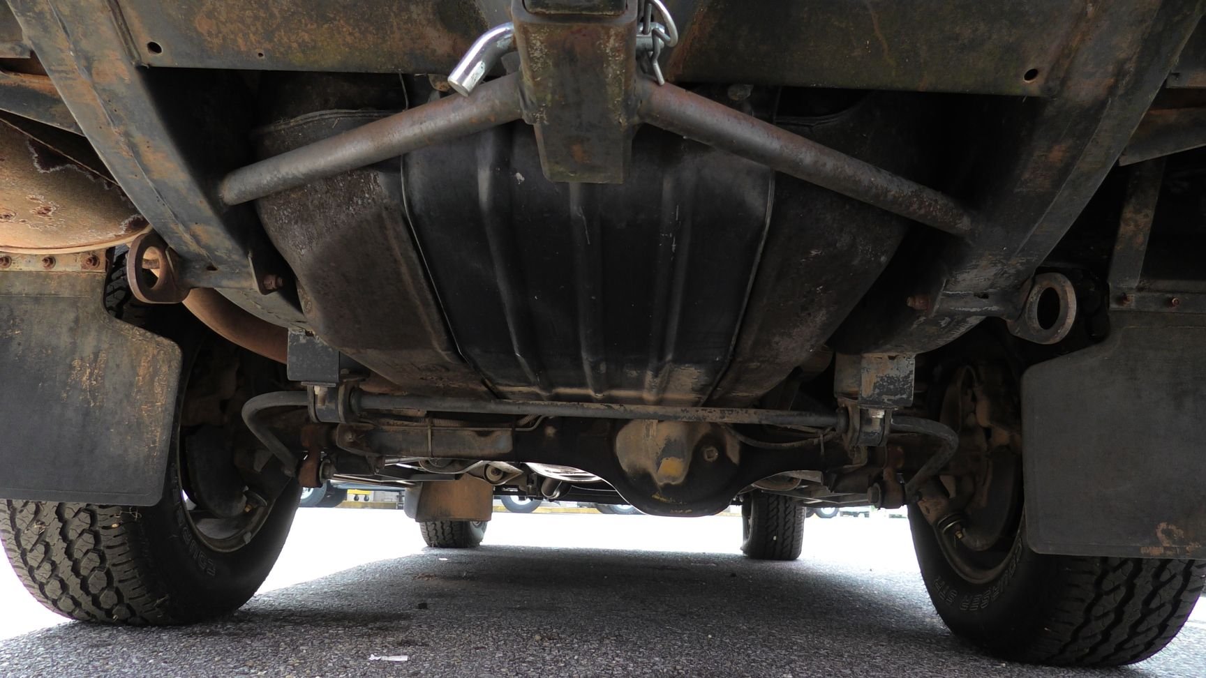

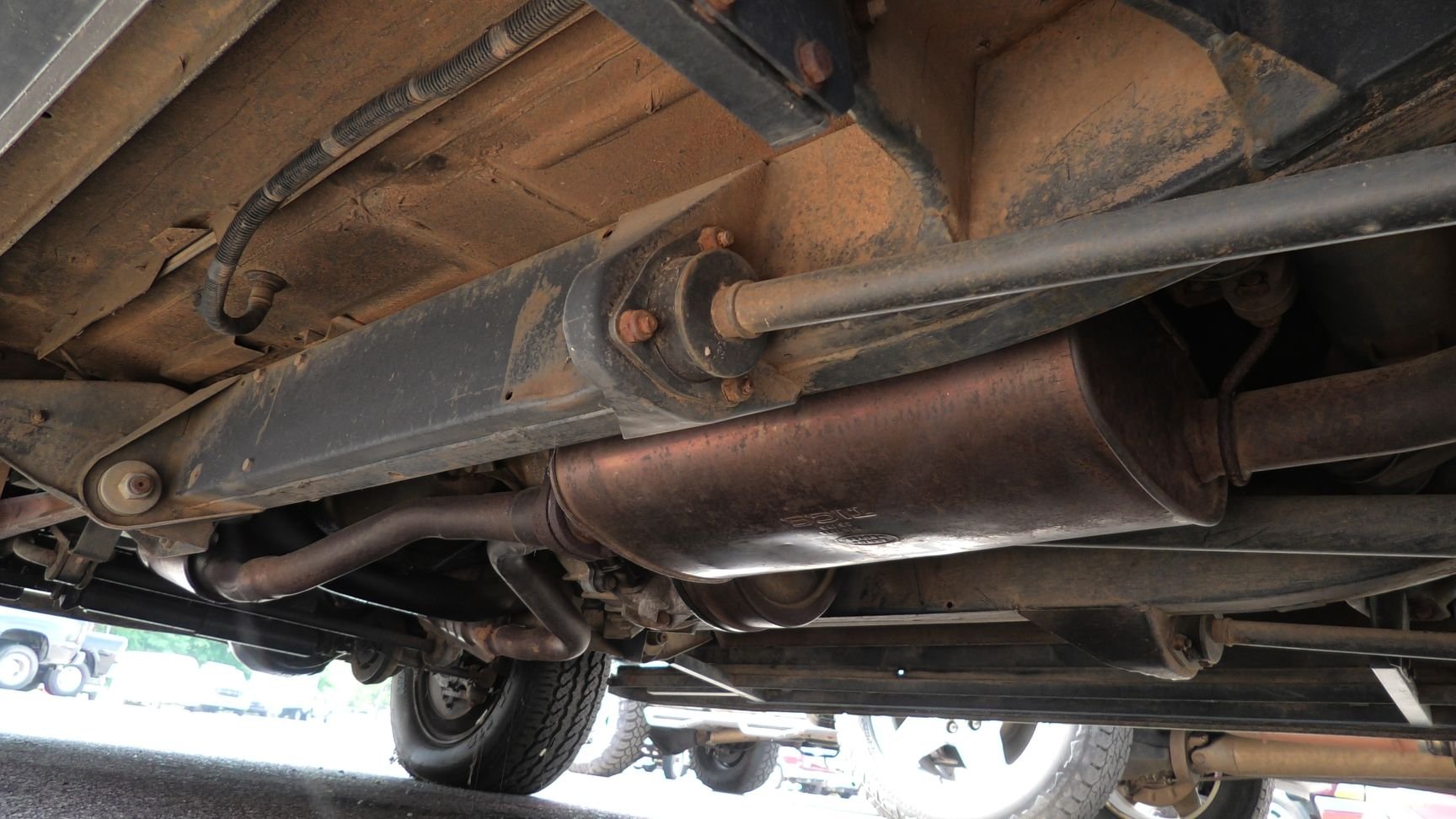

Guy at the shop where it was taken said it needed a fuel pump. Any thoughts on this recommendation? Right now it won't turn over at all.
Any ideas what the blue, yellow and orange markings are?
A few more markings on the rear axle

WOW that thing is in crazy good shape! Got to love the OE Exhaust.
Re: Fuel Pump, not uncommon to go bad and easy enough to test for voltage and pressure.
> Replace the fuel filter and fuel pump relay at the same time.
Re: The paint marks, IIRC they are part of the assembly line process. If I get other info I'll post up.
Generally it looks good and you have the leaks in all the right spots (swivel ball seal, crankshaft seal, oil pan...…)
Just a heads-up the clamp on the drag link is not tight.
