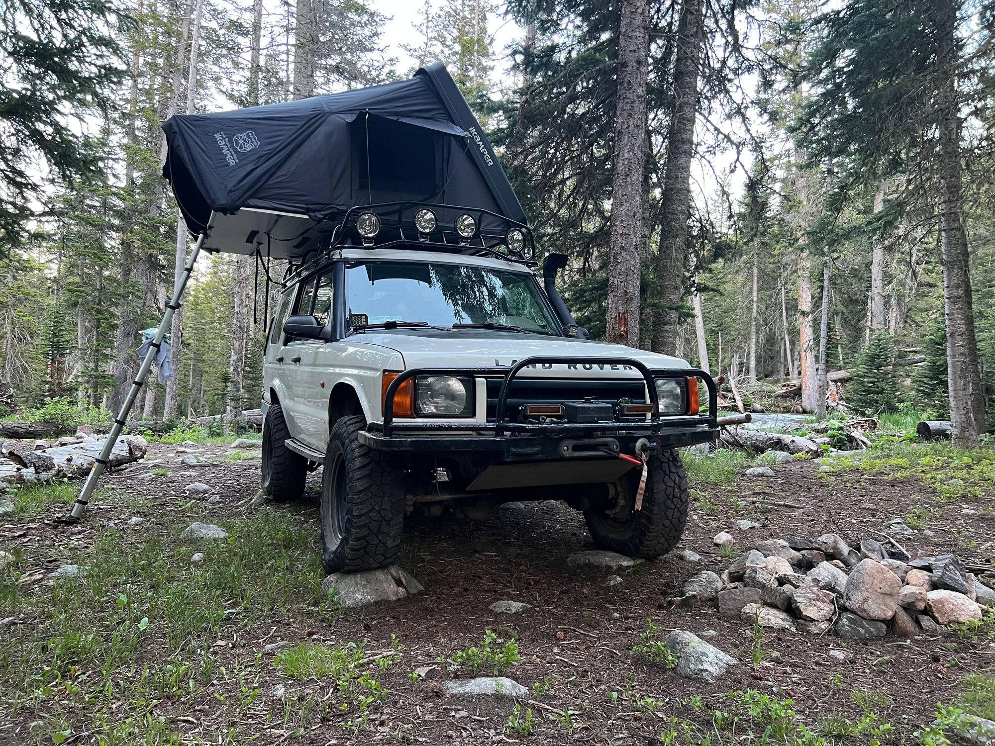

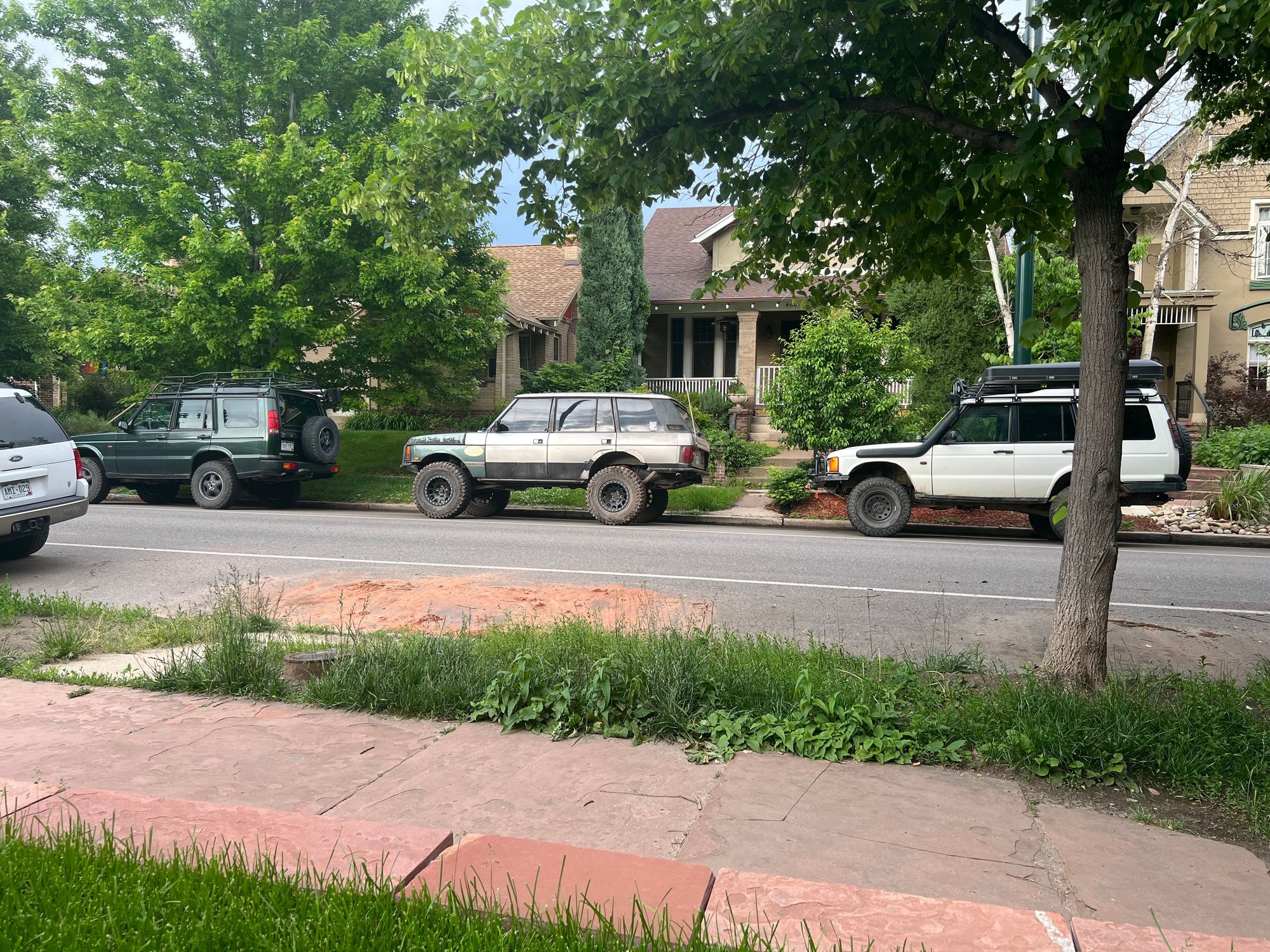

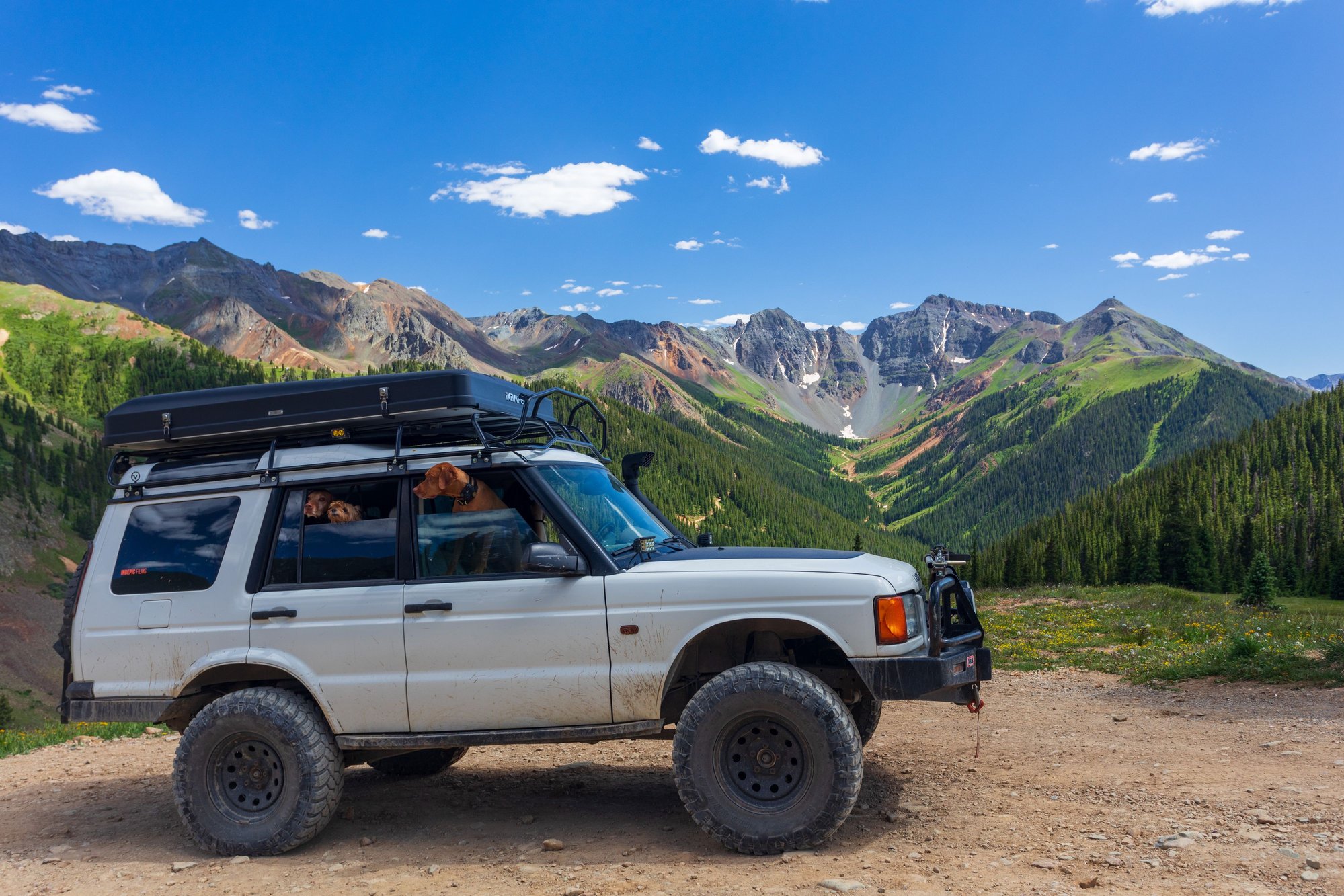

Having both D2s and a LWB classic the classic is so so so smooth off-road. There is more support than D2s as the D1 and defenders all share parts. Lockers are the same however pending year of classic will need to find 24spline shafts and hubs as no one makes 10 spline lockers. The D2 is much smoother power/trans wise and makes more. The classics aren't exactly light once built up but they don't have quite as high a roof line (significantly less head room, ie if you're over 6' probably stick with a disco..).
My classic isn't exactly a typical build as it's got 4-5" of lift and 35s so highway is a little bit of an adventure but I can keep up bombing easy portions of trails with my other classic buddies who I wheel with when in my d2 I never stood a chance (I don't mean anything crazy just the rough run outs on trails when you want to be done with it all at the end of the day type pushing).
The guys I wheel with have all gone from D2s to classics if that tells you anythings...I will say that if you enjoy camping the d2 is a far better platform imo, also why I have two relatively built rovers. I wheel the classic and camp with my white D2 (more space, far better on pavement, and well safer with the dogs and family). So obviously my vote is both if you can swing it haha.
