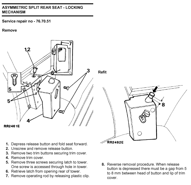

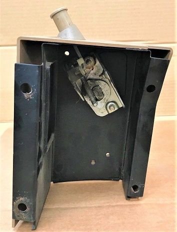

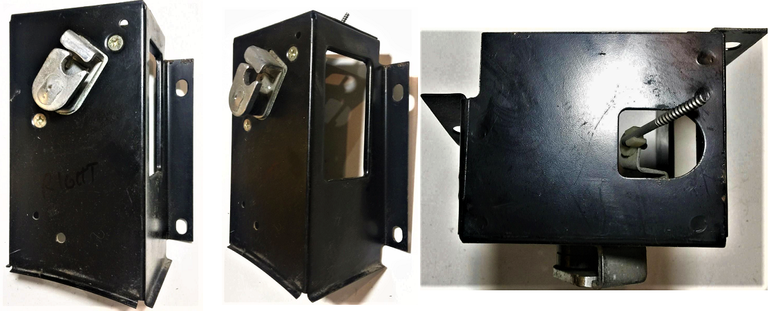

Just gently pry the cover up from the bottom, then grab the sides of the cover and pull outward.
That's the way I've done it many times.
You can also spray some WD-40 through the top release button hole. Could help if the plastic is stuck to the metal latch body.
Here are a few good looks at what you're working with.....there's just not a lot going on.
