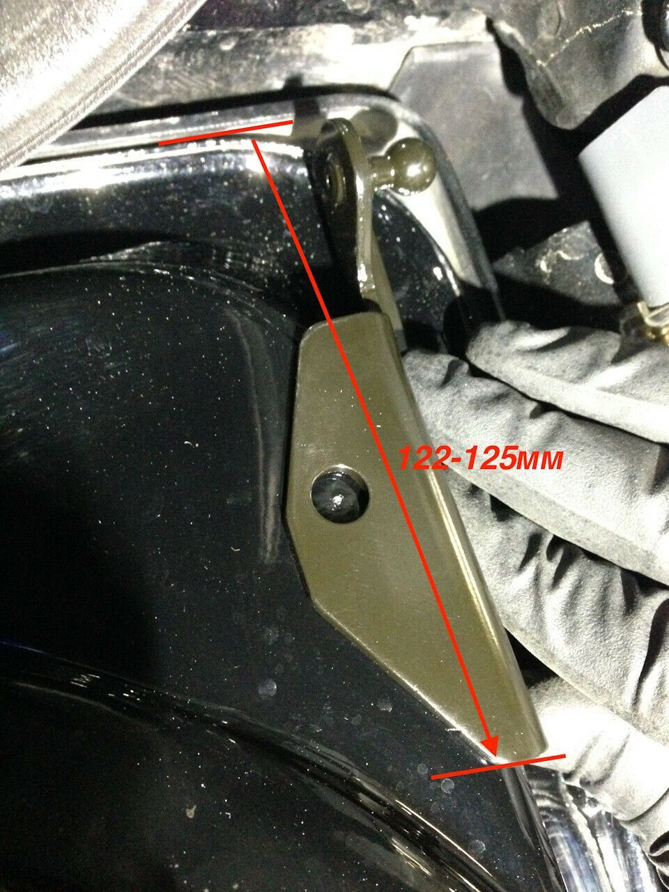

Hi Everyone,
I'm going to do the tailgate modification to my '09 to have the tailgate open gently instead of crashing down like it does now.
I got all of the needed parts from this thread: https://www.fullfatrr.com/forum/topi...light=lr021053
The only question is exactly how to position the bracket that attaches to the tailgate.
I found this image on the web but I don't know if it's accurate.
Hi Everyone,
I'm going to do the tailgate modification to my '09 to have the tailgate open gently like they do starting in 2010 instead of crashing down like it does now.
Can anyone with an '10, '11 or '12 verify this position? The text said that it was 122 - 125mm from the bottom of the tailgate but the image shows it from close, but not at the bottom of the gate.
Thanks in advance!
Larry.
