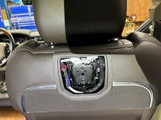

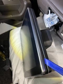

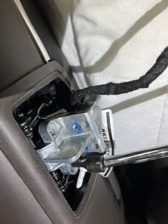

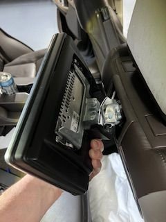

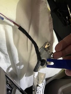

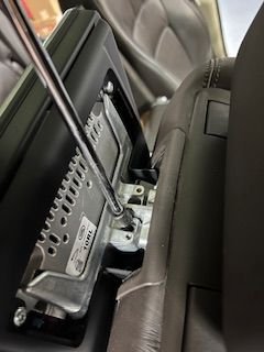

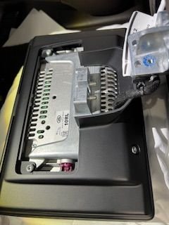

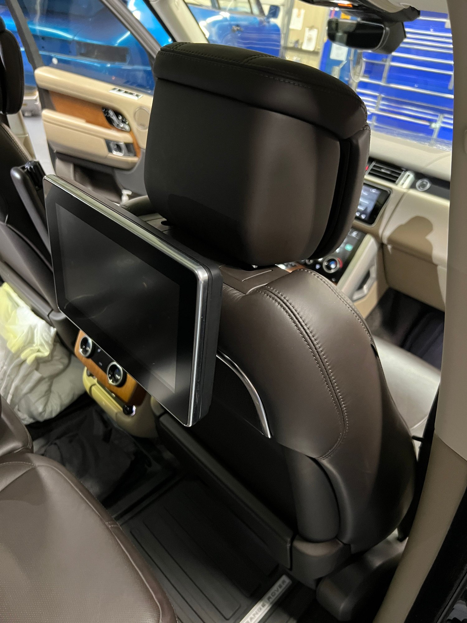

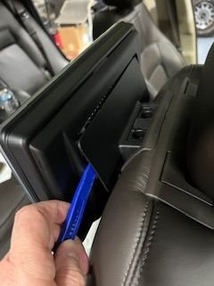

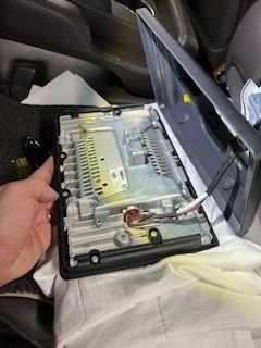

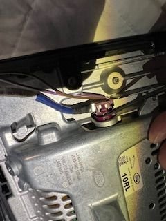

Default On my 2019 L405 AB
Before photo
Remove cover
Remove 2 screws
Remove cover
Remove 2 screws
Lift monitor off
Remove 4 screws
Seperate cover
Push in tab and remove connector
Remove bracket. 3 screws
Remove push in fastener to release cable from bracket
Tuck away wire

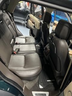

After photo
Old Aug 23, 2024 | 08:28 AM
Kilroy's Avatar
6th Gear
Joined: Aug 2024
Posts: 6
From: Clemson,SC
I have done this on my 2019 RR AB. No coding required yet. So far nothing else in the car seems to miss them. Working on a cover now to plug the hole.

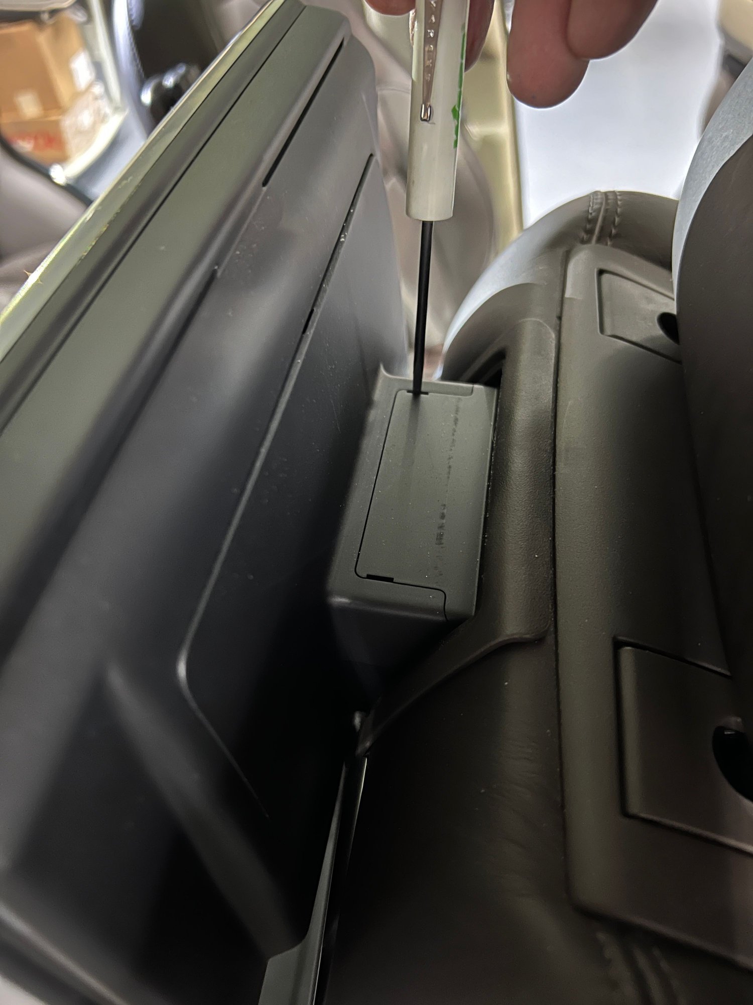

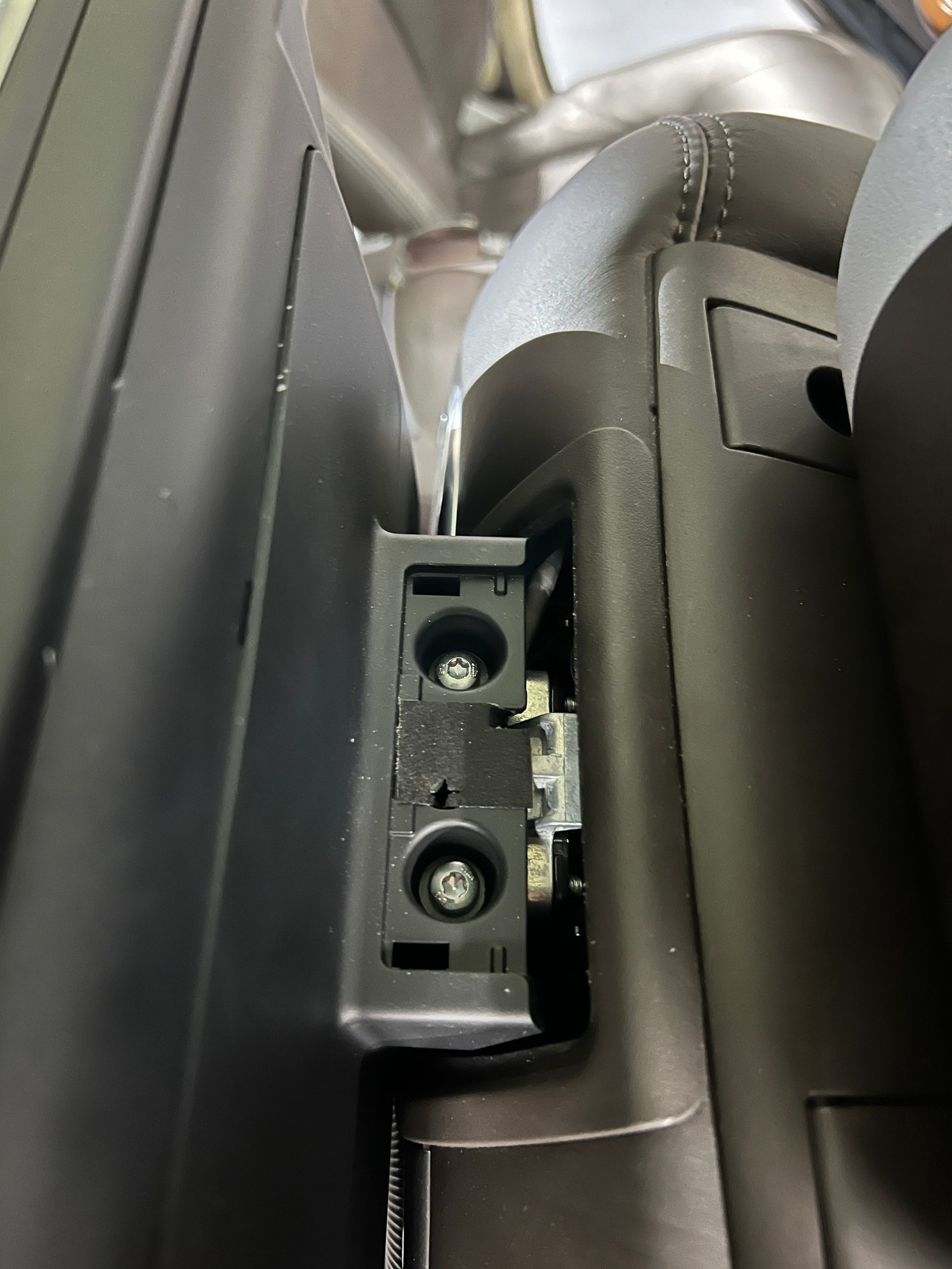

Before photo
Remove cover
Remove screws
Remove cover
Remove 2 screws
Lift monitor off
Remove 4 screws
Seperate cover
Cover removed
Tuck away wire
After photo

Posted a series of photos explaining how but waiting for moderator to approve. In case anyone else is interested.
