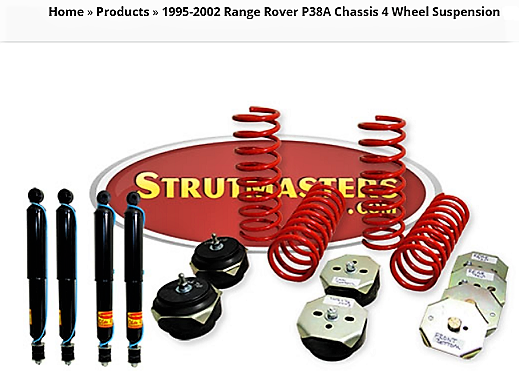

i was in a upull junkyard in Detroit yesterday grabbing what I could off of a couple of p38’s yesterday. 2 of them had coil conversions and it didn’t look like it would be too hard to remove them. I’m sure they’d be cheap enough. My truck is currently on air and doing fine but I am interested. One truck had red coils with red koni shocks, machined aluminum plates. Anyone have a clue what brand they might be?
the other truck had grey springs and 265 tires. I’m guessing Terrafirma as a couple of the springs were rusted bad and I’ve heard the do that. The adapters looked like square plates with the corners folded up to keep the springs.
Any thoughts if it’s worth my time to pull one of the kits or which one would be better?

The springs and mount plates are most likely from STRUTMASTERS.
And they used Eibach Springs in those kits.
> https://www.strutmasters.com/product...shocks-lb24fl/

I've used Eibach springs on BMWs in the past and the quality was ok.
As for the Strutmaster Kit IDK how the springs would be on a Rover.
I can tell you that I looked into this "kit" about 5 years ago and after a call to Eibach it turned out
that Eibach does not support this as an application for a Land Rover.
I was told basically Strutmaster found a spring from another vehicle that would "work", and that's what they are using in the kit.
Eibach also said no warranty through them because the springs used are not application specific.
I know you are looking to get the springs used so this is not an issue.
That info was about 5 years old, but it looks to be the same today on the Eibach site. No Rover application.
> https://eibach.com/us/c-67-products.html

A buddy of mine has those strut master springs on his p38 and they sagged a lot.

As I installed the spring conversion into my p38 yesterday I noticed a name on one of the coils. It’s an arnott coil conversion. The swap went pretty good, the old retaining clips corroded in the aluminum adapters were the only problem.
I only drove it a few minutes after and the ride seemed ok, not great but ok. Some more driving will tell the tale.
