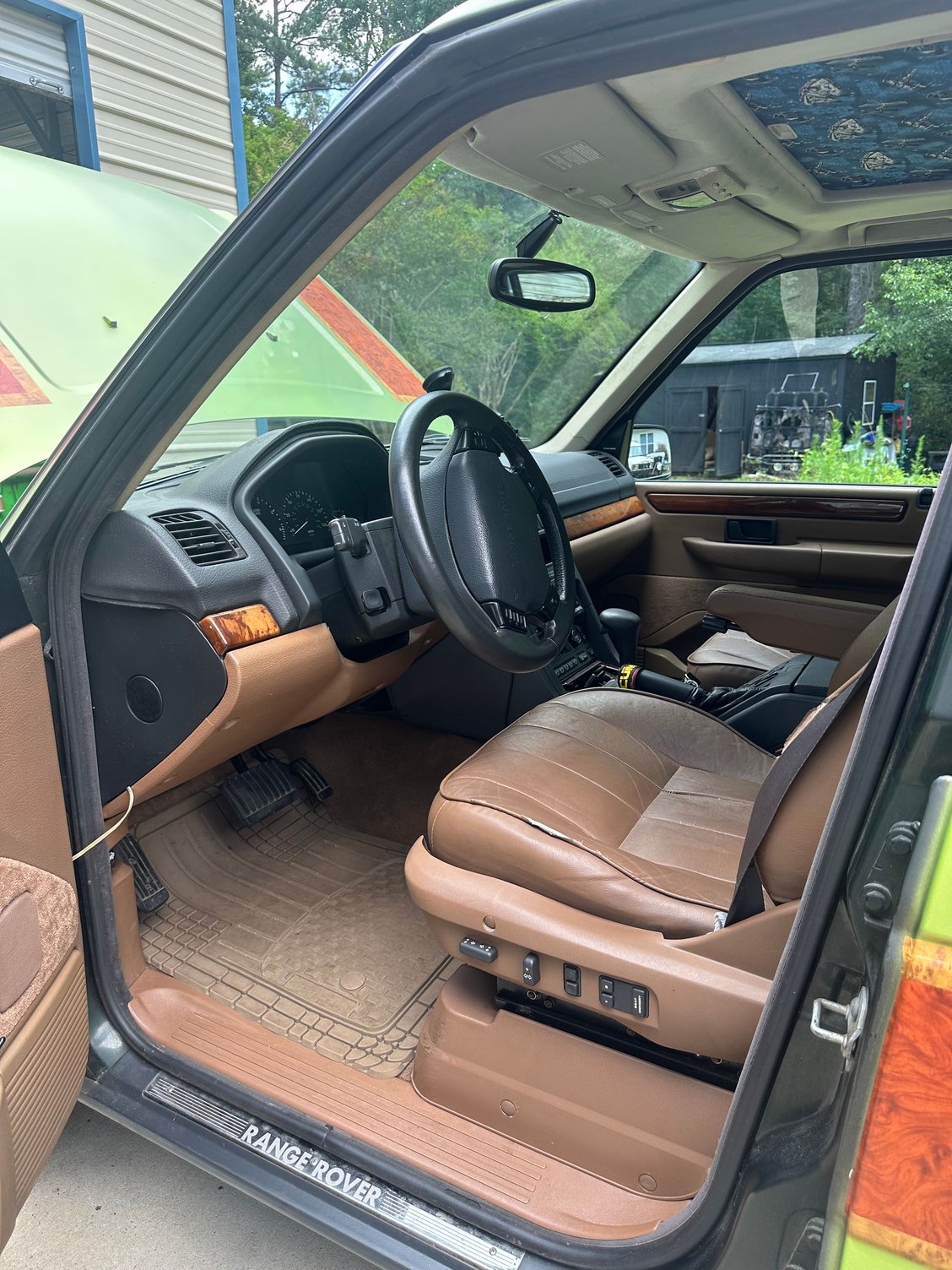

My dad was messing with the blower motor issue while I messed with putting the interior back together on the drivers side
Old Jun 17, 2025 | 07:38 AM
  #103
Time to button up the exhaust
and now we are at today. We are a few days before we leave the interior is all buttoned up. I think we have everything sorted that we can. I’m going to put together a box of spares, fluids etc for the truck and load my tools. Some camping gear for our Nebraska stop and I think we are as good as we are going to get.
