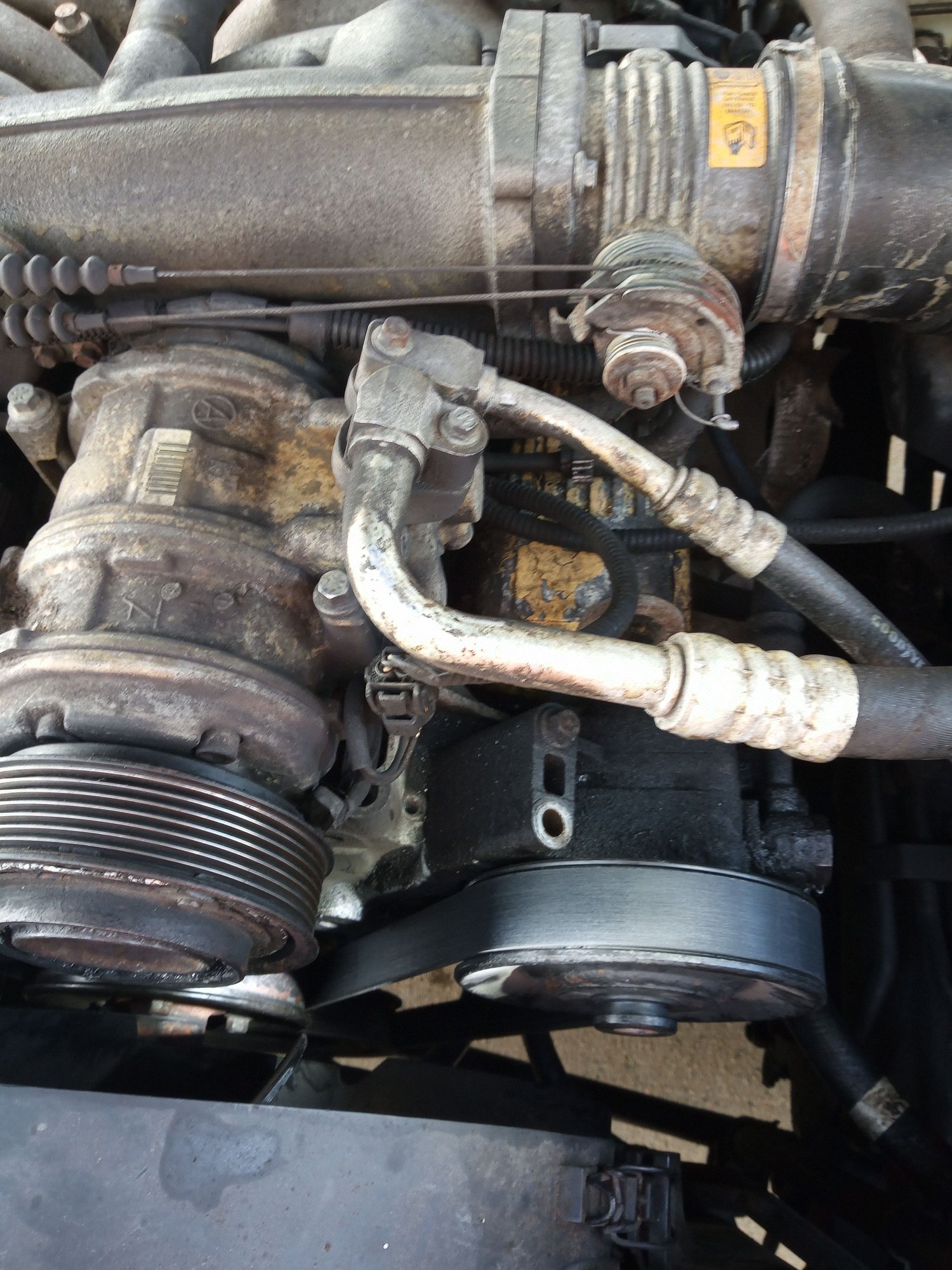

Alright so - new range rover owner. got into an accident about a month ago, cashed out and went for a low budget buy! a RUNNING range rover for 1500$, I couldn't say no.
fast foward 2 weeks later - serpentine belt breaks going 60mph (doh!) luckily it didn't break anything else, but after further examination I've concluded the problem (probably also an old belt aswell)

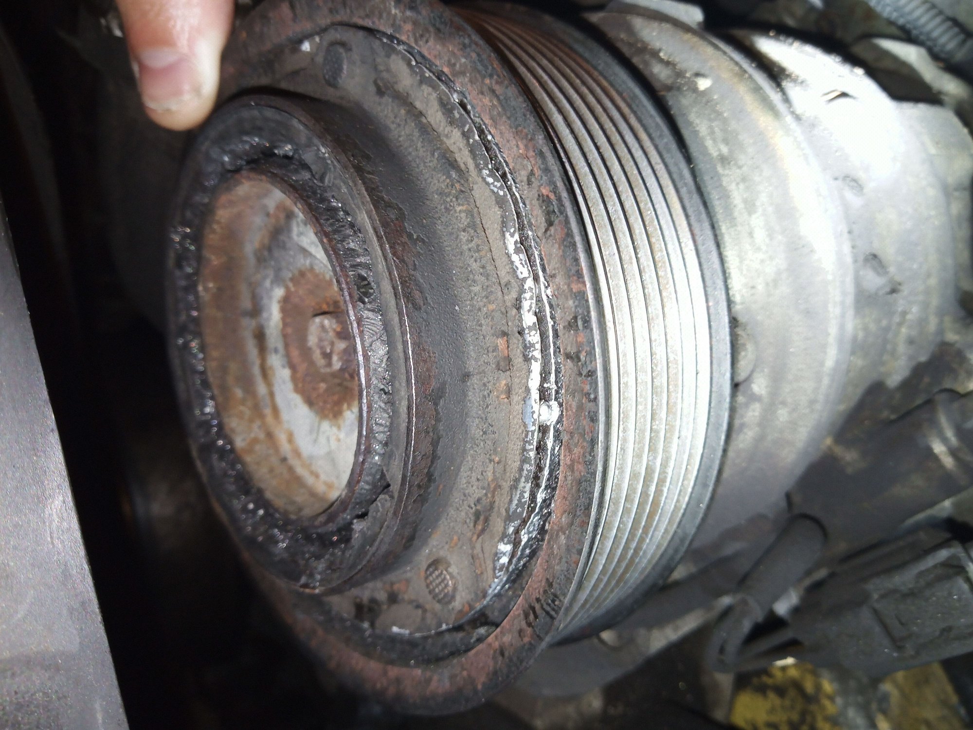

AC compressor pulley is complete garbage, loose as crap and just not good. Also the previous owner said the AC didn't work anyway (not sure if the pulley the reason why) after looking it up online, AC bypassing with a shorter serpentine belt is my best bet.
So my journey begins. I'm sure this will help a lot of people because I haven't been able to pinpoint an accurate belt solution for the i think 1993-2002 4.6 HSE range rover models as there as so many different variations of the land rover engines
anyway, I've done about 4 hours of digging on the internet and this is my best bet - Dayco 5070750
apparently a toyota/ford belt? 7 ridges and 75" long
I'm going to test it and post my results, with pictures as well.

Wow it worked holy crap.... in the most unconventional way. bypassed the tensioner and removed one pully to get this belt to work, didn't feel like going through the hassle of finding one that fits perfectly for whatever the heck my setup is... spent hours trying to find my exact fit for just bypass AC alone on the internet earlier this week, but cannot find the exact one. 2 hours of choking this 5070750 belt in there and I swear NO ONE should do this... i'll post pics tomorrow, its bonkers
although after driving for 5 minutes the temp guage ran to red, pulled over immediately before it went full blast red zone. noticed the block (or headers? I'm noob to mechanics) is SLIGHTLY leaking radiator fluid where a gasket meets the block I guess?. but i'm wondering where the hell all the fluid went to begin with, the reservoir was almost empty when i pulled over. filled it back up (the reservoir) and drove it home (about 5 minutes of driving very slowly) it didn't get past half way on the temp guage
I'm wondering maybe somehow coincidentally my radiator is empty or maybe i busted a water pump and don't realized but when i parked the car when i got home there was no leaking which is just strange to me...

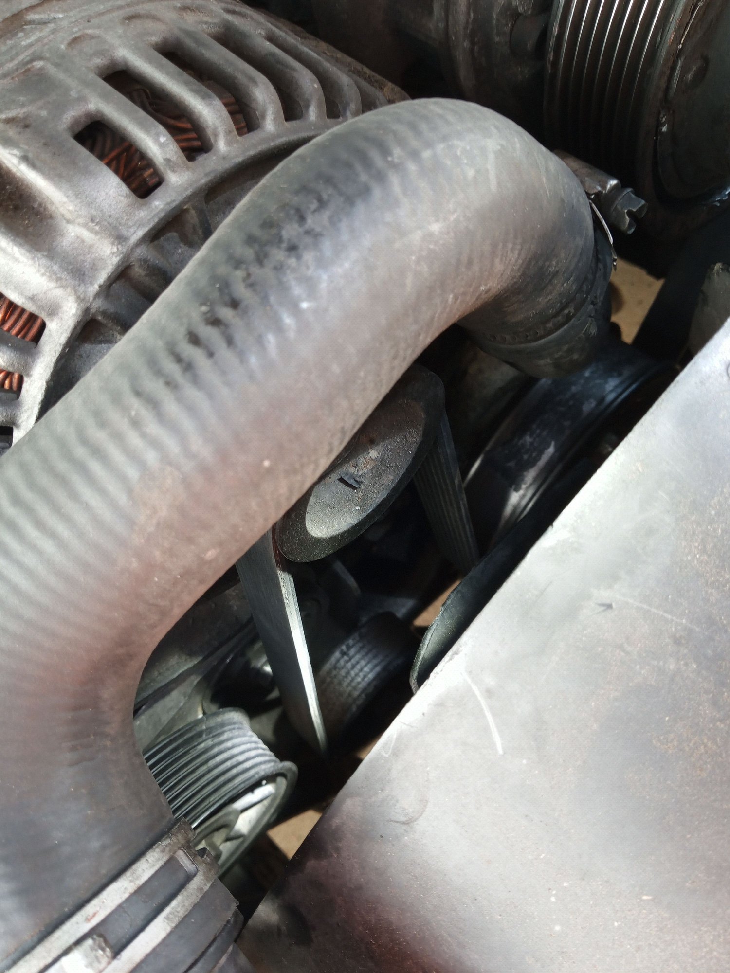

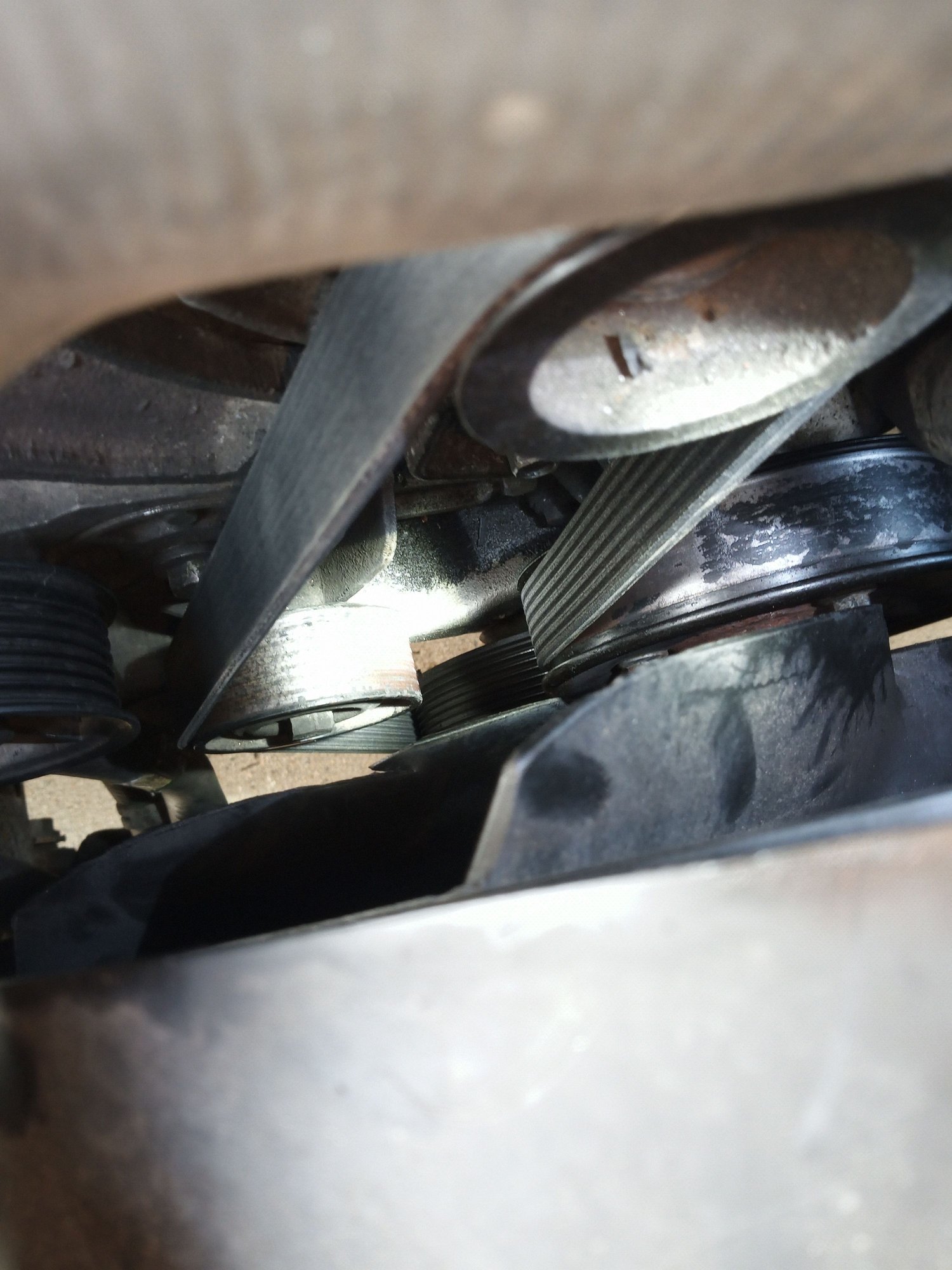

Heres the pics, its wild. I took a screw driver on the left idle pully and wedged it on there with what seems to be all my strength. one of the hardest things I've ever done in life ugh -_-
The over heating problem is still an issue, after talking to some people i've come to the conclusion the radiator fluid is just pouring into my engines oil area. I checked the dip stick and it WAY over full, like 2x past the full bar... gotta replace the headgaskets and maybe other things.
Would greatly appreciate some insight from anyone. going to defiantly replace the head gaskets myself but what else should I replace while i'm at it? Do i need to replace the whole entire aluminium housing? or just gaskets?
