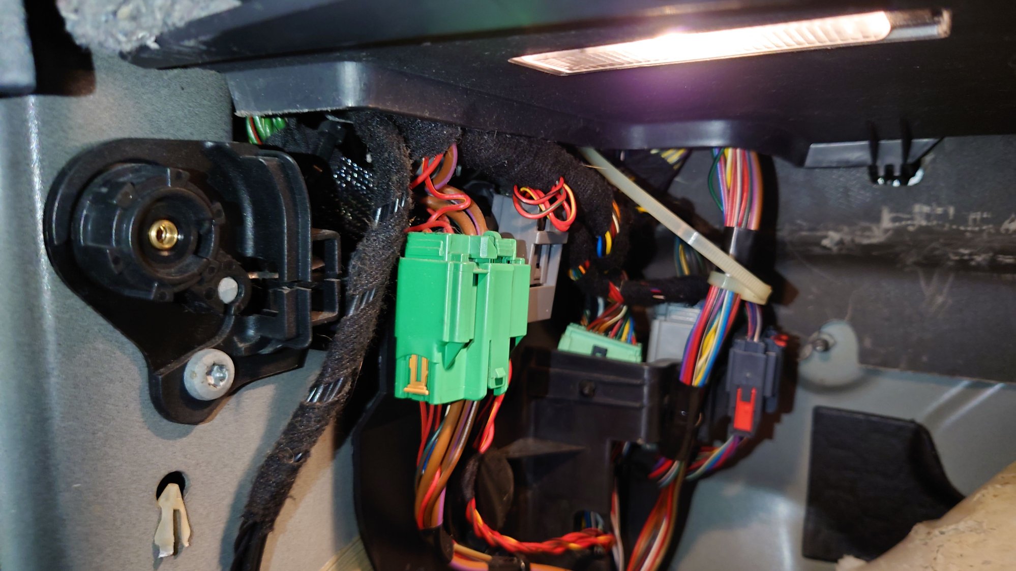

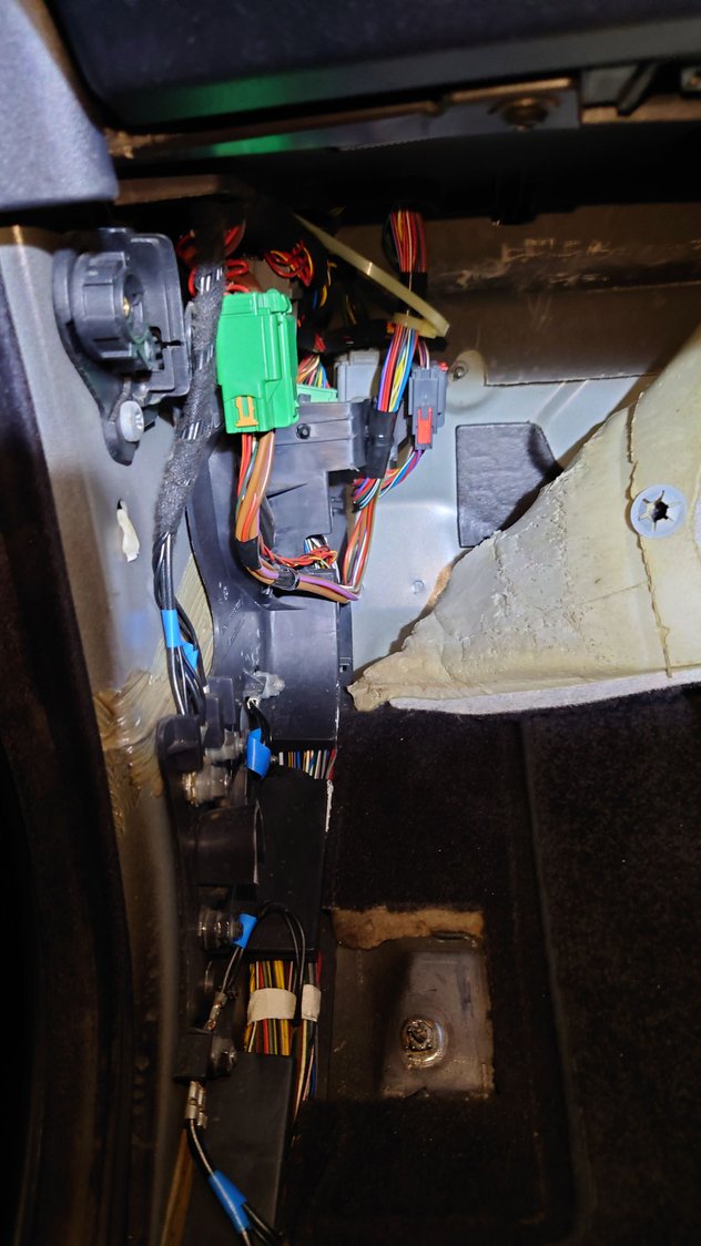

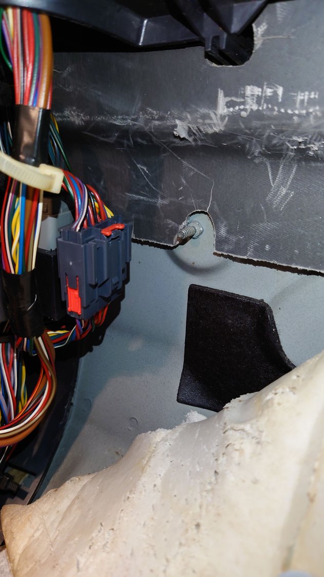

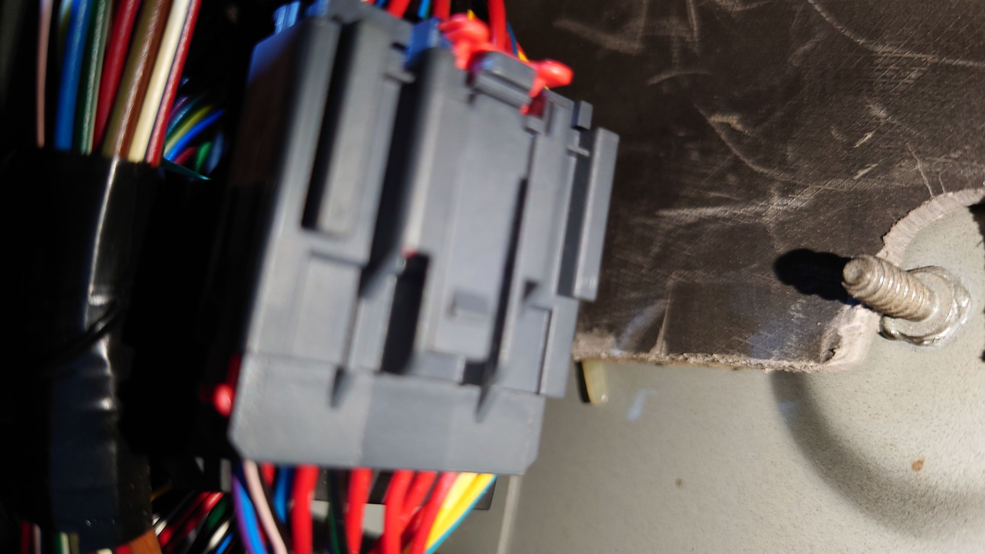

Update: I have replaced the portion of the hood cable that goes to both of the latches, and it has cleared the "Bonnet Open" message. However, I am still trying to figure out how to go about replacing the portion of the hood cable that goes to the release lever. I took some pictures that I am including to show the problem area. It appears a lot was packed into a small area, and it will be a lot of disassembly to better access the cable and the grommet being the problem part. Behind the corner of the gray colored foam is the grommet, which I can feel with my hand, but I do not see how I will be able to pull it out and insert the grommet of the new cable.
