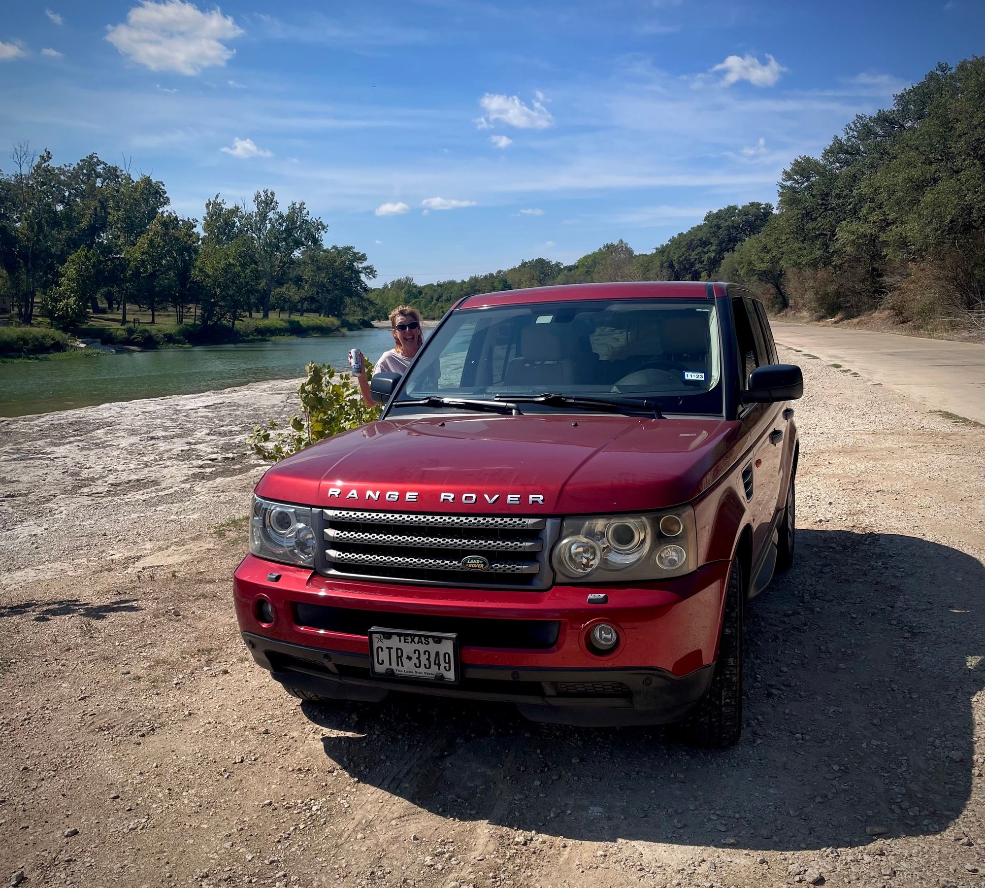

Picked up a 2006 Range Rover Sport HSE. Absolutely LOVE it. It has 116K miles on it.
