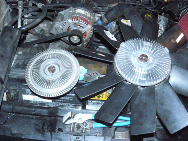

1. See tech section of the D1 forum for a write up on a $50 Chevy cross over fan clutch. I will also point out that if funds are tight, the salvage yard is full of Chevys and GMCs, the same 6 inch reverse direction clutch screws right on to our water pumps. You'll have to enlarge the mount holes in the fan slightly, always mark fan front / engine, so it goes back correctly - cupped side of blades toward block. Pix of junkyard Chevy clutch (1998 - 2003 usually) and Disco blade, and a bigger Blazer blade I found, clutch and blade like $19.
Pix of fan clutch - a'int saying a new clutch a'int nicer, but sometimes a new one is too far away by holiday shipping or money is tight, etc. A good clutch, when warmed up, should not freewheel, only turn 1 revolution when spun by hand and released.

swapped out my fan clutch with the chevy one, took about 15 min total, with a cost of $50 very nice. Hopefully this cures overheating issue (it was bad either way) not going to spend 600 on a radiator.

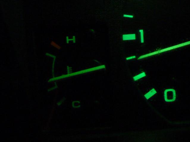

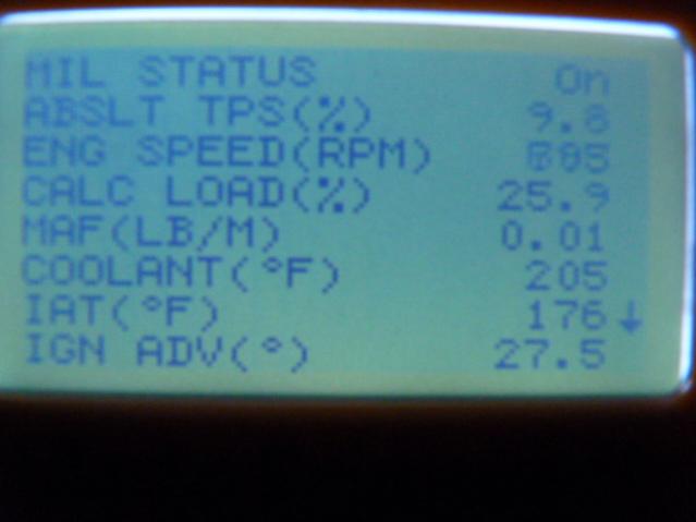

IMHO you are in danger of killing the engine. The gauge is built to show 9:00 for a wide range. Mine does not go above 9 until above 235, and that's too hot to begin with. The gauge is not linear, and not like Detroit ones. Above 9:00 is cooking. And fan clutch won't help this at above 40 mph. Fix this first.
Might throw in a bottle of "water wetter", it will reduce heat a few degrees.
You can borrow a scanner that reads data and plug into the OBDII port under the dash, and see real temp you are getting. That way you know if a fix has worked, before cooking again.
Also you might like an Ultra Gauge, it can display digital temp and have a programmed alarm point and double as code reader/scanner. About $70.
