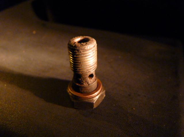

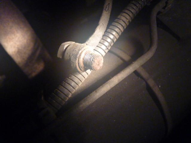

And here is what is at the axle end. Mine was plugged, you remove the "banjo bolt", and run a small wire up the tube, and also clean out the bolt itself. Blow out open line with air or some spray solvent. Once clean and open re-install.
