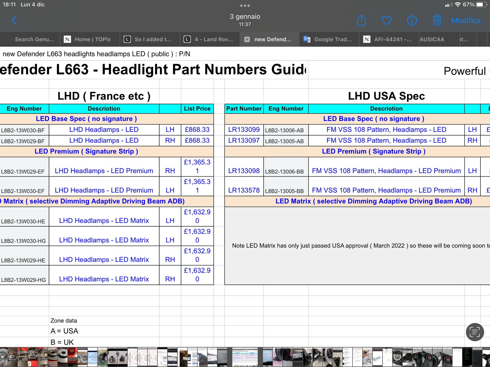

Hi everyone,
Then there are three specifications of LED headlights, UK market, EU and North American market, and USA market.
The first thing to respect would be the lighthouse code relating to the market of your car.
If the market does not correspond, the software loaded into the headlight ECU may not allow the light to function correctly.
Second important thing, (see powerfuluk video), the installation of new headlights requires programming the headlight ECU, you need to flash the software, in addition to encoding the appropriate ccf file.
The installation of a pair of used headlights from the correct market requires only the coding of the CCF file, a different VIN will be stored in the ECU memory but this does not generate error DTCs.
All this naturally applies to original OEM headlights.
If you need to program the light with software flash, the only one that can perhaps help is: autosvs, in the person of Gary, has the possibility of working with a PC remotely and downloading the appropriate software.
Marco
