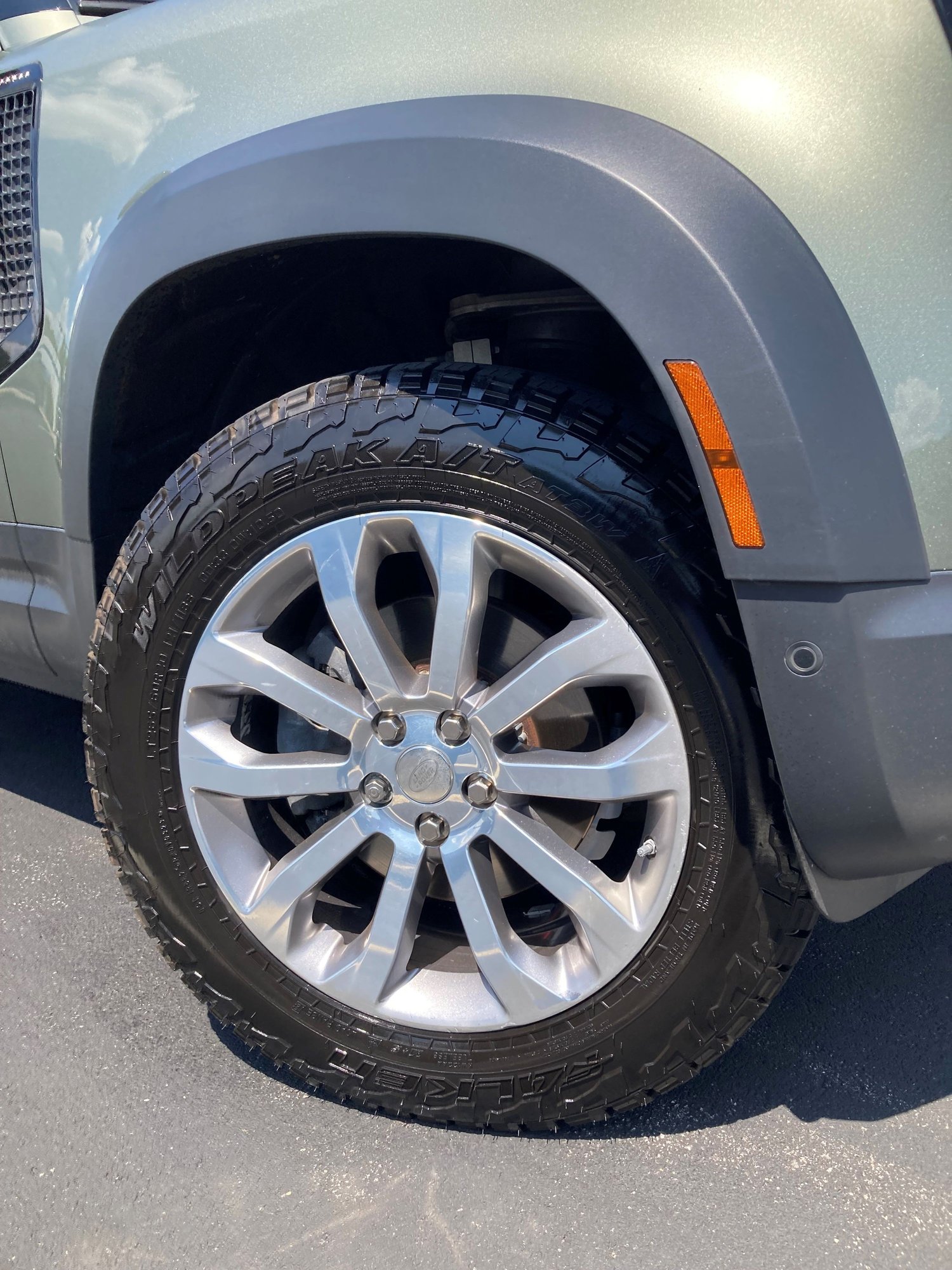

255/60R20 is a JLR-specific size. I have yet to find another vehicle that runs this size. Pirellis suck. They only make good semi-slick track tires and that's about it.
I originally ordered my Defender with 19" wheels & Goodyear Wrangler Adventures, but swapped them for a set of 20" wheels from an LR4 because of the lack of tire choices. These wheels have a different offset to the 20" OEM Defender wheels, but they fit just fine. I ended up going for the Falken Wildpeak AT3W sized LT265/60R20. These tires have since been discontinued and replaced with the AT4W. They are relatively quiet on the street and the off-road performance is exceptional. They are also 3PMS rated and were great in the snow last winter.
