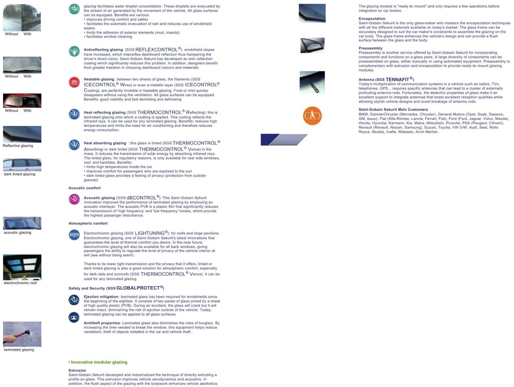

I found this website with the logos... but no explanation of the missing "coating" or changes to their solar attenuation (or thermal comfort) products...

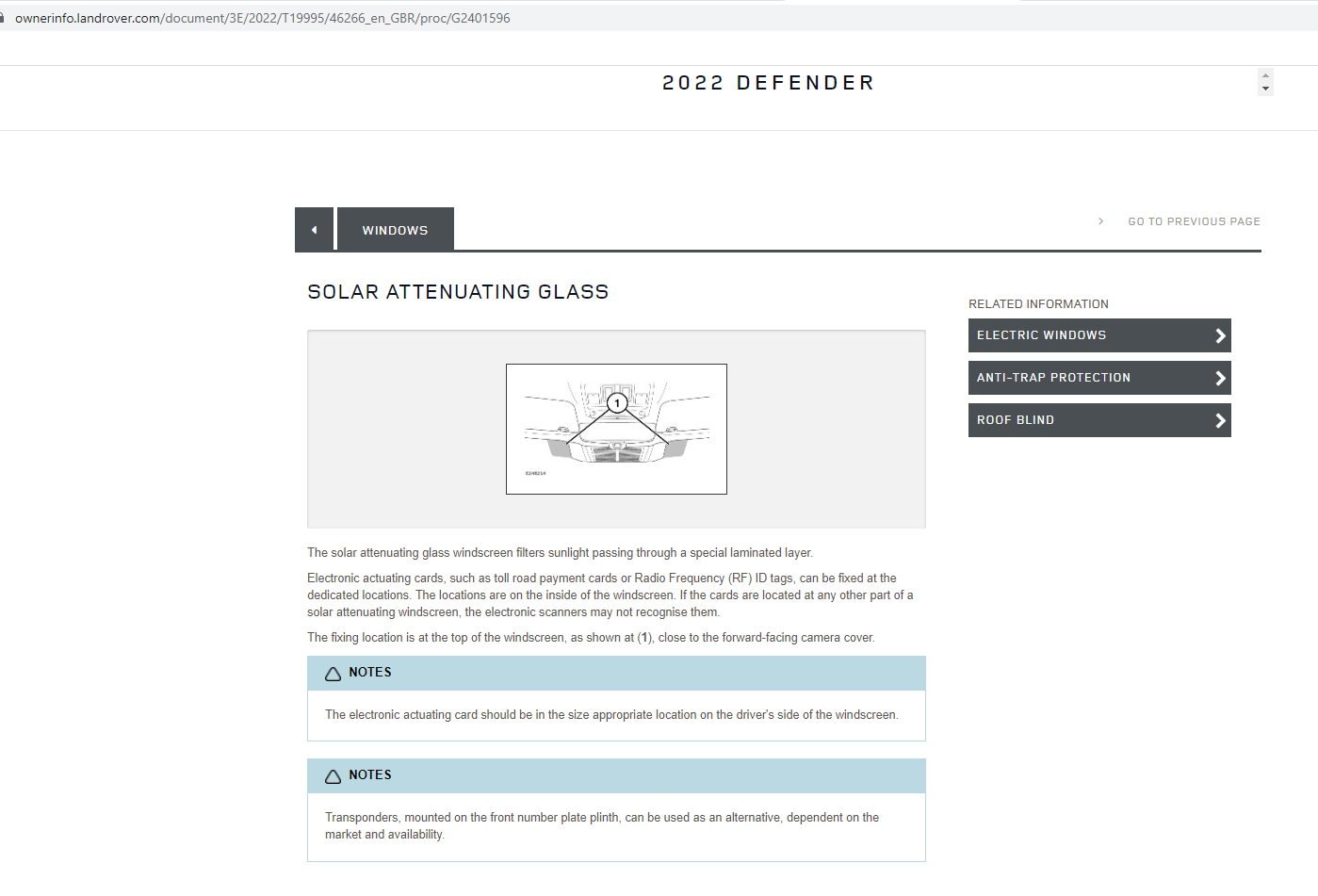

And per the 2022 online manual, my replacement windshield definitely DOES NOT have this "special laminated layer" (or at least its no longer visible, lol).

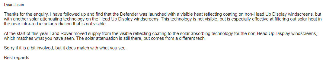

For anyone interested, I received the following reply from NRG which owns Pilkington, not sure how I feel about it but it seems to line up with the information I got from the dealership:

This means that it is a new technique and the purple colour is no longer visible, but the UV protection is still available?
So everyone with the a normal windshield wouldn't have the thermometer logo?
Hmm…..

If that's true, I would feel wonderful about it. It sounds to me that they upgraded you from the coating (which is visible) to some sort of manufactured glass with the infra red filtering already in it. If it still works, but a better tech - why worry. I'm pretty sure I've never seen a scale on how effectively a window filters out infra-red / solar radiation. If there is a beast and you get real lucky, perhaps there are specs between the two glass types. If not, I'd just move on. Pretty confident that if this is a v2 of the product you'll be good.

Ok. I'm pretty nerdy. I LOVE reading wikipedia and immersing myself in things I don't understand. I geeked out and had to find this. Hopefully it helps someone else who wonder's wtf those hieroglyphics mean.
