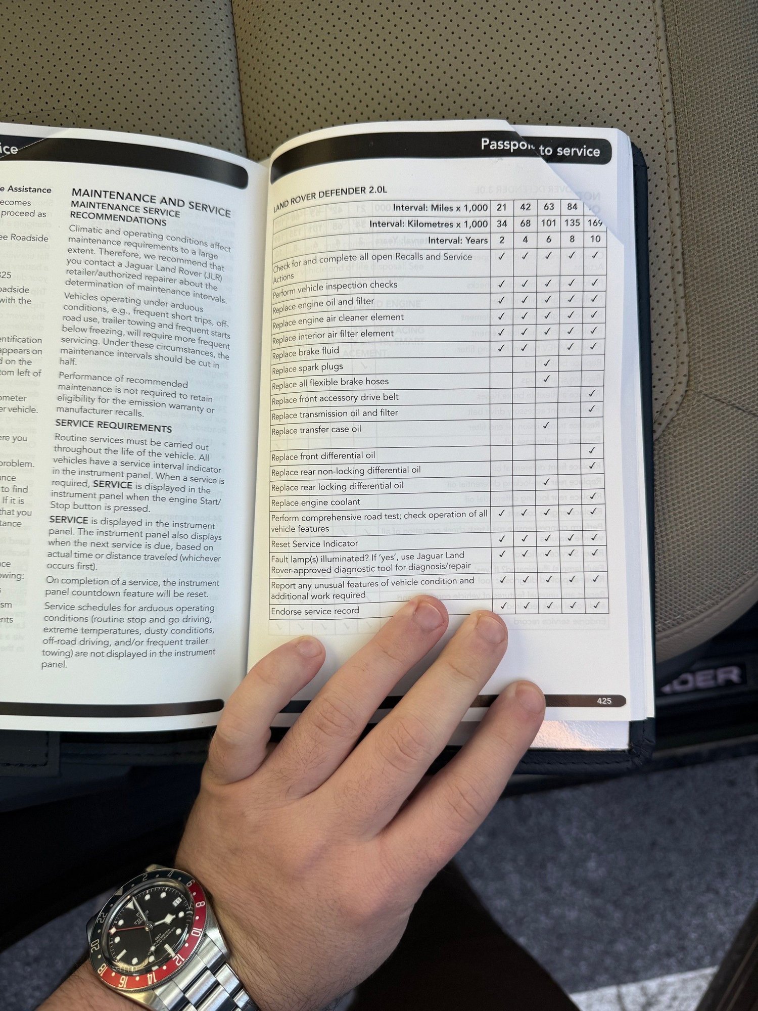

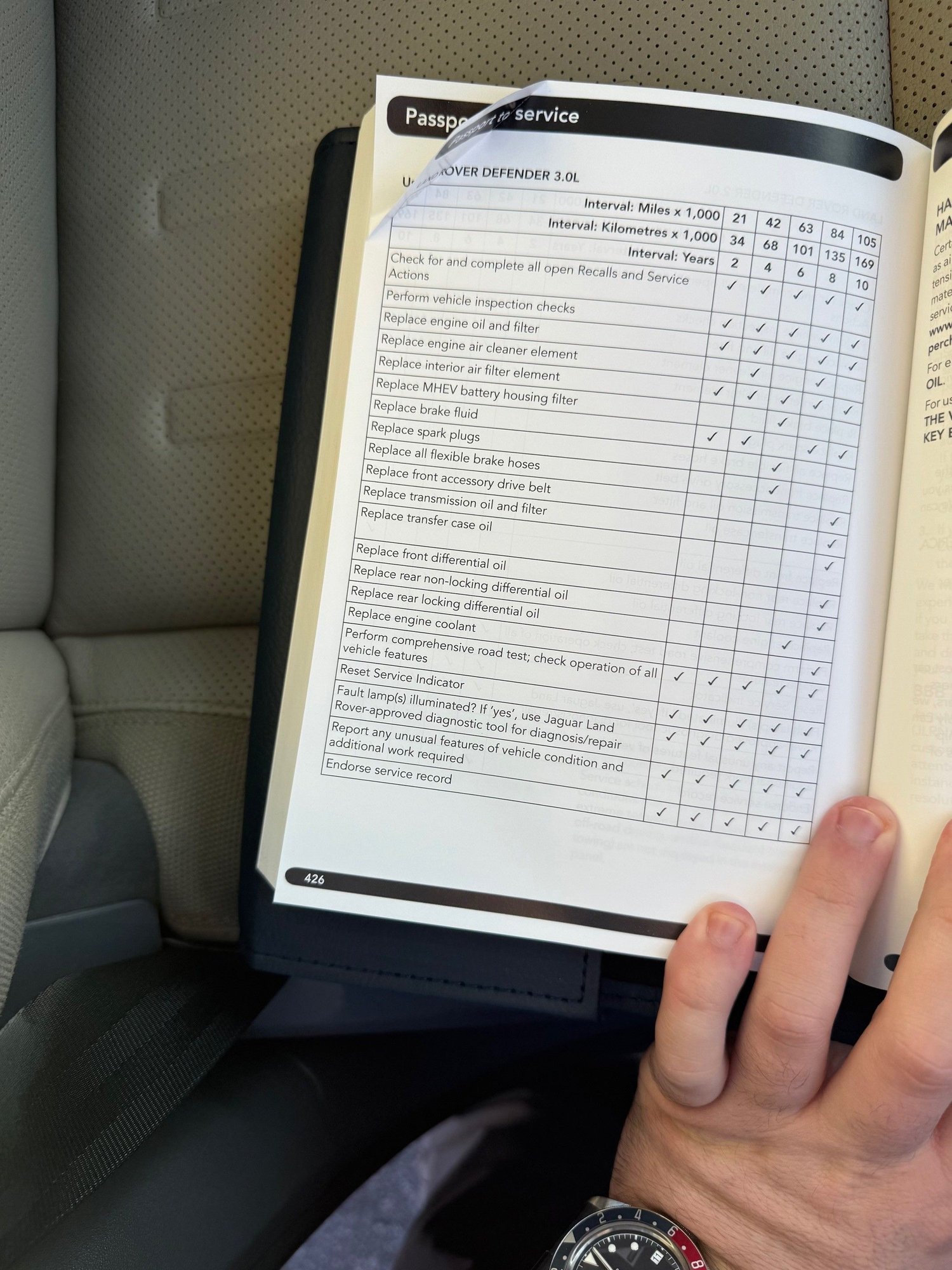

Unless they changed the intervals, this is what JLR recommends per the manual. 63k for the transfer case. JLR always said the transmission is filled for life, but I never noticed that they recommend a change in the manual until today. My old Land Rovers never had the trans fluid in the passport to service.

Thanks @CincyRovers and @GavinC . I had checked my manual, but couldn't remember the folk wisdom on the rear diff. I think I will go ahead and get it done at 50K and hold off on t-case and tranny until the 60K service. Thank you again guys.
PS, nice Tudor GMT Cincy!

You're welcome! I'd definitely do the rear diff first.
And thanks - it's been a fantastic watch. I always take it on my travels. I need to get it serviced, but I think I'll wait until I get back from my trip to Ireland in May. It's held up incredibly well to more abuse than it deserves.

@CincyRovers
Yes. I could remember all the timings. You’re absolutely correct
interestingly the schedule for the serpentine and fan belts was at 63 and 84k miles respectively has now been bumped to the 105 mark
These service items are so simple to do that it makes sense to be proactive on them. Especially the diva like rear ediff. I’m doing it again soon.
the only service item I’ve not done is replacing the flexible brake lines at 63k. That just seems overkill. Maybe at the 6yr mark. They look fine. Never heard of consumable brake lines before.
All this proactive servicing I like to do may be for naught if the spate of DC/DC software induced failures hits. Really worrying to see what’s happening since the wonderful software update hit.
Literally zero mention of this failure till the recent update. Now it’s everywhere.
Apparently it requires a software meld to the vehicle’s it doesn’t sound like it’s doable by the home grease monkey.

I've literally never seen any car that requires brake lines to be replaced routinely. Usually you just replace them when they need to be replaced.
