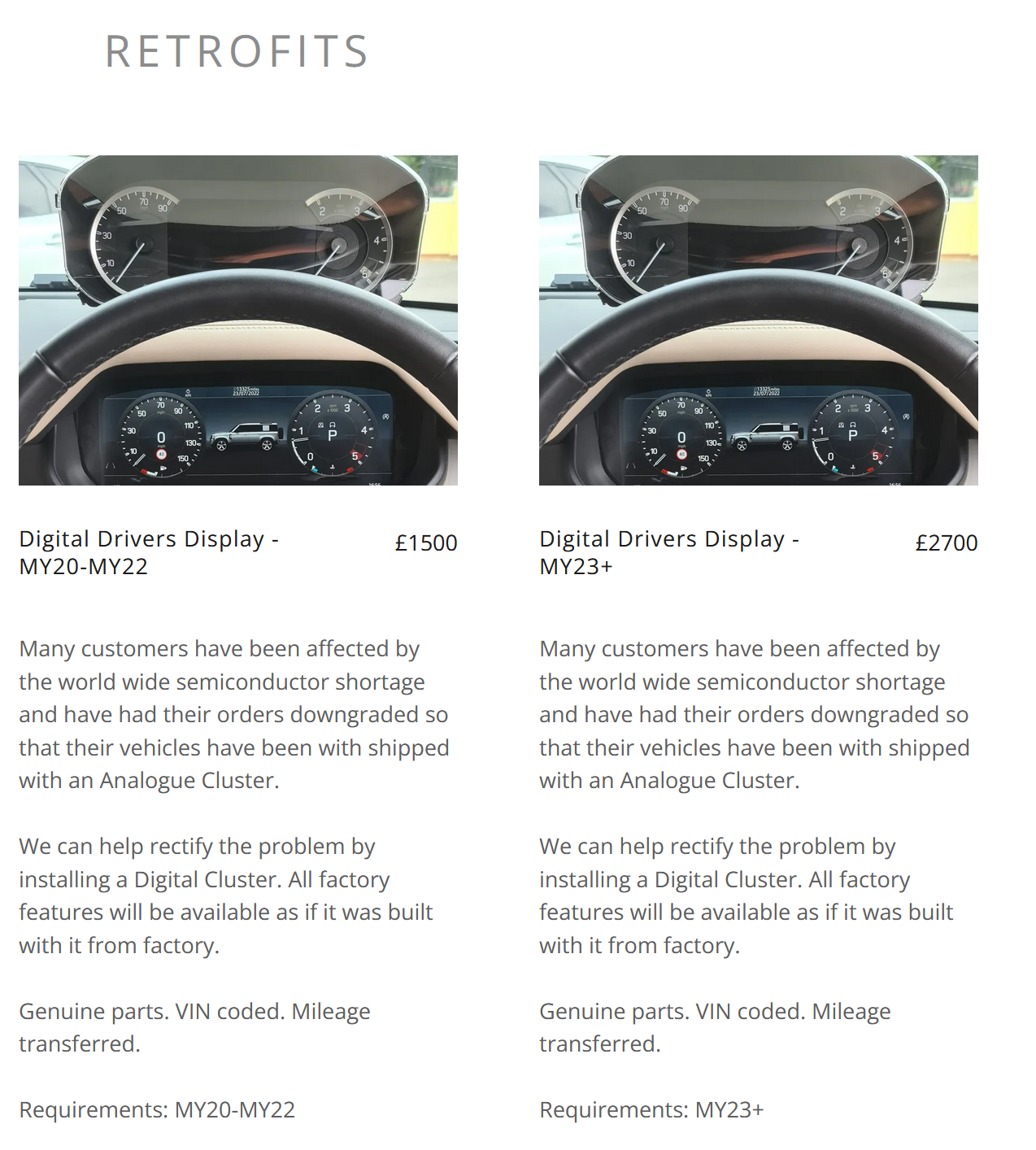

FELLAS:
The interactive display is a simple plug and play and you can buy them used on ebay. The interactive display is the same unit that goes in the sports fullsize l405 and discoveries.
Can you confirm if this is the case of MY23+ as well? I've asked my dealer about retro fitting the screen and he said it's not possible due to warranty issues. I'm not buying it as I'm seeing shops in the UK doing the job. The only vendor on the east coast is Sarek, but he's in VA so that's quite a hike for me from FL. I did reach out to him and he confirmed that it should be possible, but they haven't done that particular retrofit yet.
Dealer would not touch that job, but the right shop definitely would. See no reason why it would not be plug, flash and play.
The only shop I'm aware of on the East Coast is Sarek, but that's a bit of a hike for me from FL. Might still consider if he turns out to be the best option. I reached out to Miami British, but they haven't responded.
Was asking about MY because I noticed a fairly large price difference on the UK LR Retrofits website, so something must have changed:
Old Feb 22, 2023 | 10:11 AM
  #95
mrego's Avatar
Joined: Nov 2022
Posts: 327
Likes: 215
That's crazy...almost double the price.

From: St Louis, MO
There must be a big change in 23 - the stateside Manhart dealer cannot update the 23's locally.
Interesting. I reached out to Precision Sport Industries in Orlando to see if they can help but haven't heard back. They are also a Manhart dealer.
Hopefully some of the vendors here can chime on on 23 challenges.
update what specifically? I’ve just had a bunch of updates done to my truck this week. Mines a MY23

Originally Posted by markjlr
FELLAS:
Any idea on whether coding will be needed to put in the "new" cluster? It's pulled from an L494. Am wondering whether the vehicle graphics will need to be changed and if there would be issues if the my car's mileage is lower than that of the "new" cluster from the donor car.
