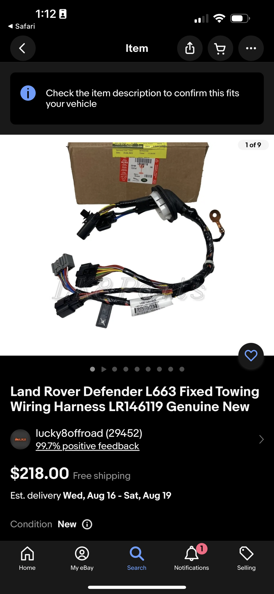

I would take a whole wiring harness but that’s not even an option from LR! Crazy. I’ll look for that on eBay as well.
here is a picture of a wiring harness for sale but WITHOUT the socket of course. If this image is correct (who knows, could be a different section), then why can’t the damn socket be sold separate?

Unfortunately it is very specific piece. Yes it is a standard US seven pin, but they molded it into the mounting piece and then sealed he wires into it with some type silicon. On top of that the 4pin is directly molded to it too.
