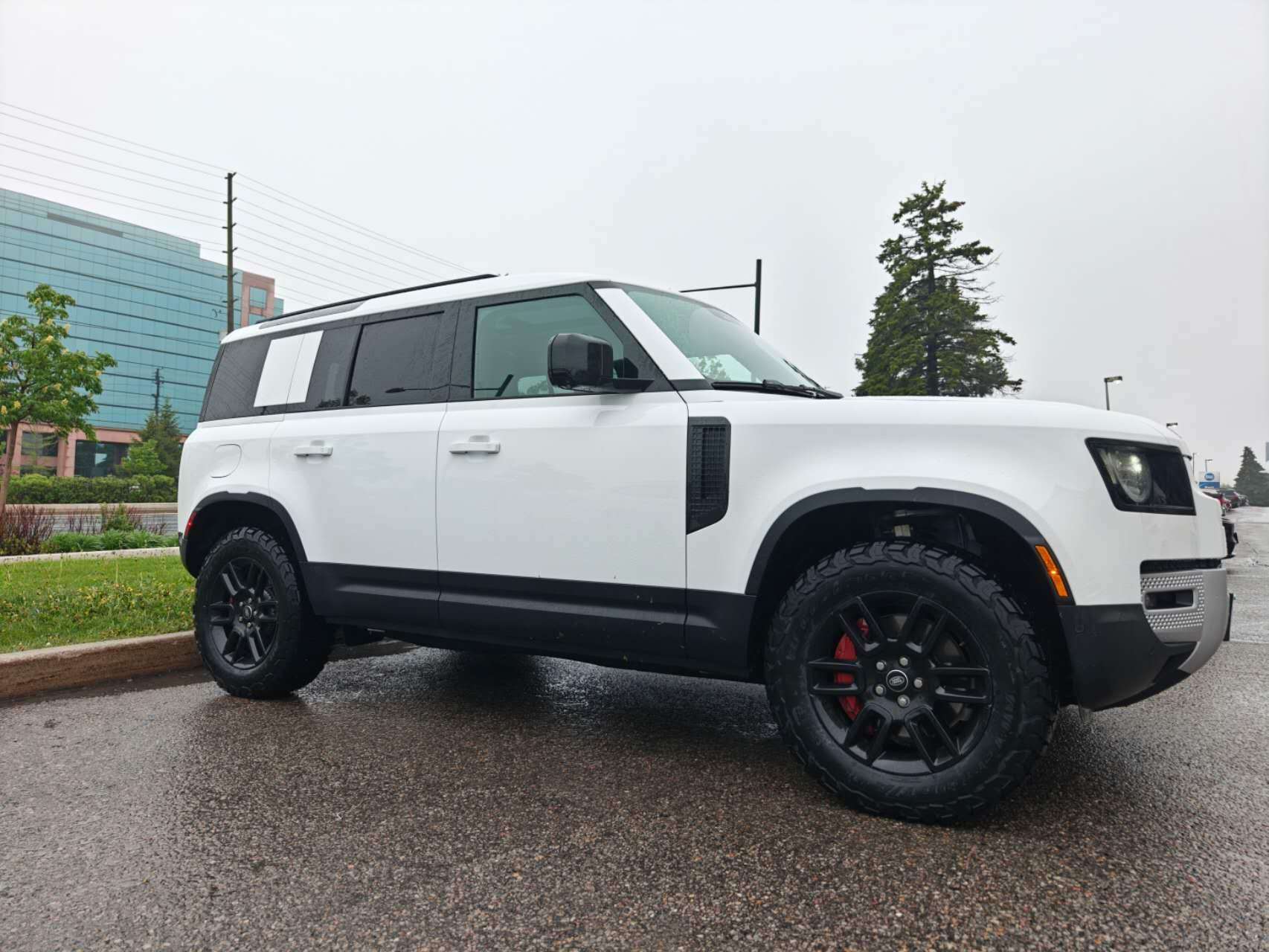

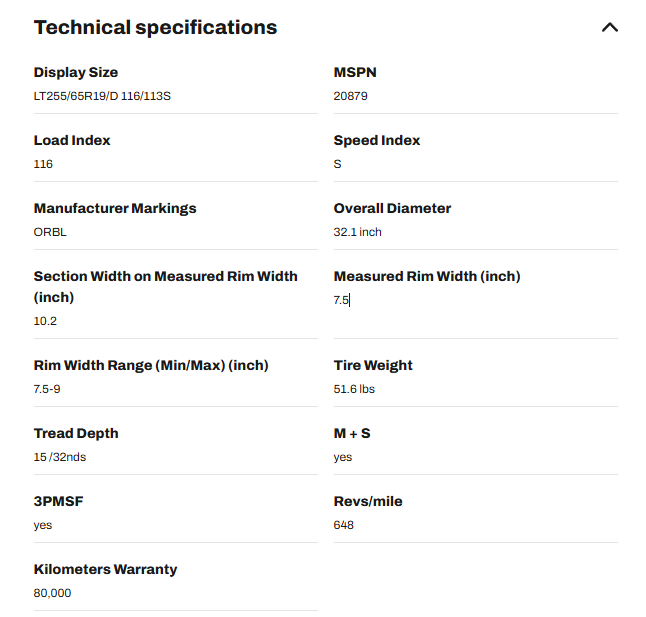

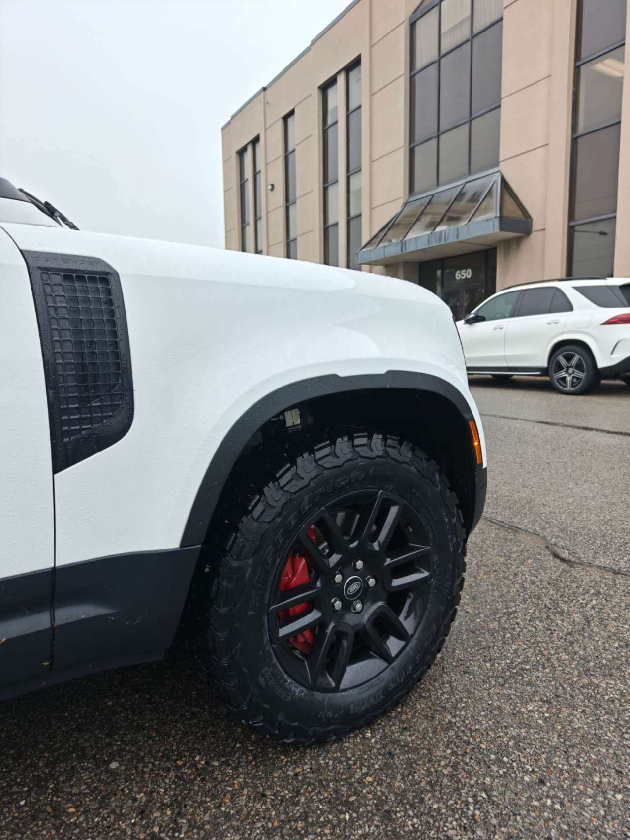

Default 255 R19 65 KO3. 6years later, the perfect tire for this car finally appeared
Fits the original 19-inch wheels and 65mm tire sidewall thickness. No side effects, no need for friction or rear brake replacement. Everything is perfect.Tire Weight only 51.6 lbs, 275/55R20 all above 58 lbs ,275/70/R18 is 58.25 lb,so this size almost the best weight of u can pick .
With distribution starting in North America, other countries should be able to purchase it soon.

Originally Posted by aki1983
...and 65mm tire sidewall thickness. ....
The sidewall is a little thicker than KO2 apparently. Nice and chunky. Somewhere between 10 and 15mm would be reasonable estimate. Not 65mm.
(65 is the aspect ratio. Sidewall height is 65% of tread width. ie 0.65x255mm )
