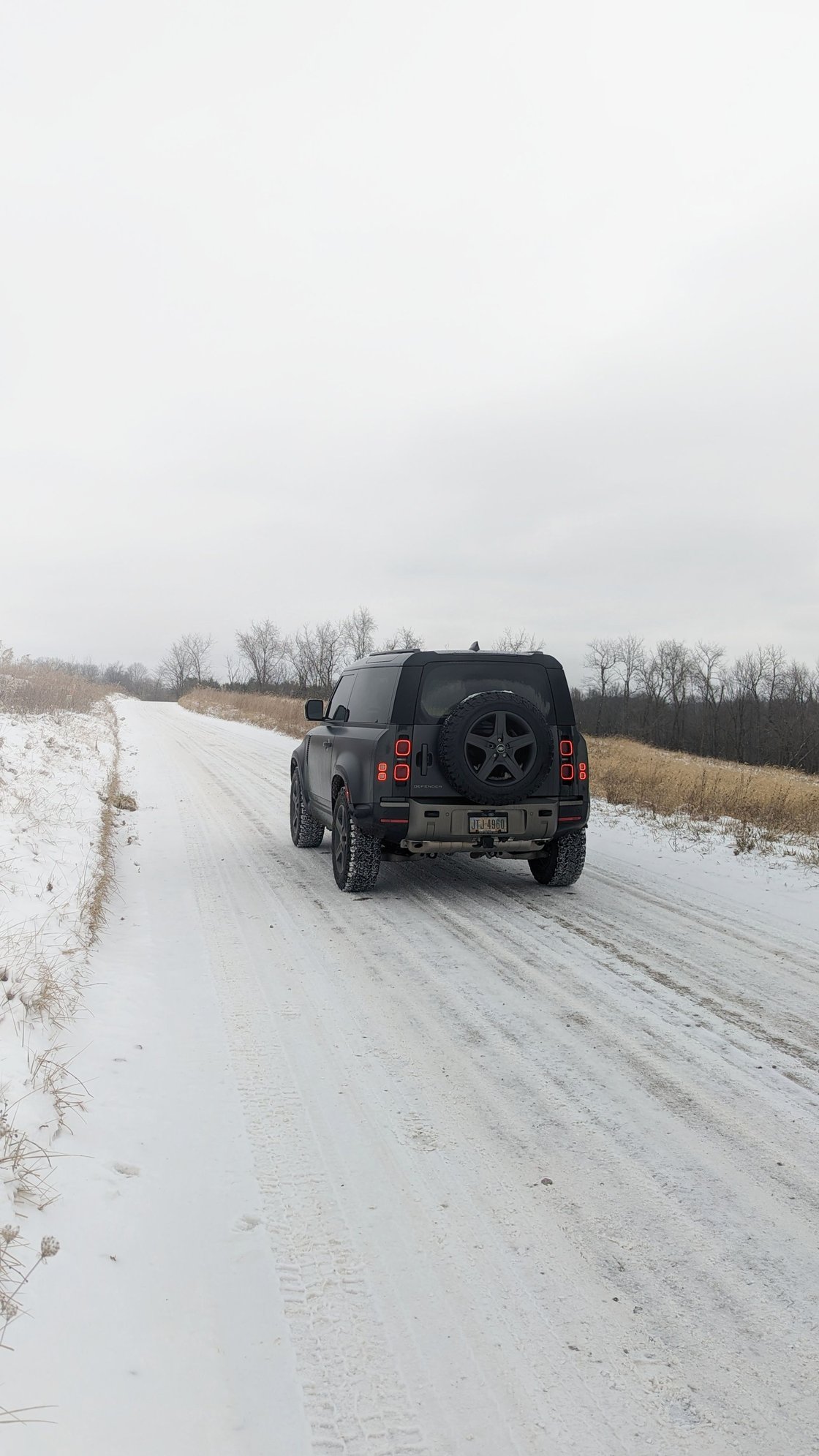

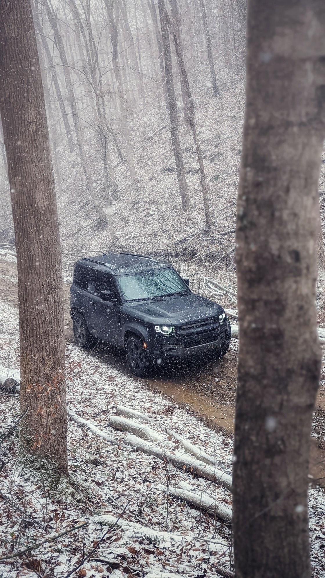

I think I was the first to fit BFG KO2's in 275/60R20 to a completely otherwise stock Defender, and subsequently leave them on because they don't rub (or if they do, I cannot tell at all). The caveat is that I have a coil-sprung vehicle, not the air-bagged suspension. I don't have to work around the access height clearances.
Here are my observations, having off-roaded my D90 pretty extensively:
- I have off roaded my D90 in Ohio, Kentucky, Oklahoma, Arizona, New Mexico, Utah, and the sand hills of Halsey State Forest in Nebraska.
- I have never aired down once, even when I was running the stock Wrangler Adventure AT's in 255/60R20. Those gave me an uneasy feeling on sharper rocks, for obvious reasons.
- The 33" diameter of the 275/60's makes a massive difference on mild obstacles. The added tire width is not noticeable off road to me.
- The stronger sidewalls on the BFG products are noticeable and add peace of mind when off road.
- I did collect a Phillips-head screw in one of my KO2's after a few weeks, and had a very slow leak. At first I chalked up the low pressure to cold temps (its was -8° here that day I noticed it), so I refilled the tire from 17 psi back up to near 50. I was surprised at how the tire looked at only 17 psi. I would have guessed it to be closer to 30 psi visually, not 17. Stronger sidewalls, I guess.
- The KO2's are incredible tires off road and in the snow in particular. I was sort of one of those that tried other AT tires on other vehicles because I knew so many people that had KO2's on Wranglers, Raptors, etc., and they were boring and a known commodity for me.
- You must understand that Nitto does such an incredible marketing and PR job giving free tires to influencer-types, Falken does the same. Milestar does the same with Matt's Off Road recovery.
- For me, Falken Wildpeak AT3W's are the only tires close to matching the KO2's performance off and on-road. They're really great too.
- I have taken my 275 KO2's both up and down some very steep gravel, loose dirt and rocky roads here in Ohio. The hill descent control is amazing with the Defender on KO2's, and those tires just grip and move the car uphill in snow, almost no matter what. Really impressive, and others here have noted the same. I'm sure there's a limit, but I'm not stupid enough to have found that limit yet.

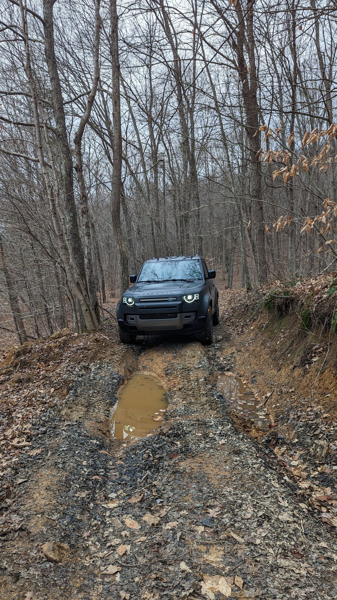

I can chime in. Stock 20" wheels with a 1.5" rod lift on 275-60-20 BFG KO2 tires, ie 33" tires here. I've started airing down to 20-22 PSI on all 4.
Here's the logic:
I will be testing the mud / rocks capability of these tires this spring/summer... my plan is to do the same run, not aired down, aired down to 30, then aired down to 20 and see how it feels and if the tires survive. I intend to give them a good throttling.
Moral of the story:
Again, nothing above is fact. Just my "theories" based on recent experience.
Here's the logic:
- I run these KO2's 40 to 42 PSI normally on road on light load setting. Which btw is much more comfortable than running them at 50 on road or off road. 50 is simply too harsh.
- First snow trail run I didn't air down ... Then I stopped, aired down to 32 or so, much better. This felt overly conservative so made a note to air down further on my next run. Again this was all snow trails, minimal rocks etc.
- Next run, aired down to 25 or 26. On same snow. Fine, no issues. Bit better. Wondering if I can go further.
- Then I went to a winching/recovery/rigging skills course w/ an offroad guru in Bend OR, and he said... when you have modern vehicle/larger wheels with high pressure recommendations (like our Defenders), his experience and reco is that you should start by airing down to 50% of your onroad pressure. IDK, makes sense? Then see how it goes, and if you want to experiment lower, go for it just beware you may be at risk for de-beading etc etc. So this means for me... if I run the tires normally at a min of 40 PSI onroad, then around 20 PSI is my "air down" sweet spot.
- My last run I aired down to 20/21 PSI because snow conditions were gnarly. I noticed improvement over earlier runs, but snow was a bit different so it's hard to say. My compadre running 35's on aftermarket wheels was way down on PSI (like 10 or 12?) and had far less trouble than I did getting traction. But he had much bigger tires. Aired down far further.
Moral of the story:
- Putting 35's with smaller wheels definitely is the way to go. Having gone on a ride with someone who did this (body lift, etc) . it's night and day from my truck.
- But that's a domino affect of component changes on the vehicle I don't want to get into, so finding the sweet spot of using the 20's aired down to the "sweet spot" (which I believe is 20 PSI)... is perhaps best.

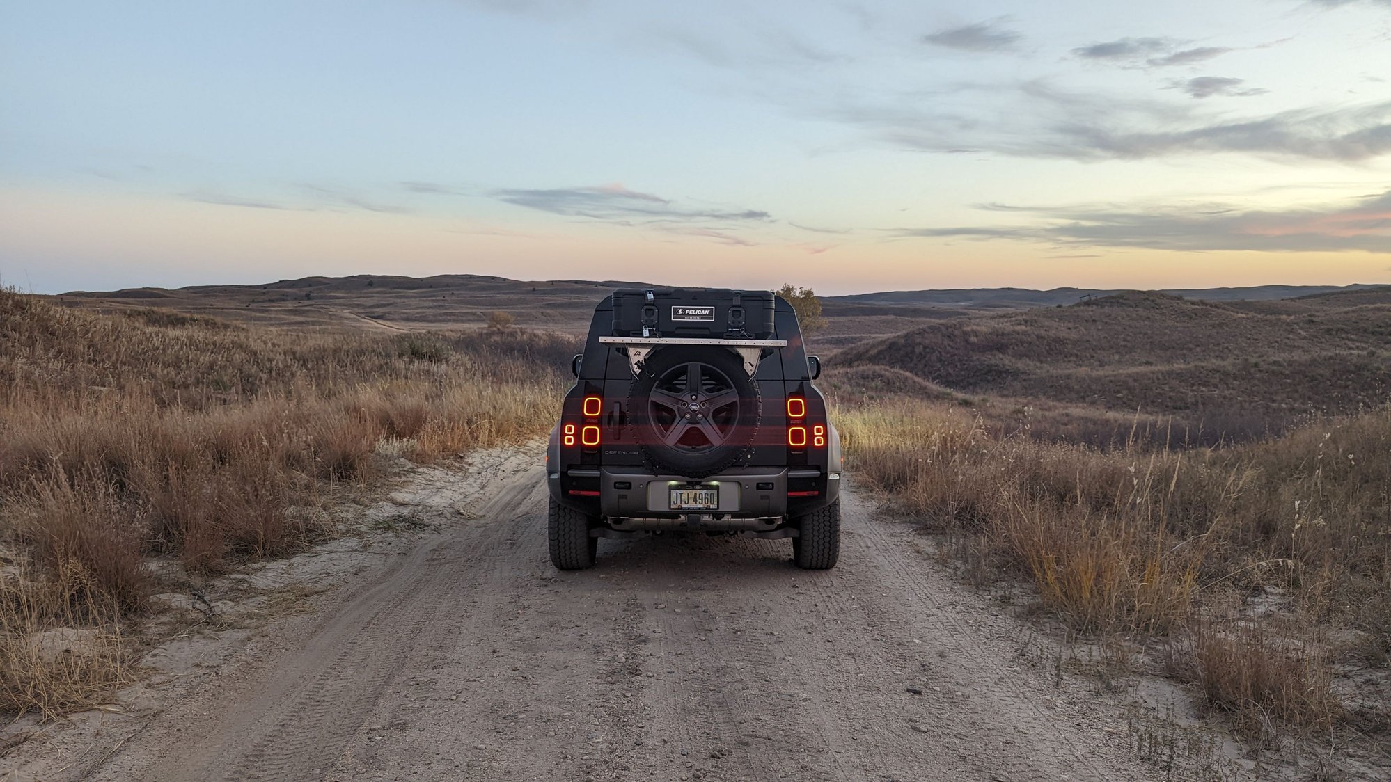

Ok, here is my experience after two days running trails near or at Capitol Reef NP in Utah. I run the same set up as nashvegas. P400 275/60/20 KO2s with 1,5 lift rods.
- I hit the highways from Texas to Utah with roughly 45 psi all around. Super smooth on the highways and got an average of 19mpg, doing 75mph or 80mph in some sections and 65mph/70mph in others.
- The trails I faced were a mix of very light rock crawling with sand and gravel roads with tons of washboard sections. Some had sharp rocks around - which gave me a bit of anxiety. I did one river crossing section.
- At the first trailhead I aired down to 35 psi all around. I was not brave enough to go below this, due to some sharp rocks around. The beginning of this trail was paved and immediately after airing down and running on pavement I noticed a great improvement in comfort. Much less harsh ride, but I suspect that would translate to worse mpgs than 45psi.
- I ran these trails for pretty much 180 miles combined the two days. Not once I touched again the tires to air down. I have to say the air suspension does an amazing job of filtering the washboard corrugations. I can't imagine running 35 psi on these trails in my old 4runner trd pro and being as comfort as we were in the Defender.
- On the light rock crawl sections, I used rock crawl mode and the suspension went to off-road height. That was considerably more harsh than normal height. The added height significantly impacts the suspension travel and you feel every bump and drop in a very harsh manner. Maybe because I have the lift rods, the harshness was a bit increased. I am not sure. What I am sure is that I had zero fear of touching the bottom of the car. There is soooo much clearance on this thing.
- Used wade mode in one river crossing. It was a breeze for the Defender, water was about middle of the wheels.
- The much added benefit of airing down to only 35psi was that in the end of the first day I did not have to stop to air up. Rode on the highway back to our hotel with 35 psi with nooo problem. Even did a couple sections at 70 to 75mph - zero issues. It was just my wife and I in the car, so light load settings was just fine.
- I did not touch my air compressor during the whole trip. When we started our journey back to Texas, I just used the gas station air gun to air back up to 45psi all around.
