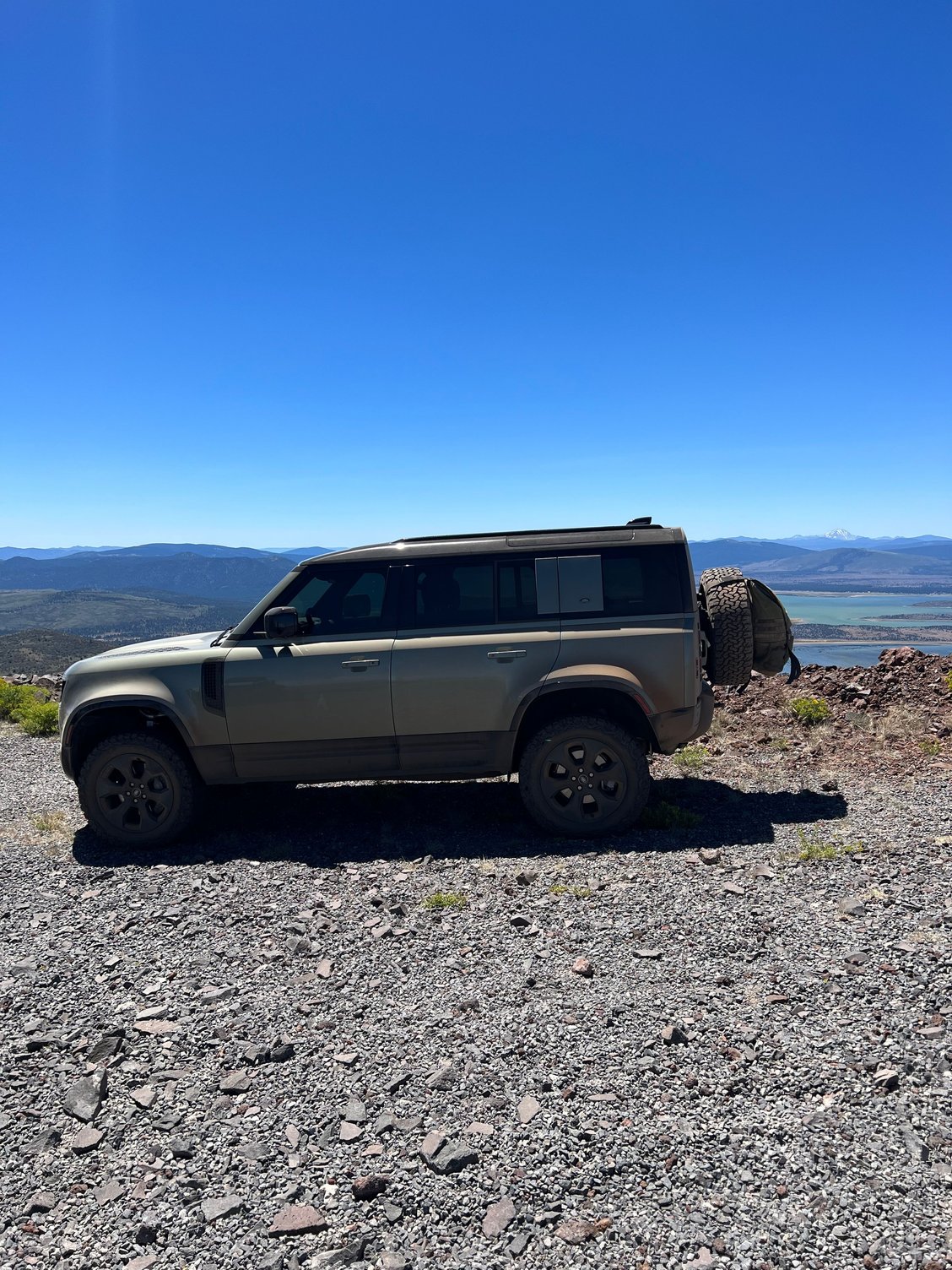

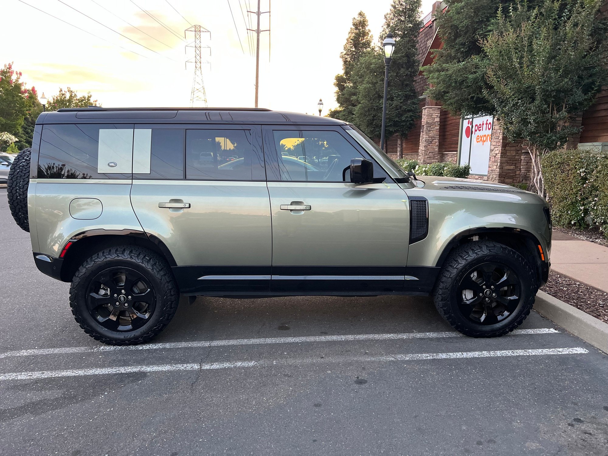

I’ve run a couple trails now with 275/60/20 K02 D load rating and a 1inch proud rhino rods. I run them at around 37 for every day use. Still see about 19mpg average at that set up. On the trail I’ve aired them down to about 25 with a combination of sharp rock trails to sand and off camber sections. Drive beautifully. The suspension handles rock and washboard with ease. Super smooth even in offroad 2 height it’s not bad compared to other air suspensions I’ve owned. Only rubbing I get with the wheels is at full lock when in access mode just barely in the lower front part of the fender liners.
