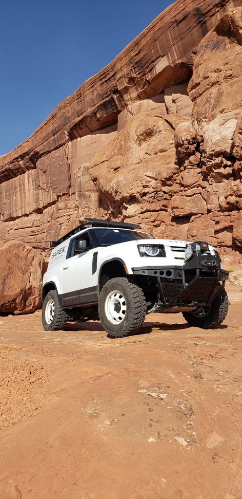

Default Coils FTW!
I will be the lone wolf on this one. I prefer coil sprung for on road and off road. Air has it's benefits. Mainly access mode and load leveling, but for durability, simplicity, and peace of mind, coils win! JLR did an amazing job with spring rates and design also. I have 16k miles on my coiler and dont miss air suspension at all (previously had an l322 on 35s with air). I tow a 19ft airstream cross country. I daily drive it. I use it heavily off road. Bowler uses a p300 d90 coil sprung for their builds (i can leave the d90 and p300 being superior for another post&#128513 . Not saying that I would.kick a p400 d110 on air suspension out of bed or anything. It is still an amazing vehicle on and off road. Just my 2c
