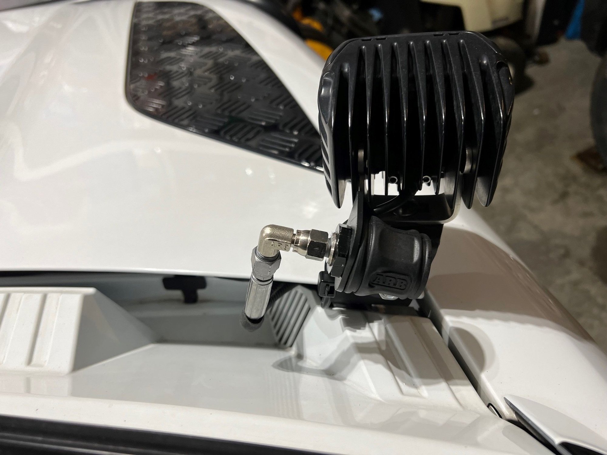

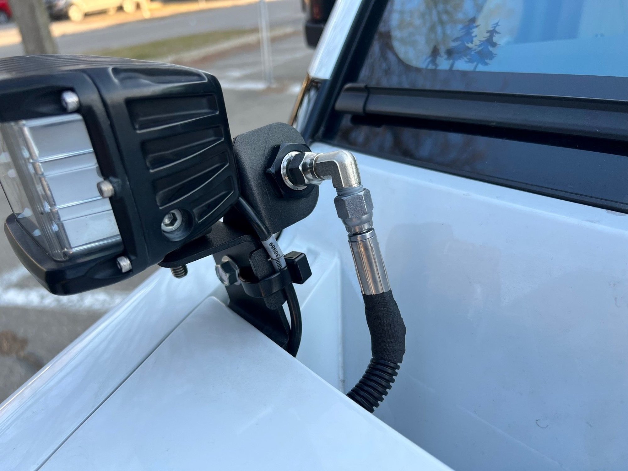

Finished up the install of an ARB Dual Compressor with an external air coupling (sorry for the typo in the thread title...ugh).
It is wired to the Switch-Pros SP9100 switch panel. Also, I added a ground bus bar to the Switch-Pros under hood bracket for future accessory installations.
I used the ARB Remote Hose Coupling Kit attached to a Jeep bracket (had to drill out the hole to match the quick connect coupling) to the ditch light bracket using a 1.5 meter ARB stainless braded reinforced hose connected the the ARB quick connect coupling from the ARB remote hose coupling kit.

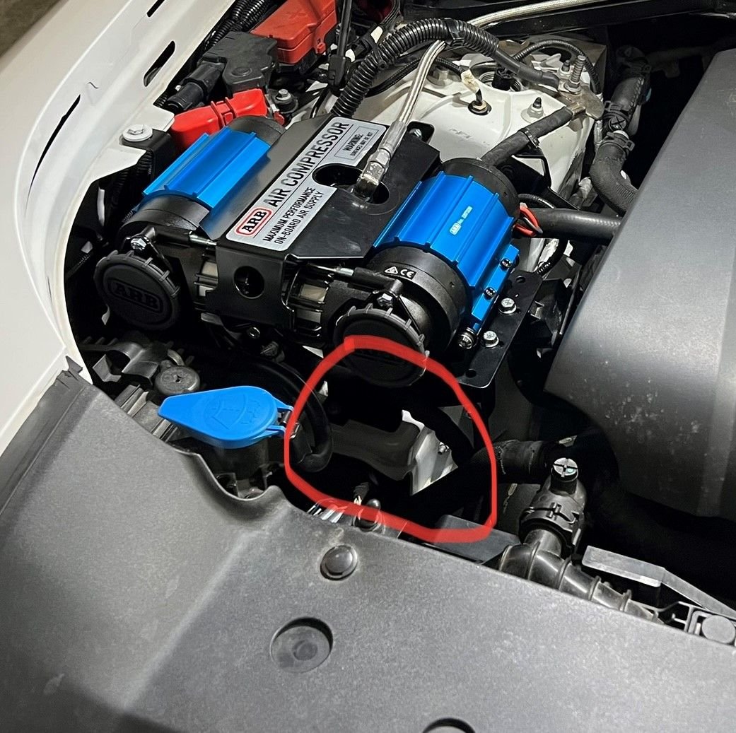

Awesome work, @GCSchmidt !! One quick question for you. I have a big-arsed shut off for my winch below where your compressor was mounted. Being a bit on the lazy side, I really don't want to move it. Is there room under the compressor to reach in if you needed to? It looks like it sits high and aft of the washer fluid. I'm figuring I may just have to buy the Saltek bracket to be sure, but I'd prefer knowing if I have to move the switch before the investment.

Tons of room under the compressor, you should be able to reach under it, see picture below (I have huge hands and I can reach under it...I'm 6'8" 240lbs). I am planning on mounting the ARB 4L air tank under there...eventually. I do have the P300, should be the same for the P400.
