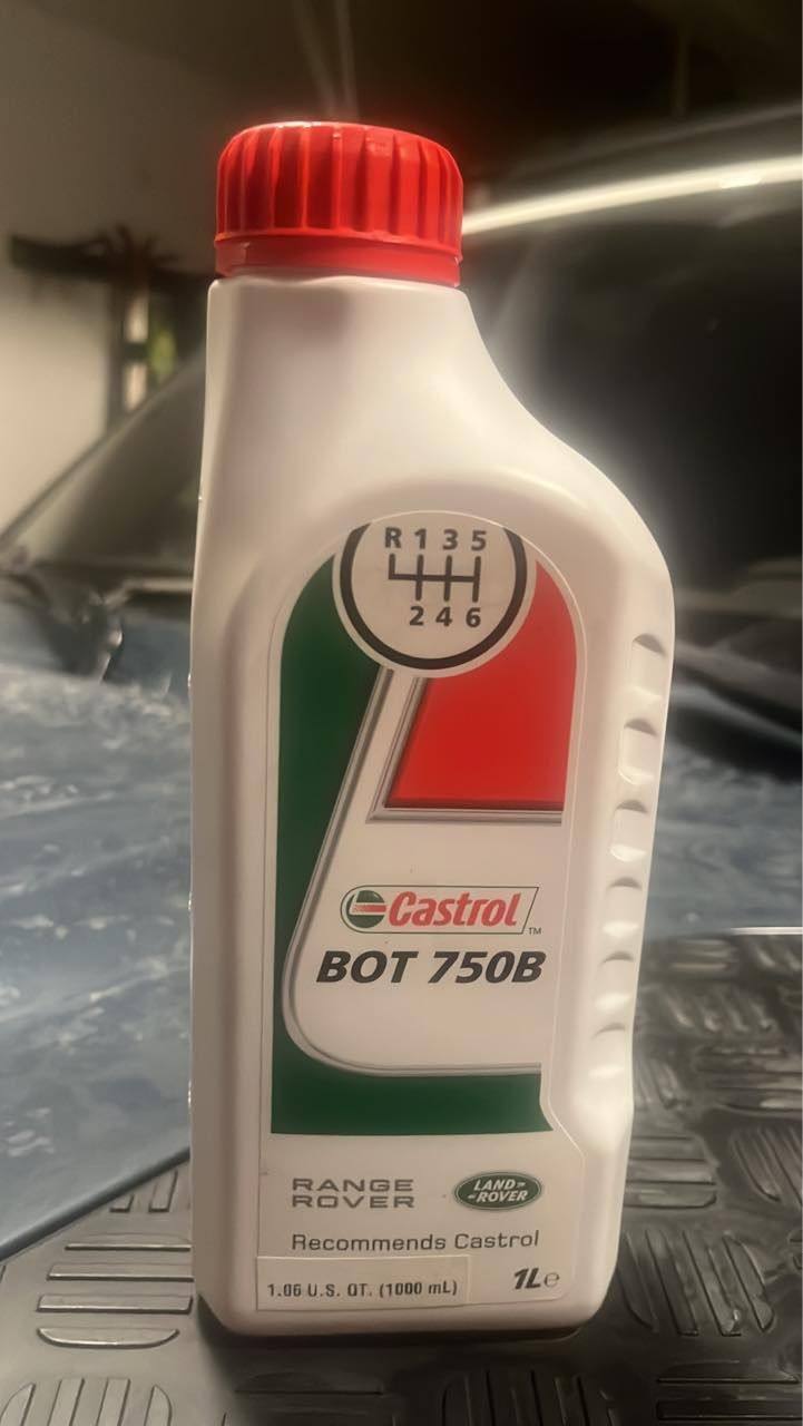

Yes. I would do a fluid change first off.
Front diff service interval is 105k miles but given the cost of these big bits of hardware I've taken a more proactive approach.
Oil looked like caramel in the front diff, and was blacker than a Spinal Tap album cover on the rear. I'm doing it again soon.
Low cost simple DIY that might save you a few thousand. I am by default, suspicious of a dealer's diagnostic skillset. I have been singularly unimpressed by LR at my local dealership's service dept.
Front Diff fluid
Front Diff fluid
Front Diff. Simple drain and fill.
"Smell the glove" on the rear
