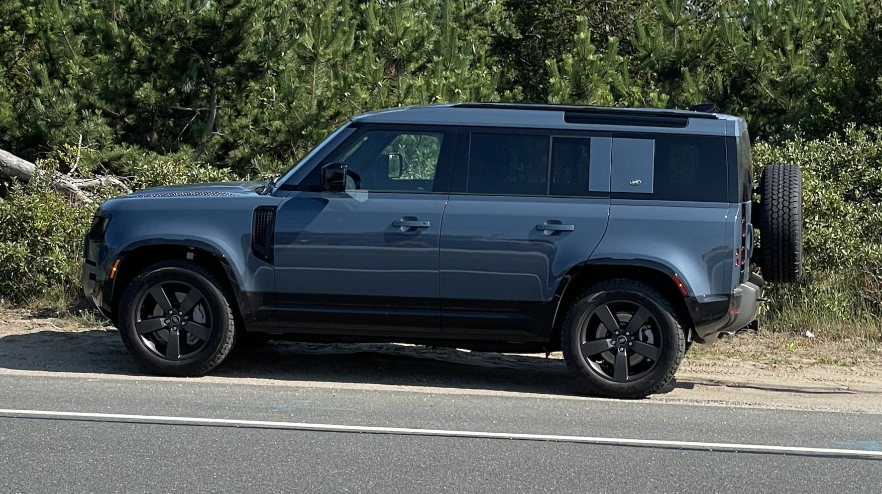

Do those of you with the rear diff have a bit of a bump under the car?
My new 2022 with rear diff has a bit of a bump in front of the rear wheels in the undercarriage. Is this normal? You can see it in this photo.

That bump on each side of the vehicle ahead of the rear wheels are the fuel tanks.
There is no armor yet available for the fuel tanks.
The rear diff is farther aft and is higher up.

Thank you for the clarification!
