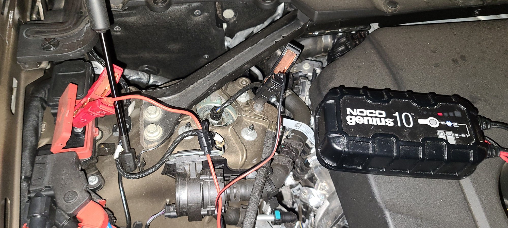

How did you connect the trickle charger?

I connected it as the instruction say. The negative to a post near the positive. Tried moving the negative to another location just to check.

Just to confirm, here is the charging situation. This is how it is been since the start, yesterday afternoon about 5.
